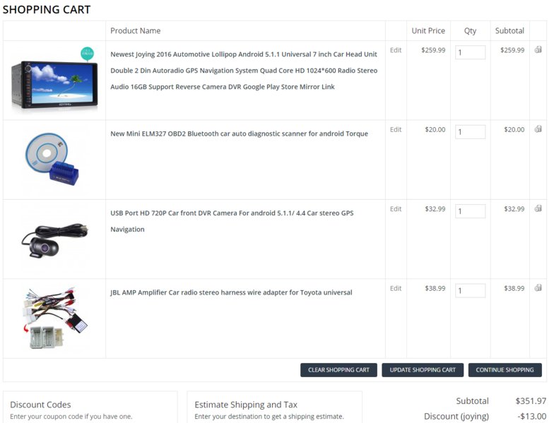

    Well, just ordered my setup off the CarJoying site. Found a 5% coupon ("carjoying") too. So I almost got a free bluetooth obdii device out of it. lol
    I ordered a faceplate off Amazon 'cause I didn't like the flat black one they recommended.

    I just noticed your order list, and you paid more than three times too much for the elm327. They're worth about $6.00.
    https://www.amazon.com/Version-Bluetooth-Multi-Language-12Kinds-Android/dp/B00N2K6M2A

    I set up data access for the head unit via my home wifi (works while in my driveway), and a portable hotspot running on my phone (its built into Android, couldn't say about apple, but my guess is not). Google maps nav is EXCELLENT on the head unit. Plenty of horsepower to handle it too. I intend to get a license for Alk Copilot for those times I leave cell data coverage, but it does come also with iGo (pirated), which I've never been particularly impressed by.
    Phone calls... this is where I had trouble. But it was my fault because I tried to take a shortcut and plugged in the kenwood microphone to it. So I could hear my wife, but she couldn't hear me. The little microphone on the top/left of the head unit's face appears to either not be used at all for calls, or it may be switched off when the external microphone is plugged in.
    GPS... works well. I didn't do anything fancy with the magnetic gps antenna, just stuck it onto the top of the head unit, which is a steel box. It seems to pick up satellites just fine like that.
    AMFM radio... Reception seems very good. Now I gave it a particularly excruciating test, because my antenna is messed up pretty badly and I was losing reception dramatically with the kenwood. I have a new antenna on order, but it hasn't arrived yet. The AM radio station I perpetually keep it tuned to faded out in the same places as it did with the kenwood, but it seemed to hold onto the station a little longer. It should be just wonderful when I get the new antenna installed.
    Odd behaviors... nothing that I haven't already experienced. When you turn on the key to accessory position, it powers up the radio, then you start the engine, so it powers off the radio, then return it to run/accessory position and the radio powers back up. I may have to rig up a timer or a "poor man's timer" (diode+capacitor) to keep the accessory line held high during engine startup.
    The unit has a delayed power down mode, but it doesn't have an impact on this. Basically, the unit has THREE power states; ON, STANDBY, and OFF. The delayed power down mode controls when it switches from STANDBY to OFF. But it can still go from ON to STANDBY instantly when the key is turned off. It even notifies you on the screen that it is powering off. Well sortof powering off. So the use of this is if you want to keep the thing mostly on when you fill your gas. So pick something like 5-10 minutes delayed off, then when you get back in with a full tank, it starts back up instantly. But leave it overnight, and it does a full bootup.
    So, my first impressions:
    This is one of the most well thought out and well put together pieces of budget chinese electronic hardware that I've EVER had the PLEASURE of trying out. In fact, it is the ONLY budget chinese electronic hardware that I've tried out that has actually BEEN a pleasure. It is in a completely different and vastly superior league to the junk kenwood that it replaces. Installation was straightforward, and I am particularly happy with how the external steering wheel converter box is not required. I think I paid something like $50 for that thing, and it relayed the signal in a frustratingly slow way.
