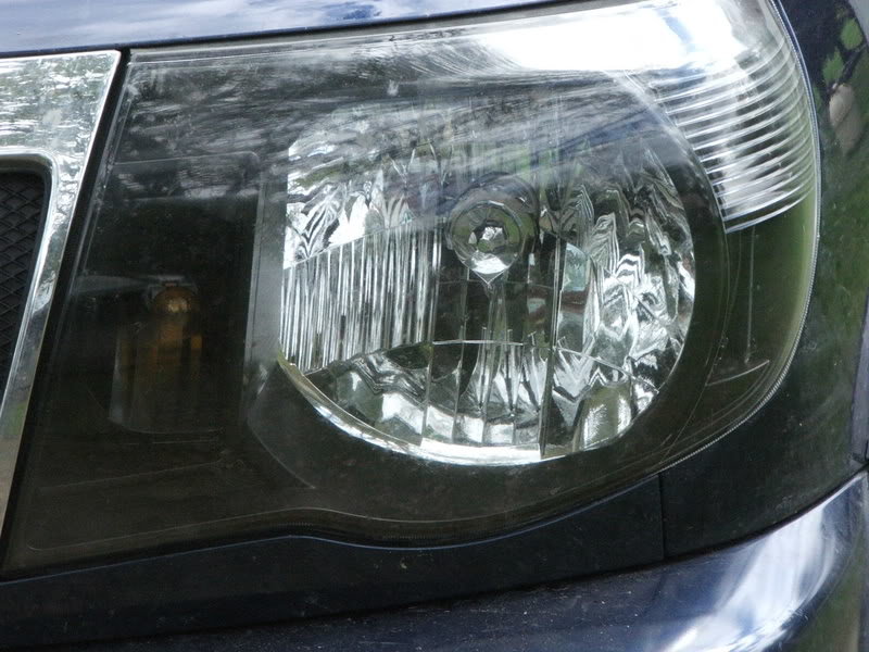

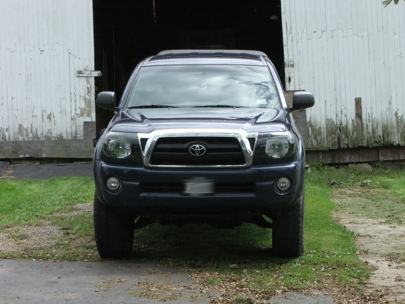

    I did the BHLM myself as well. Preheat to 300F, turn off, 10 minutes in to soften glue, then take them apart. I let my paint dry over night, and reversed the process to put them back together and put a bead of silicon glue around the edge when they cooled to help seal. Only cost was $5 for Krylon Fusion paint. No fogging or leaking. I removed the amber reflectors too.
    Oh, and someone on TN said the non-oem lights have a different light pattern. More of a spot light than the horizontal cut off the oem's have.
