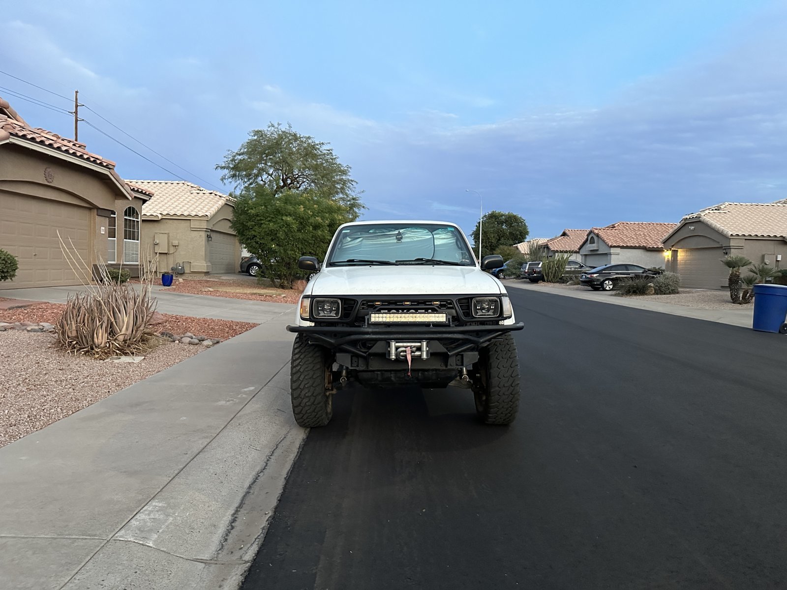

    The best option is probably a projector retrofit, but this is expensive and a bit of work to do right.
    Heres an example of someone doing this. https://www.tacomaworld.com/threads...ab-750-000-build.478395/page-19#post-22309248
    I think its around $300 to DIY, I used to see people selling them as well and would expect it to be closer to $500. Not sure if those are outdated numbers, I haven't looked at that option in a few years.
    I don't know much about the ultimate headlight upgrade others are posting about, but definitely look into that as an option as well.
    Cheaper option is aftermarket LED drop ins.
    A lot of people don't like the aftermarket LED options, I think its because most people don't properly adjust them and blind everybody.
    I have had a great experience with these though:
    https://www.amazon.com/gp/product/B08TQQSVRD?ie=UTF8
    And there's a ton of other 5x7 drop-in headlight options as well, most all of them should bolt right in with no problems.
    You need a harness adapter like this as well:
    https://www.amazon.com/gp/product/B07M6W1PMK?ie=UTF8
    With the harness its all plug and play.
    I think they look great too.
    They have a sharp cut-off line, and a decent Z-shape to lower them on the side of oncoming traffic.
    With the sharp cut-off line you can pretty easily tell if you're shining above the hood of oncoming traffic, and if you are you need to adjust them down.
    Just be considerate and point them down a bit as well so you don't blind everyone.
    The improvement over the stock headlights, that were probably at least 10 years old, was absolutely massive.
    They also have turn signals if you're like me and don't have the stock front turn signals anymore.
    The High beams are a little weak on my example, they just adds this rectangular beam of light above the low-beam cut off, and does nothing to help see the sides of the road. Light bar is still the best for throwing light everywhere (when offroad of course).
