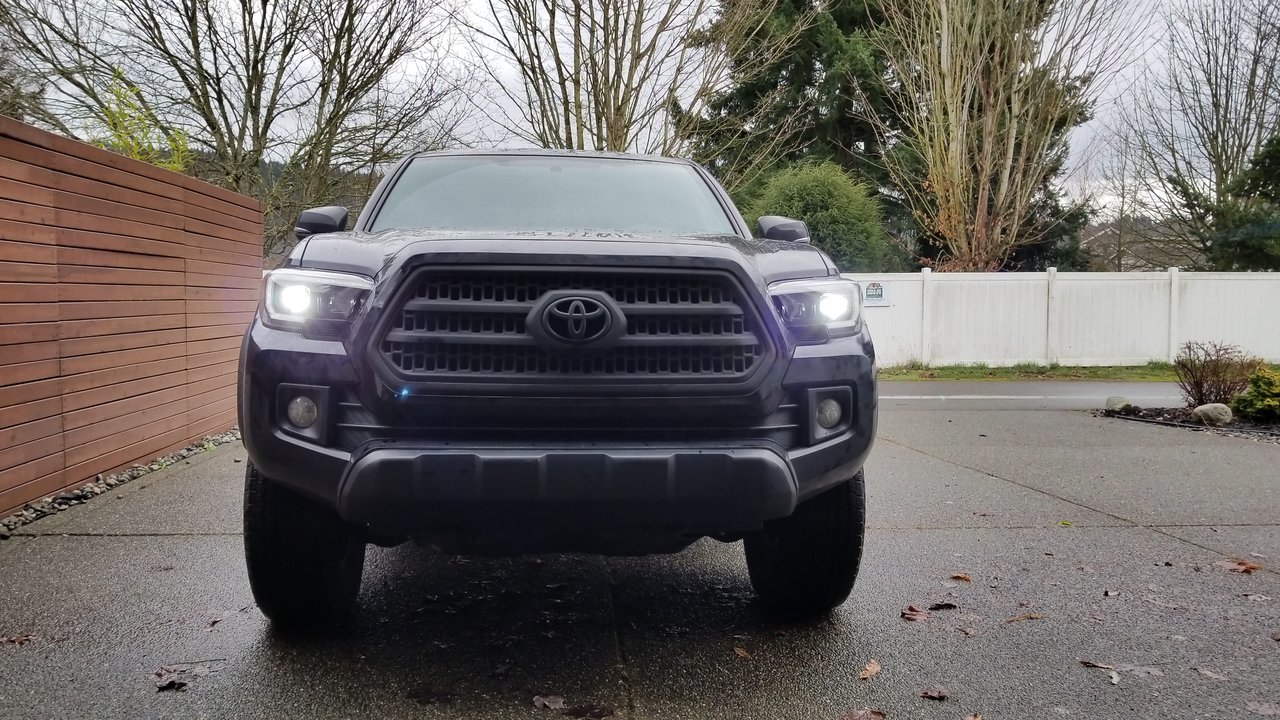

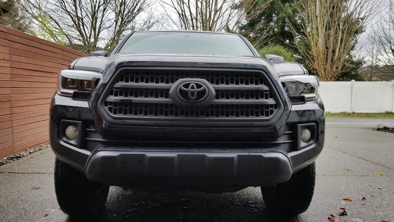

    I ordered new headlights from Tacomabeast (which by the way have great customer service) and they arrived yesterday. I took them out of the box to check them out and so far I'm impressed. They look real good from a physical stand point. I hope to install them this weekend and will do pics and videos. They are not @mesojdm looking lights, but they look good for the money. Only hope is that the light output is good, so we will see
    Link to lights:
    https://tacomabeast.com/collections...headlights-w-sequential-turn-signal-light-bar
    Link to video of lights:
    https://www.youtube.com/watch?v=fbdSuENQi0Y&t=12s

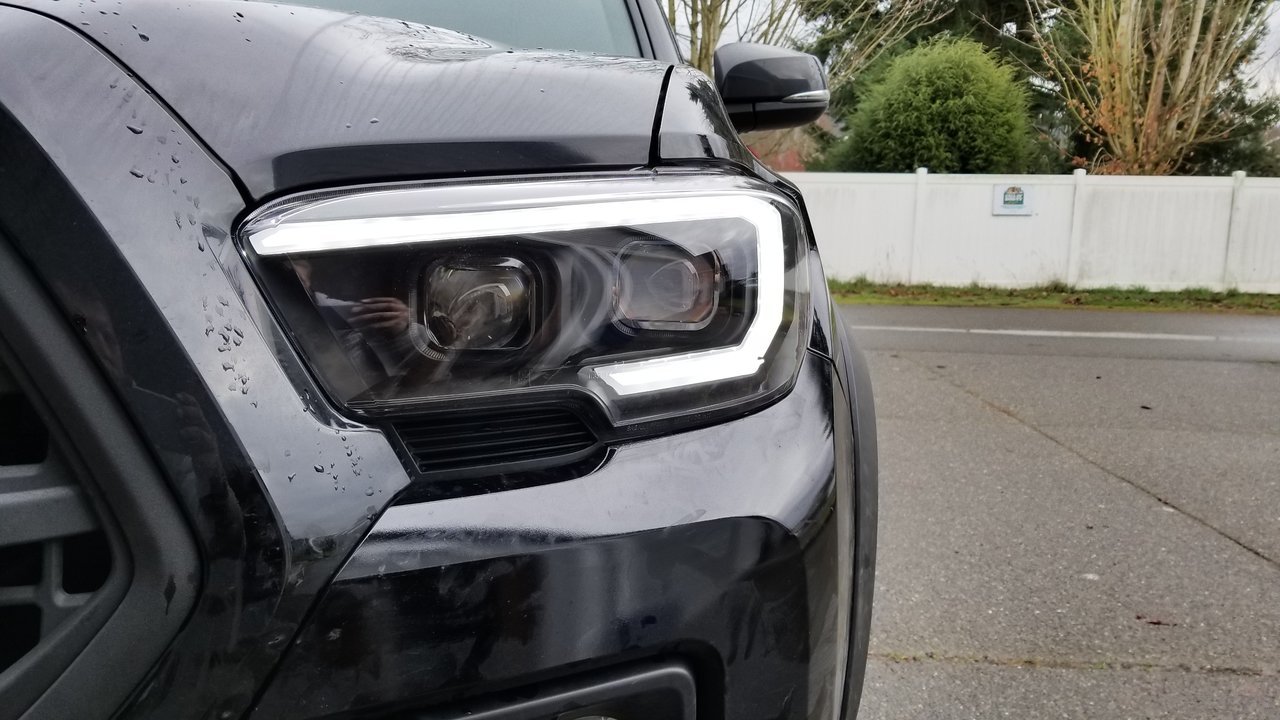

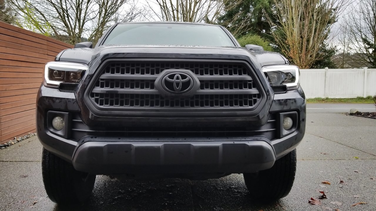

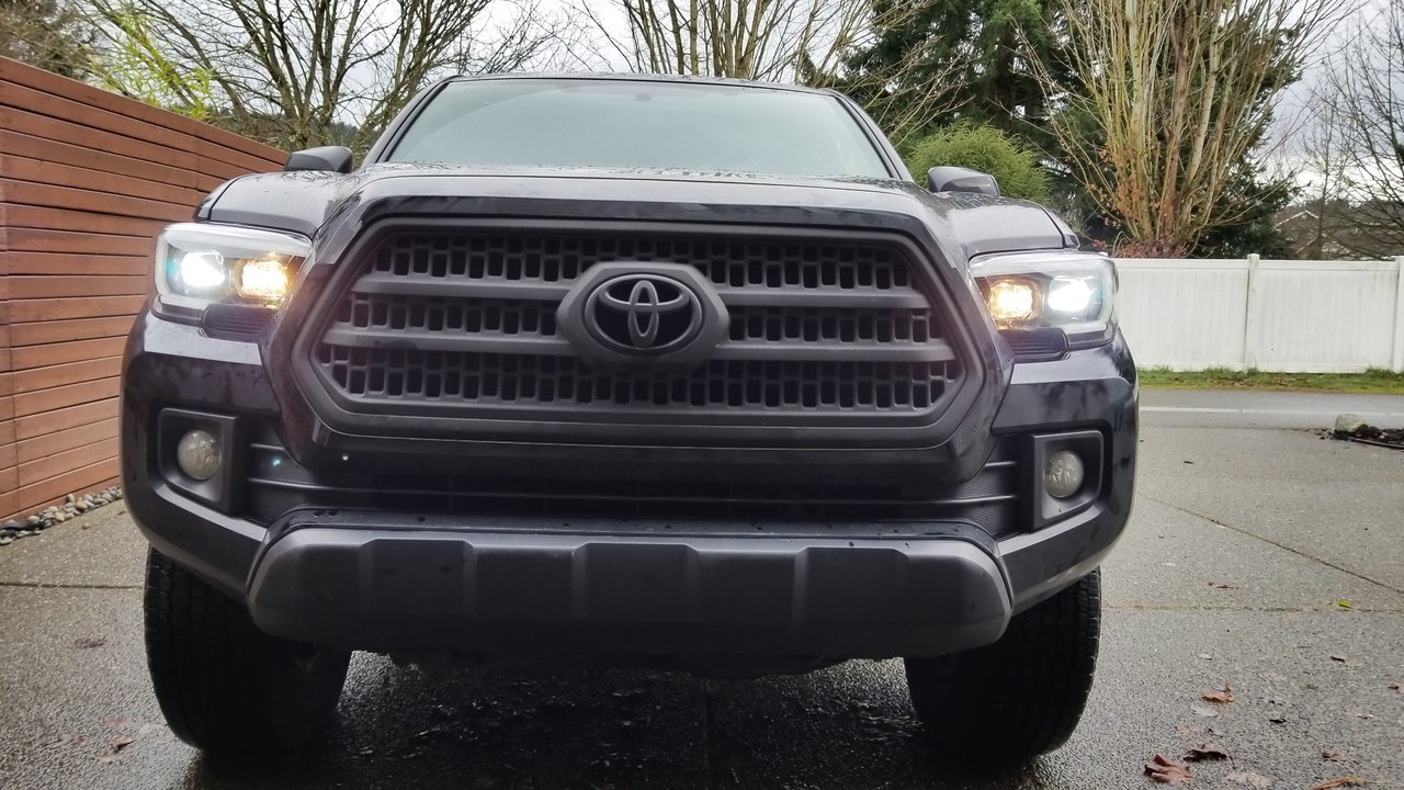

    Install notes and review of headlights:
    First of all, I am happy I got them. They make the black truck look so much better with the black housings so looks wise I'm super happy.
    The housings themselves I think look well constructed, maybe not as well as oem, but good for the money and only time will tell if they hold up, but I have read other reviews that say they are holding up. All the wires were plug and play so easy to install.
    Installation:
    Watch the video above, gives you all the steps and is easy to find. I will say the only thing in the video I found challenging was reaching down to loosen the clips on the fender flares from within the engine bay so I just moved the fender liner out of the way, reached in and squeezed the clip for the flare that way. Outside of that, the install was exactly like the video and anyone can do it.
    One thing to note to make sure of when you install them is make sure the black vent looking thing is attached to the headlight housings before installing the housings. For some reason my driver side one was missing it (which I will contact the vendor on) and I didn't notice it until I put it all together and began taking pictures. I took one off the oem headlight and then I had to remove the bumper again to install the piece onto the housing so make note of this during install so you don't have to do what I did.
    Ok onto the lighting. I am happy with them. I like the way they look. The drl's are not as bright as the oem ones and I'm ok with that because I like the looks of these drl's better than the oem's. The blinkers, however are super cool and they stand out in my eyes and that's one of the things that made me purchase these housings so I am happy with them. However, it would have been cool if it went all the way to the end, but my guess is that there isn't enough time between blinks to do that. Now I installed H7 6000k hid's into mine so I cannot comment on the bulbs they come with. So far the hid's look great. I have not used them at night yet, but during the day shining into my garage they look bright so i'll see tonight or in the morning what they look like in the dark.
    Overall, they are nice and worth the money and if you want a new look then I would do it. They aren't going to be as awesome as @mesojdm can make, but they are a good alternative. Below are pics and please excuse the dirty truck, it does need a bath big time

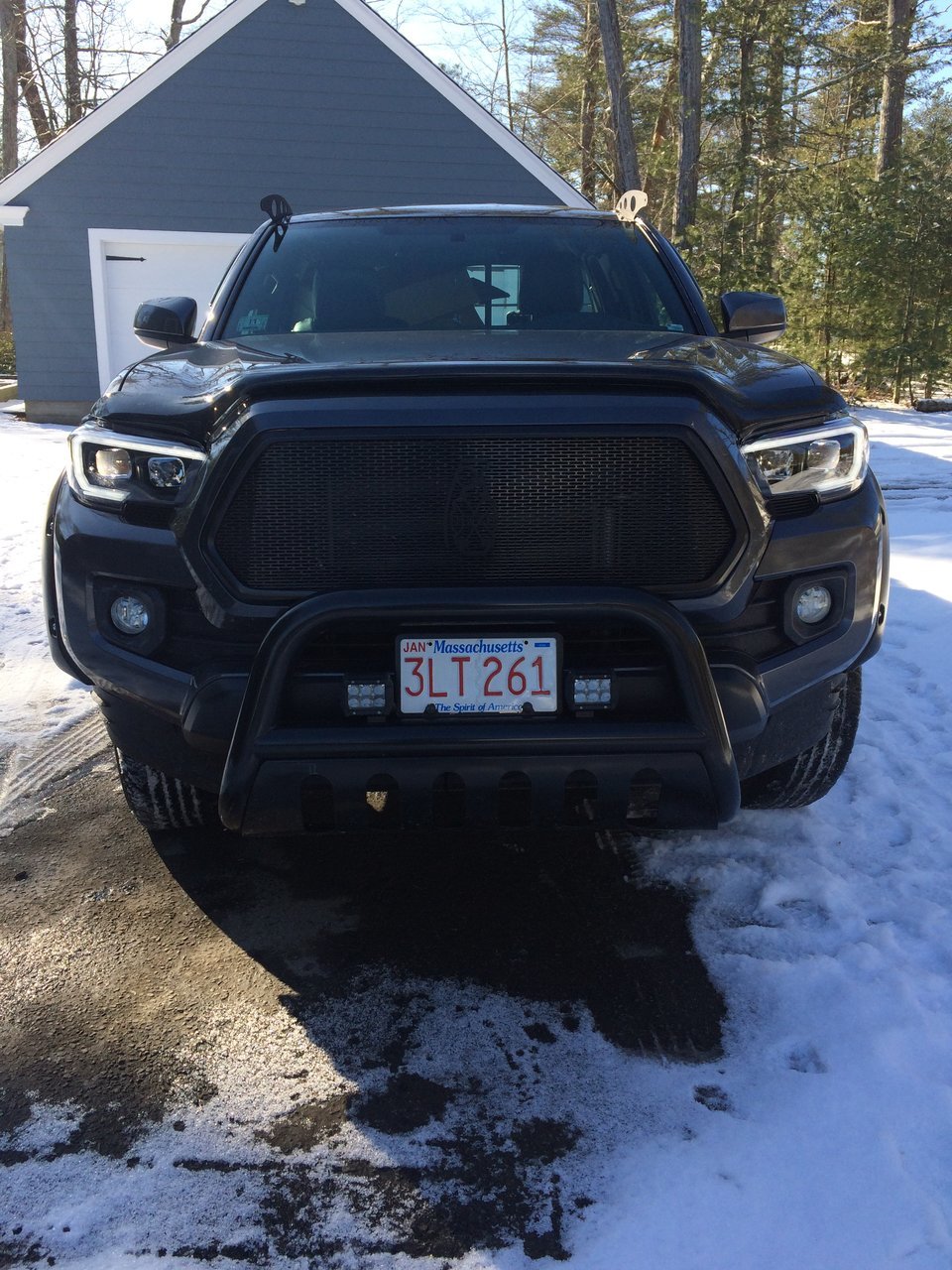

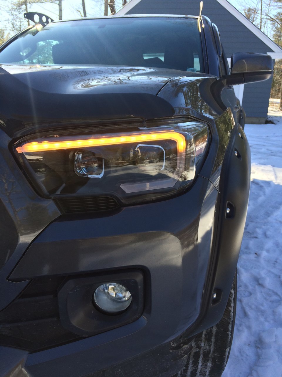

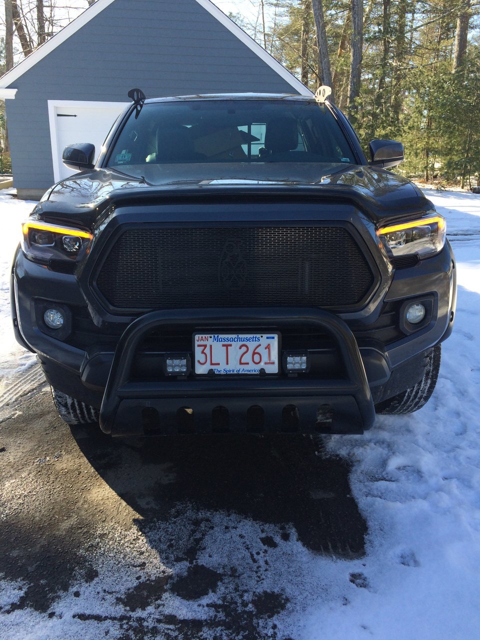

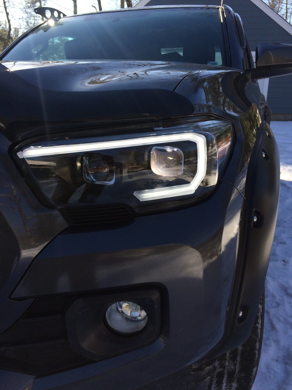

    I have a 2016 SR and if you cut the DRL plugs and add a new turn signal circuit, you can get these to work on the models without LED strips built in.

    Damn, those look good on the black taco.
