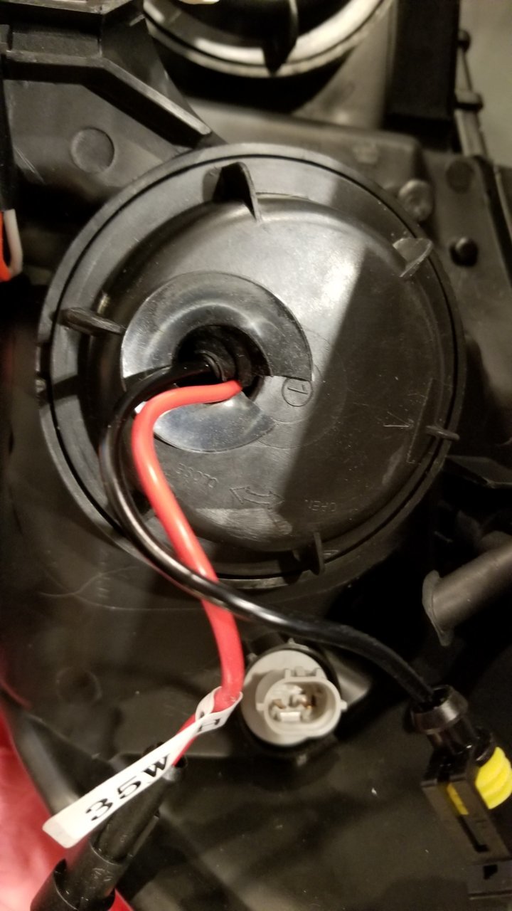

    This is not the best picture and this isn't what I ended up with, but it gives you a good starting point. What I did is enlarged the hole in the cap and then used the rubber grommet that came with my hid's and inserted that grommet into the hole and used that grommet for the wires to pass through. Then screw on cap and connect all the wires and down.

    Thank you! did you put any silicone sealant to prevent any moisture?

    Nope and still haven't had any issues after a wet winter

    can you take a picture of the hole you drilled?

    This is the only picture I have at the moment. I did change out the grommet so it seals better 2018-01-26 20.46.22.jpg

    where did you get that grommet?

    Grommet was already attached to the HID harness so I just used that one

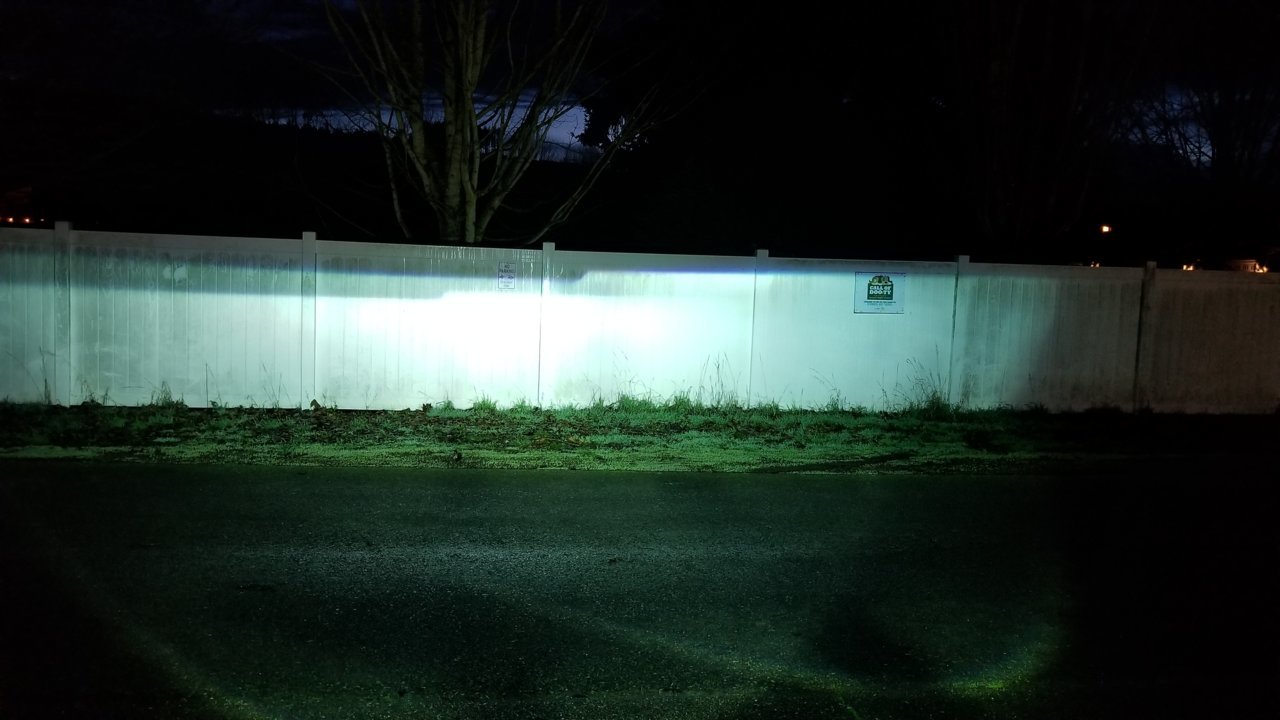

    how's the output? got pics of it?

    This is one that I have during the time I was aiming them. One thing it does not show is there is 2 shadow lines that I have not figured out where they are coming from, but it does not bother me enough to get rid of the lights
