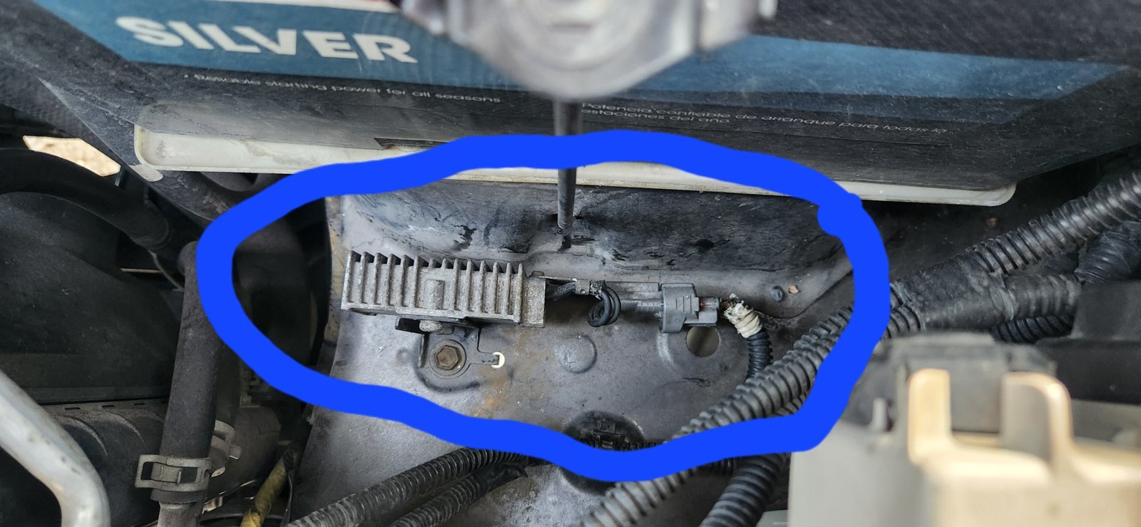

    Try a spray of starter fluid into the intake and try and start it. If it starts then you have a fuel issue as in it isn't getting any. Bypass the fuel pump relay in front of the battery. Unplug the connector and install a jumper. Then attempt to start the truck, if it starts and runs you have a defective fuel pump resistor. You can run it with a jumper ( the 4 cylinder doesn't have this resistor) but it will cause more wear on the pump as it is used to slow the pump when idling etc...

    The fuel pump relay is what shifts it from high speed to low speed in the fuel pump resistor as I described above.
