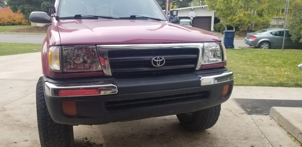

    So I just got some new clear lens headlight housings from eBay for like just under 70 bucks. Im stoked on them and think they look great. They came with bulbs too which is a plus. Although I am now wondering about the potential for more light output with a better bulb in there.
    Here is what I know:
    I like the idea of getting an LED setup to keep heat out of the inside of the headlight enclosure, but it seems some of them just dont throw light that far regardless of brightness intensity. I also could not seem to find a decent looking LED kit that would work with my housings. All I know is that whats in there now are H4 bulbs
    HIDs from what I know about them, burn a lot hotter to produce more light which seemed like a negative thing to me.
    So that leaves halogens. I could grab a pair of "high-performance" halogens that will be plug and play which is always nice, with a better light output than whatever bottom-tier bulb is installed in there now.
    I was also thinking whatever route I went, I would try and get the color temp as close to my LED side markers as I could just to keep it kind of uniform. The super warm tone of the halogens next to the much whiter LED side markers is just too much of a contrast for me.
    I would love any input from you guys on what I should do.

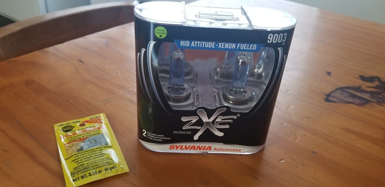

    @2004TacomaSR5 Took ya'll advice and picked up a set of the ZXE bulbs. Gonna wait until tonight to throw them in and see how much brighter they are over whats currently installed. :thumbsup:

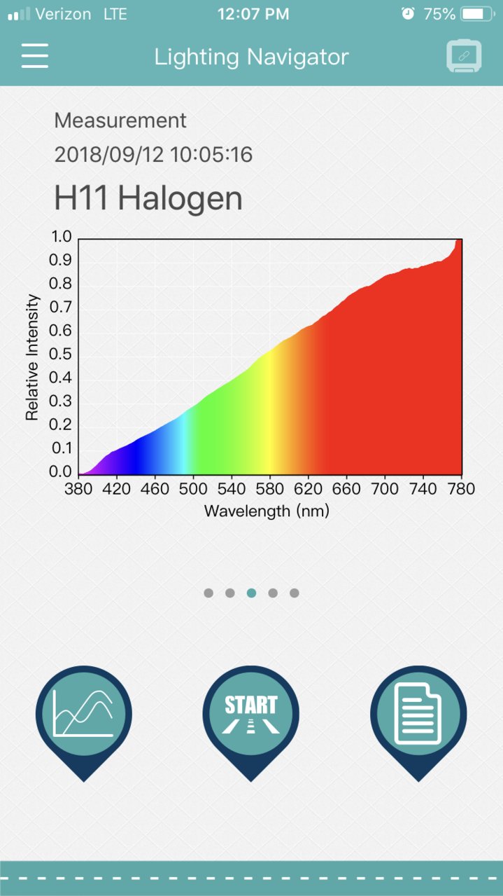

    Yes. Here is the light spectrum a halogen produces, you can see there is far more yellow light in a halogen that white/blue.
    A blue coating filters out the right side of that spectrum, which is the majority of a halogen light source output, so that the whiter blue light is more dominate, making the bulb appear whiter at the expense of a loss in light output.
