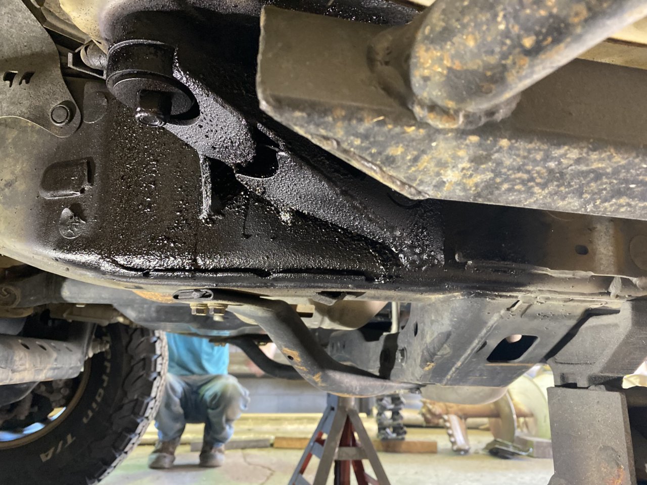

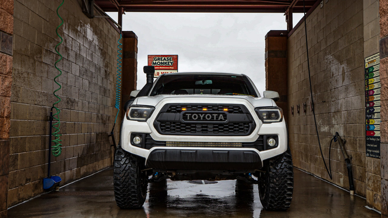

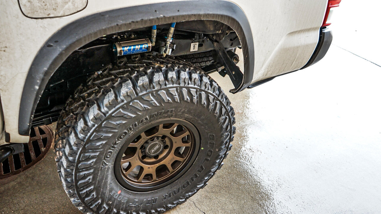

    Just an update finally got my new RRW wheels and my new 315/75R16 Yokohama Geolanders G003s, trimmed the fenders all the way around 2in and trimmed the front bumper to help clear, removed fender liners, hammered pinchwelds and relocated cab mount. D1A3FEAA-FFDF-418E-9054-E61C6C933126.jpgE057DF84-5945-49BE-BEFB-AF5B0D2CFC7B.jpgA97BC20F-193B-4F44-AAB3-431A2DEDF548.jpgC1BC1D5B-3743-49F2-AB56-0EBB8056E4B4.jpgD8E0647F-63A3-4DDD-A294-2D955B4C8341.jpg
