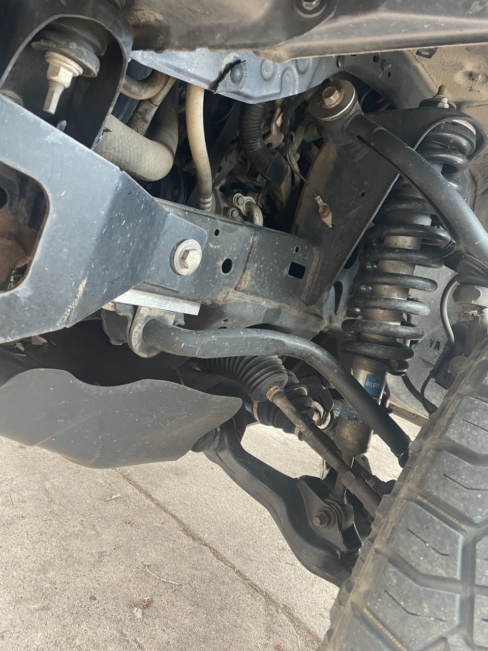

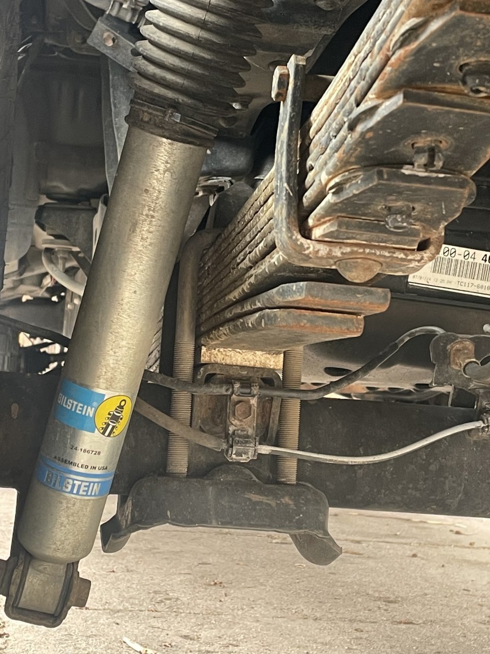

    Attached are pics of spacers and suspension

    The rear has an aftermarket leaf spring and only a small block, with B8 5100s. The front looks to have a small spacer as well, but hard to tell which Bilstein coilover that is - it may or may not be the stock spring. You can kind of see one of the adjustment rings above the lower perch, so it's not sitting on the highest setting. Your drive angle suggests that it is probably not the stock spring. Maybe just removing the blocks front and rear would drop it a little, but to drop it more you'd likely need new coilovers and rear leaf springs.

    Or just remove a leaf from the pack

    Is there a consensus that removing these blocks without any other modifications would have no consequences?

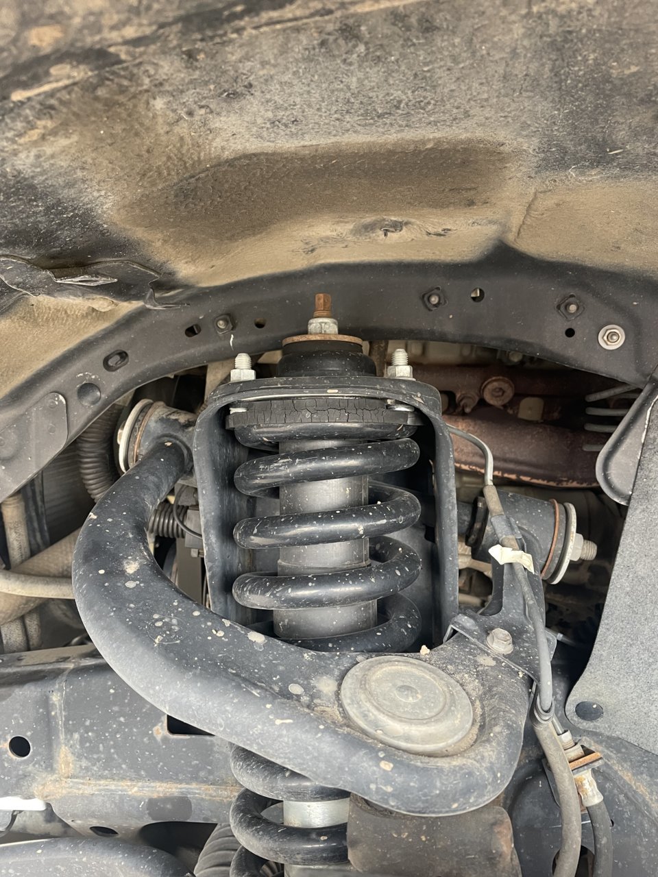

    Here’s a comparative view of L and R front lol

    That looks like it just has a leveling spacer on the driver's side to correct the Taco lean (battery, driver, and gas tank are all on the driver's side, resulting in a slight lean -- many leveling kits include a spacer for the driver's side only to correct this). Is there a part number on the front shocks? Looks like they've put a stiffer and longer spring on to achieve the lift. I don't think you can get that much lift just using the standard 5100s. Someone that knows Bilstein lifts might know and chime in, or you can Google the part number of the spring and shock if it is readable.

    Yup, that's a thing, LOL. The OEM TRD Pro front coilovers actually have more preload on the driver's side to correct for it.
    If you really wanted to get it closer to stock height, you might be able to find some OEM take-offs on here and go back to stock coilovers and rear leafs -- but I wouldn't do that with the ARB bumper on there, that thing is super heavy.

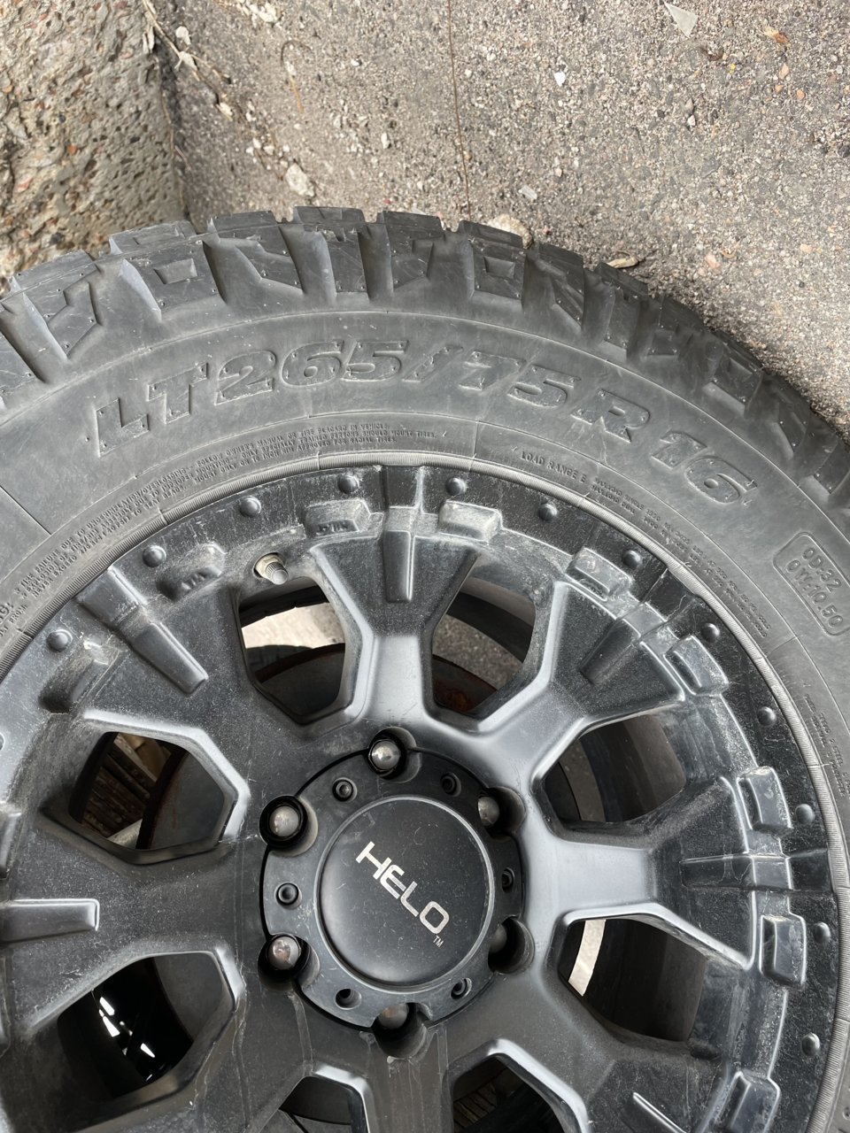

    Tire pics ⬇️

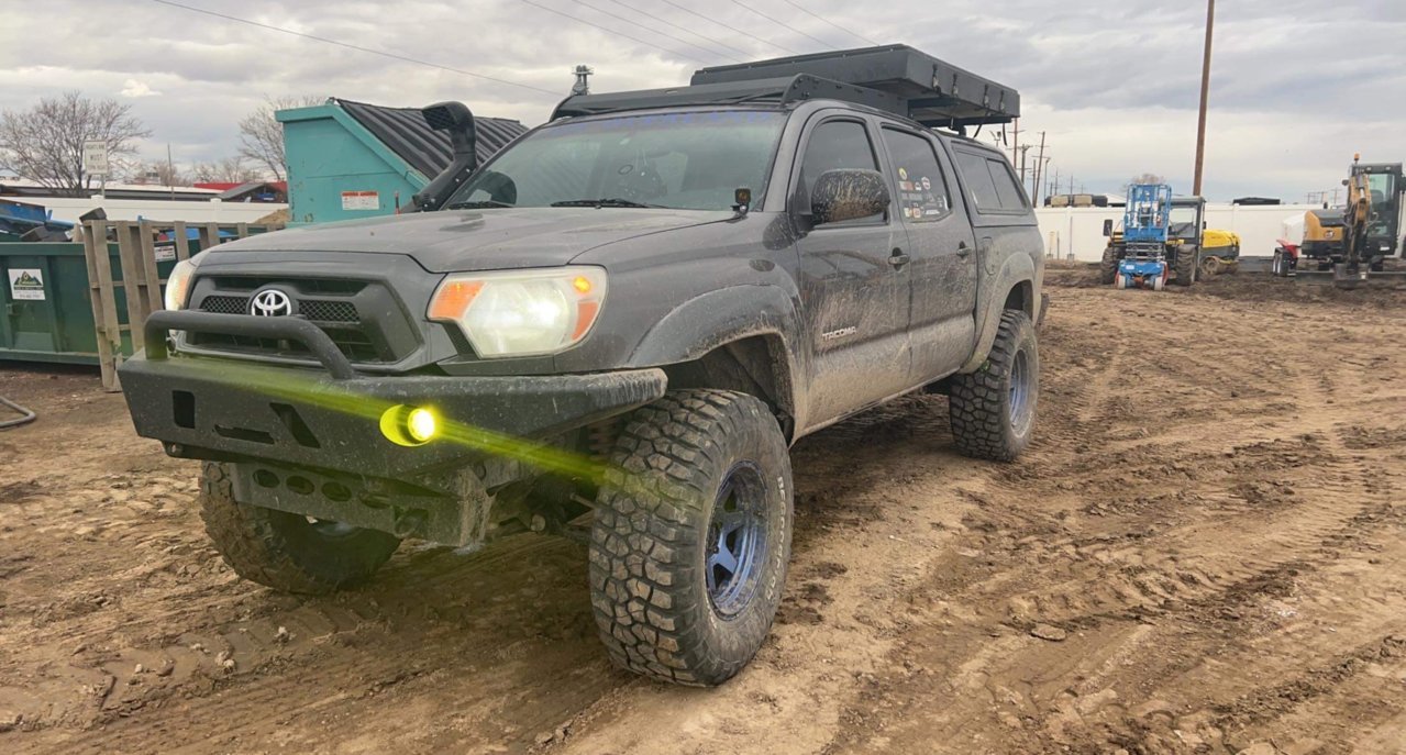

    Found a guy through Facebook marketplace that wants to trade his for mine
    It’s in the ballpark of what I was looking for a little more low profile and a little bit lighter
    Once the bumper is swapped out, I might get stock coils for the front and swap out my toy tech boss leaves for a simple add a leaf system
    I might be the first person in history, actually trying to downsize their Tacoma

    This is the bumper the guy is giving me for mine
