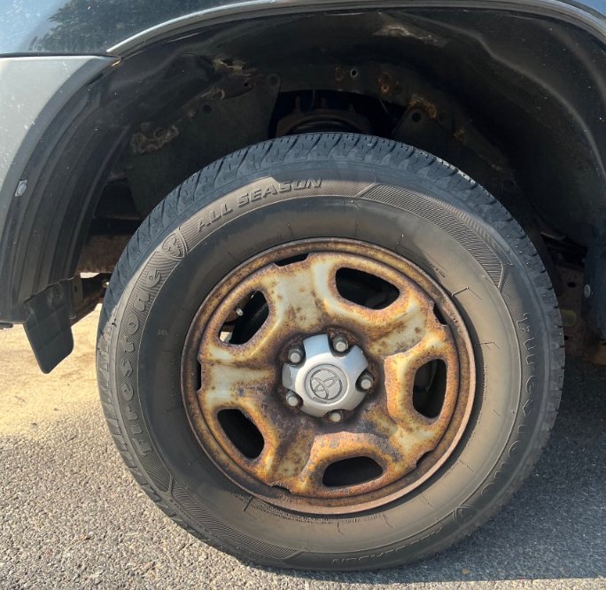

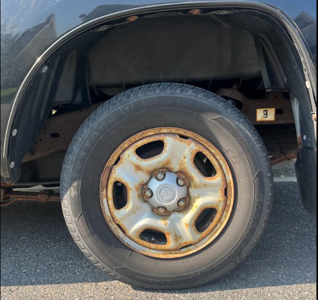

    I recently inherited this 2012 Access cab v4 2wd Tacoma and I love it! But I need some advice. :)
    I'm very new to the whole truck thing and I want to do things right, I'm starting by getting new wheels & tires. (+ new brakes too don't worry)
    My question is What size tire/wheel do you think I can run, I feel like the car would look and run better with a slightly bigger set up and ride height. Its currently on a 5 Lug 215/70/R15.
    If anyone has this same truck or a similar one please share some wisdom with me.
    Thank you!

    1,199
    2013 Tacoma
    265-70R16 without issue

    Check that frame before you spend a dime.

    Before you go pouring money into the truck, have you done a thorough inspection of the frame for rust?

    These mentions of rust are worrying, I've drove about 8k miles with no problems but ill take it to a shop to get a inspection done asap. Thank you

    First, what they said about frame rust.
    Search the forum for specific areas to inspect.
    As far as the wheels/tires go, I switched to 16" wheels with 235/70R16 tires with no problems.
    Wheels are from a Highlander and have the right bolt pattern, offset and center hole to be a no modification swap.

    that would require a lift, 235/75/15 is biggest you can go without a lift on a 5 lug. completely different suspension than the 6 lug tacomas. maybe 30 x 9.50 with black box removed

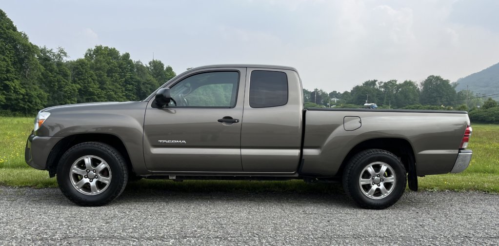

    no worries!

    2013 5 lug 4 speed auto
    frame looks
    all good! not many 5 lugs out there

    Making them fit under the fender and having enough power to turn them are 2 separate things. I wouldn't go bigger than 235/75/15 on that truck.

    235 75 15 on stock wheels will work with no lift and no rub
