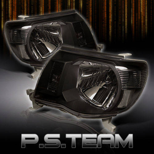

    So I recently purchased these headlights from ebay thinking they were completely blacked out already.
    But the reflector is still chrome. When I pull these things apart and if i decide to paint it satin black, how much of a offset in color do you guys htink it woudl be?

    There is no point in buying them completely blacked out or even having them completely blacked out without a projector retrofit. The light output will suck and may even be illegal or bad news if you get in a wreck at night and your insurance company sees them that way with no real output.

    Thats why I purchased them...to retrofit them..
