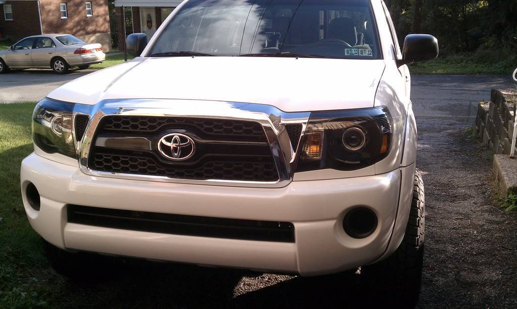

    FX-R's complete was a pain in the butt to retro but well worth it will have night shots later.....

    Looks good! :thumbsup:

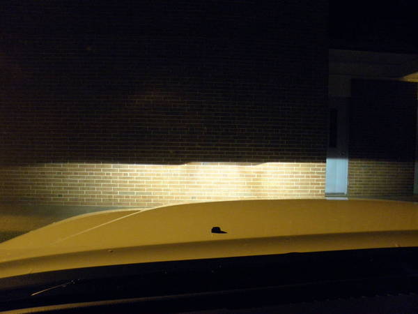

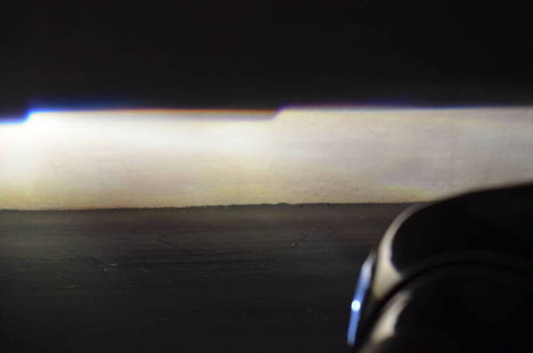

    My cutoff

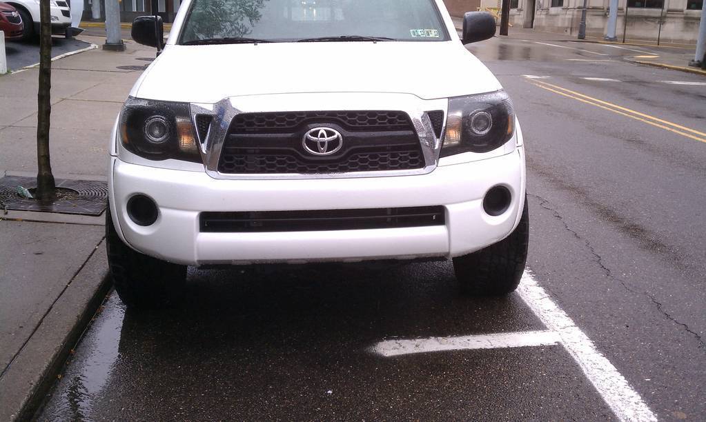

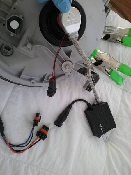

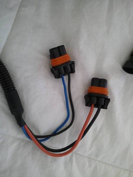

    Wiring up my retros and have run into a problem. Using the D2S III Kit. On the wiring set, for each side there's 2 connectors, one that should go to the wire harness on the ballast and 1 that should go to the headlight bulb itself. One has a blue and black wire, one has an orange/red and black wire. Which hooks to which? Would hate to hook up stuff backwards.

    You should have a connector in the harness that plugs into the ballast and the lead on the ballast plugs into the bulb

    the red and black goes to the ballast and blue and black goes to the 2 small wires from the projector
    took me a minute to figure it out to but they only go one way, i tried both ways. the red and black is power to the ballast and blue and black is for the solenoid that controls the hi/low feature. make sure those wires are tightly pushed in the plugs. mine were loose

    That answer doesn't really make sense.....here, maybe I'll try to ask my question better. Note the pics below:
    See there's a red&black wire coming away from the headlight via a connector, and a connector coming from the ballast itself. As can be seen in the 2nd pic, the wiring cluster has 2 connectors, one with a blue&black wire and one with a red&black& wire. My question is which goes with which? Red&black from the bulb to red&black on the wire cluster, and then the blue&black goes into the ballast?

    yep you got it! i know the blue/black and red/black were throwing me off too. had to call another member to confirm. to me it shoulda been color matched better but i also tried plugged in both ways and only one worked :thumbsup:

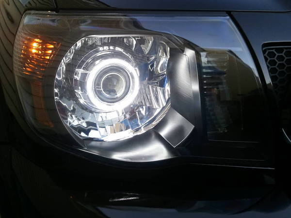

    It looks damn good! Did you paint the chrome part of the turning lights black? more pictures please!

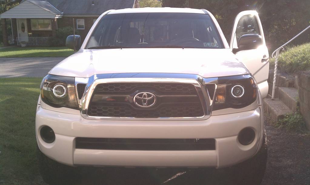

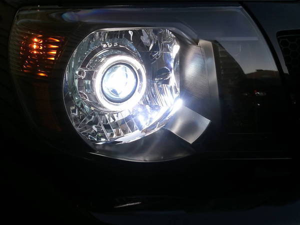

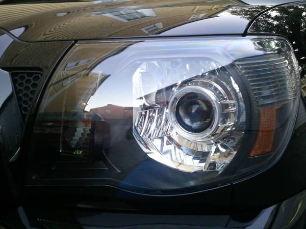

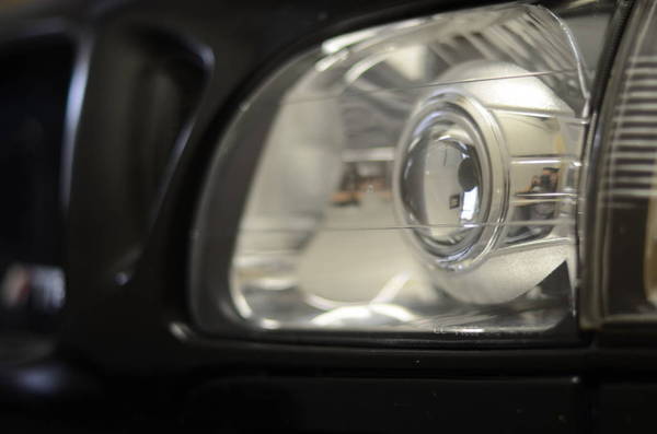

    So i ended up doing the BHLM along with the projectors. I painted the chrome behind the yellow reflector and the clear turn signal reflector....basically painted everything black. I think it turned out nicely, and my turn signal isn't significantly dimmer/darker, because I didn't paint/tint the reflector in front of the turn signal bulb.
    Drivers side headlight, off (ignore the glare from the sunlight)
    Passenger side headlight with just halo on
    Passenger side headlight fully on

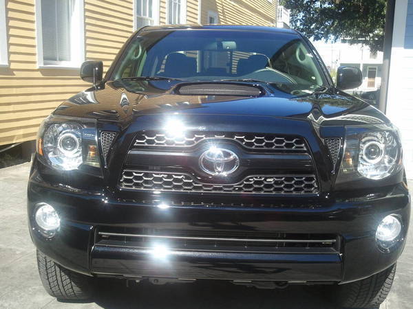

    This was quite the project and I had to take apart the headlights after 2 days because I didn't glue the shrouds and they fell off :mad:
    Rainy Pic: [​IMG]
    Non-Rainy Pic: [​IMG]
    Halos on: [​IMG]
