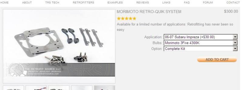

    I was trying to weed through all 15 pages, but figured that I'd cut to the chase...
    1. Is this GD still going?
    2. Saw that the initial links for the GD go to this page: http://www.theretrofitsource.com/index.php?cPath=24
    I got excited- the kit that I need is right on that page. I read a few more pages into this thread and saw this:
    So in the list on TRS, the kit that I need is a "Retro-Quik" kit that uses special brackets on the Stage III kit. That being the case, does it fall under the GB parameters? I don't want to buy/pay and then get rejected and pay full price...I'll just wait until a GB occurs again on one of my "home" forums.
    Thanks!

    I kept reading and found this:

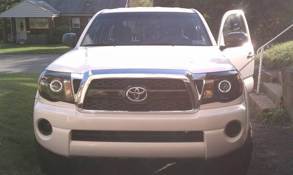

    possibly interested....
    hopefully getting my hands on a pair or OEM heads this weekend and if i do then i'll be looking into this...
    so the main difference between the FX-R and the Morimoto Mini is the FX-r has a wider projection and the Mini is easier to install, correct?
    i think i'm looking at..
    http://www.theretrofitsource.com/product_info.php?products_id=237
    Morimoto 3Five
    Morimoto 3Five 5000K D2S
    Apollo Shrouds
    H4/9003 Relay...
    does that sounds right for 2nd gen OEM housings?
    has anyone gotten the CCFL Angel Eyes with their Retros yet?
    thanks..

    Sounds right. Here are my CCFLs (turned on in the daytime):

    sold!
    thanks for the pic...i like the angel eyes that i have in my current lights but not a fan of the housing and getting sick of the look, hense the retro research..
