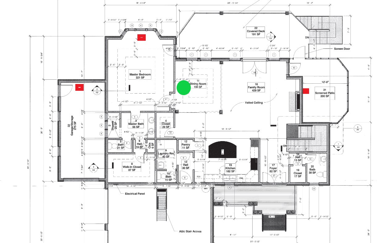

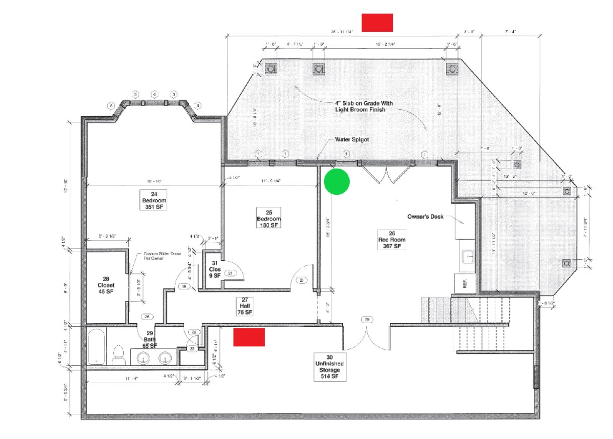

    Closing on our dream home next week. Both of us WFH full time, need to have solid WiFi through-out. I will likely hardwire my laptop but wife wanders while she works. Red squares are where we need the signal to be strongest, Green circles are where I've considered placing the routers. I liked the idea of using the Google Nest stuff since it seemed easy to set up and from what I have read the Nest Wifi is pretty solid but if there are dissenting opinions I am all ears. House is 2 story, 4000 square feet.
