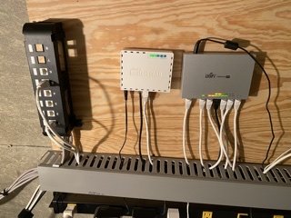

    The Dream Machine is an all in one option that would get you up and running for sure, but it seems a little pricey to me. You're paying for a device that is a router, AP, switch, etc, but if you buy separate APs, then the built in AP in the dream machine is kind of redundant. I'd do like TX Honu suggested and just get a basic router that has no built in wifi. I have a Mikrotik hex router, which is super simple, cheap, reliable and fast, but I will admit that it is also not user friendly at all. There are tons of options out there for a basic, no frills router though.
    I have some of my network stuff tucked away in a closet. Here you can see a patch panel for some of the hard wired stuff at the top. The router is the top white box and the unifi switch runs off of it and gives power to my APs. This is not a plug and play solution, so it all depends what you’re looking for. I am often guilty of going over kill on things like this, but I love the results.
