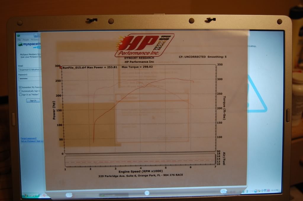

New HP numbers for the n/a 2nd gens

    Cant remember your mods, but how bout a quick update.

    urd tcai, DTLT, custom exhaust setup, and apr x1

    And thats at the wheels right?

    Damn those are great numbers! How much did that cost to do though?

    DynoJet = cheater!
    Go dyno on a DynoDynamics get real dyno numbers then sit in self pity like I do. :( :laugh:

    is that like a 45 hp increase from stock? Is most of that hp from the x-1? I'm thinking headers and the intake is good for 15 -20 at the most?

    The avg stock pull is anywhere from 190-200rwhp.
    Prior to the X-1 Jax dyno'd 241/266 that was with i/h/e and a tune with the URD Maf Cal.
    So the X-1 stage I kit netted an additional 12hp/32tq on a prev tuned truck. You can't get much better then that.

    yea, what he said.
