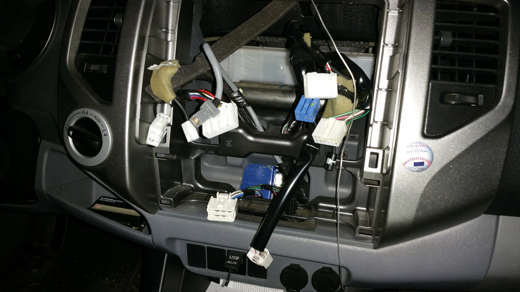

    I pulled the dash apart and good Lord what a mess of wires. From what I can tell, I, going to have several "left overs". Pretty sure I've got it figured out, but i still have a couple of questions. Which harness has the reverse wire in it, and what color is it. Also, where is the park switch wire. Or can I bypass it?

    I missed this post ( i was probably buzzed), when I asked about the info.
    And You can use t taps for connecting them, I asked my co worker thats been installing for 15yrs and he said its fine. He's never had a problem using t taps. Pac doesn't recommend it probably because the t taps can cause a little resistance.
    There's a parking brake micro bypass that they sell on Amazon for around $13, if you don't want to tap the parking brake wire.

    I don't have a problem tapping wires, I just don't know where they are. I've done more research on that subject and it appears that the parking switch is in the kick panel. No problem there. The reverse lamp power is down there too, but there's got to be a harness in the dash behind the HU for it too.
