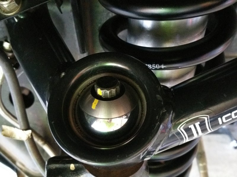

    Tubular uniball UCAs. I was told not to grease them (the uniballs) and only to grease the bushings. Was that proper?

    somewhat, you can use a dry non oil based teflon lubricant like triflo or similar to help refresh the teflon liner in the uniball which will quiet it down a ton. Never under any circumstances use anything oil based, it quiet it down for a minute but do detrimental damage to the liner and attract more dirt which will cause the uniball to wear out faster.

    Wanted to give some closure and also say thanks to you guys. I ordered the TriFlow dry lubricant and applied it to the upper ball joints. Perfectly quiet now. I'm in heaven. Thanks again for the help!
