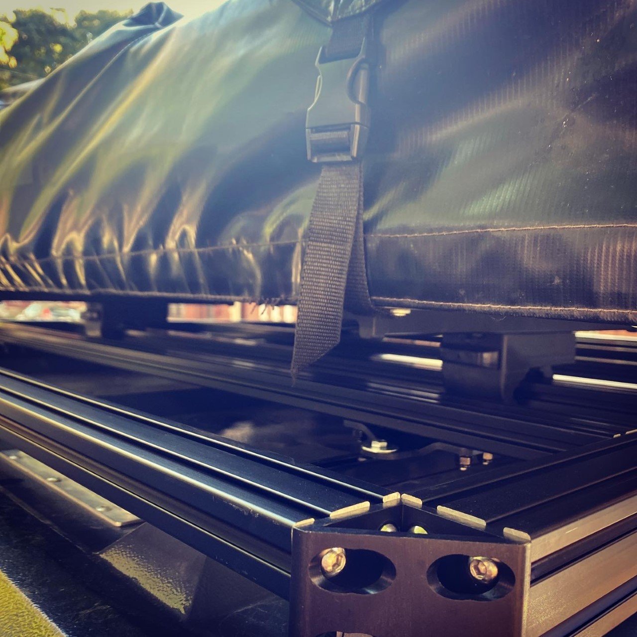

    Agree 100% on the extrusion rack, built a platform for about $300 not including the mounting feet and it's so solid that I'm doing another one over my cab. You can mount just about anything to it and all of the Sherpa and Prinsu accesories fit.

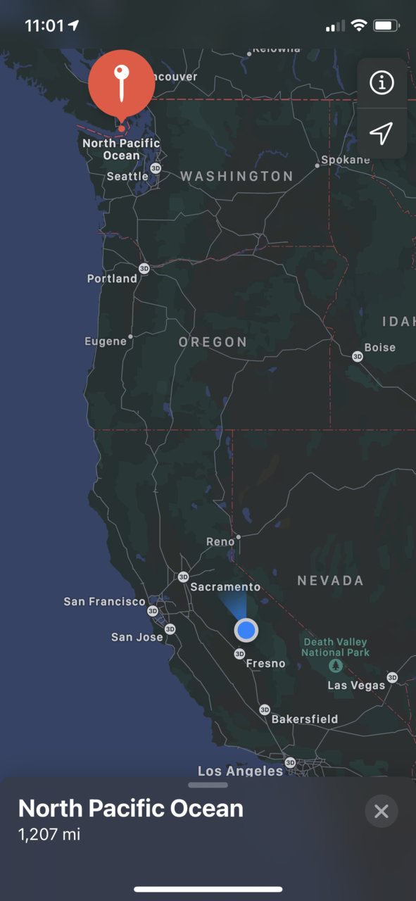

    Hurry up please for the love of god. Ordered in October...
    Tears slowly coming out of my face, screenshot is the current location of the ship that brought it overseas.

    Lets hope the port is not as backed up as it has been lately. I had a customer send me the same screen shot full of excitement. We have three coming in on this shipment.

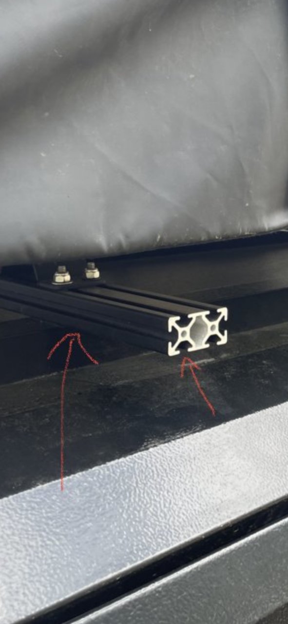

    90
    FDF69886-1ED6-4985-AF5D-3ECCBC380A73.jpg I’m assuming you only slide one bolt into grooves and you tighten from the inside of the cab per the arrows? How do you keep the bolt from spinning since you can access the top of the bolt?
  12. Apr 10, 2021 at 1:01 PM
    #452
    TacoNoVeggies
    TacoNoVeggies Well-Known Member
    Mar 29, 2020
    #323309
    374
    San Diego, CA
    '20 Off Road ACLB Quicksand
    Stock
    The bolts that slide into the aluminum are not round, they're rectangular. Tightening the nuts on the bolts twists them such that the head locks into the channel (the heads can only turn around 40* or so, not spin all the way around). Since the bolt heads cannot spin all the way around, it allows the nut to cinch and secure the aluminum bar to the cap (nut on inside cap, head of bolt securing the bar).

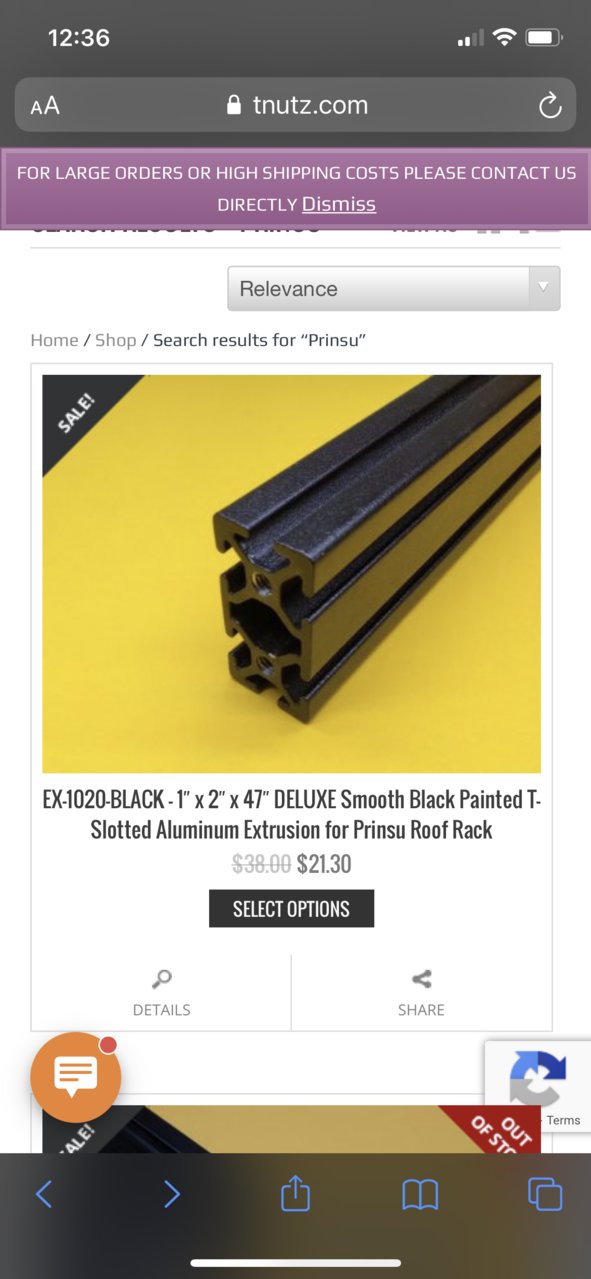

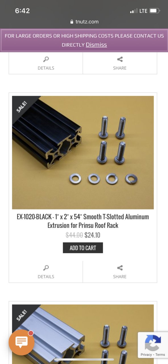

    the extruded aluminum basically works in the same way a carriage bolt works. The head of the bolt basically sits inside the groove of the extruded aluminum while the carriage portion of the neck of the bolt is squared off and sits directly in the bottom most part of the aluminum rail. Once the squared off part is situated inside the rail the bolt cannot spin but is free to move along the rail. Basically drop the bolt in the rail move it into position and when you begin to tighten it from the inside of the cap the squared shoulders of the bolt prevent the head from turning and allow you to tighten the bolt. The bolts sold with the 10/20 aluminum rails in the picture below work in this fashion. I will send picture of the bolts in a little while being put into the rail.
  14. Apr 11, 2021 at 6:25 AM
    #454
    Robersmi09
    Robersmi09 Active Member
    Jun 9, 2020
    #330895
    33
    See immage
