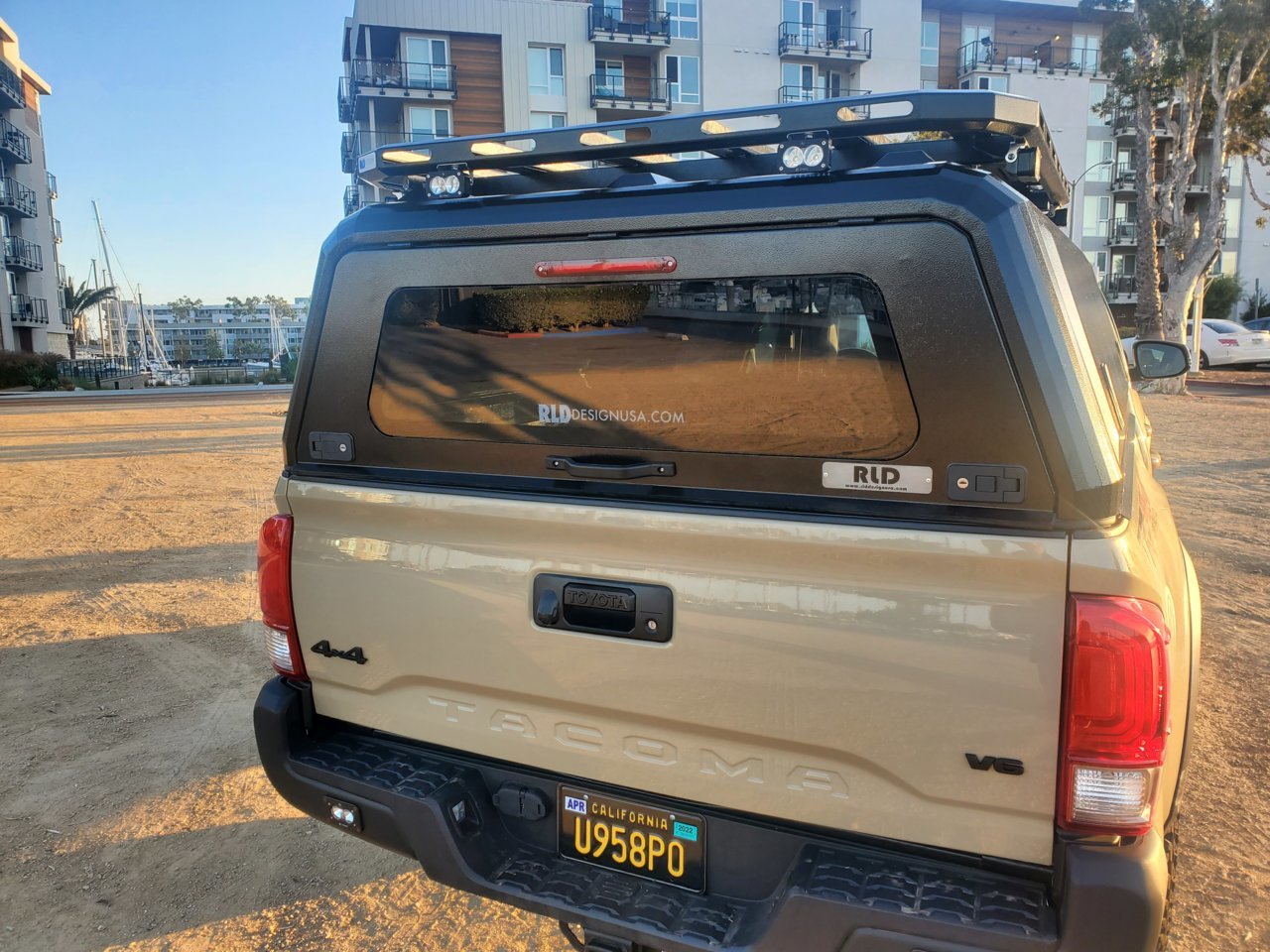

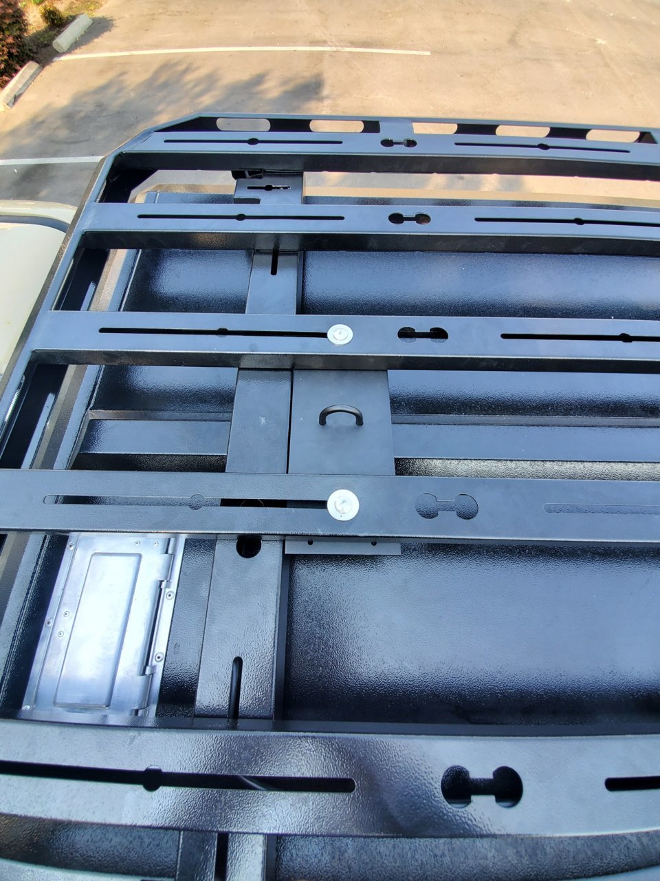

    Beautiful setup. Tell us more about this bushing system. I assume this is something you designed, as opposed to the standard RLD cross bars and roof rack?

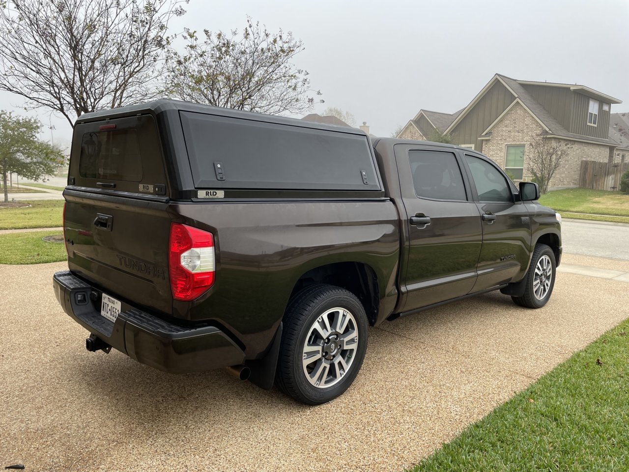

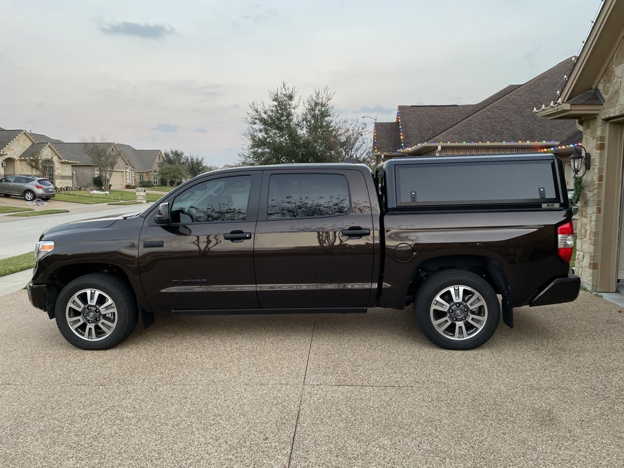

    My canopy took six months to arrive after I ordered it from Adventure Mobile/RLD USA. Despite that, I absolutely love it. Now thinking about a roof rack system, possibly FrontRunner, but I’m not too familiar with how they work and am having trouble envisioning the best way to utilize the canopy holes and keep everything as low-pro as possible (garage clearance). Seems like the method of mounting a roof rack to tracks just adds height unnecessarily. Again, maybe I’m missing something.

    Great looking rig! If you're going to mount the rack using mounting feet the roof tracks aren't going to raise the height by more than 1/8", the mounting feet themselves will add the height. You can mount the rack directly to the canopy using the holes on the ribs which would save you the .5", 1" or 1.5" from the actual mounting feet.
    I've gone the track route and like the versatility of being able to use Thule load bars or my platform rack without having to unbolt anything from the inside (running a half cabinet as well). First thing I'd consider is what you're actually using the rack for and what's going up there. Personally, I've gone to a wedge style tent to keep roof space vs my old Smittybilt and Yakima tents so now I'm rethinking my need for the platform rack altogether since the tent itself has load bars, etc. So, now I'm going back to 2 or 3 load bars...it's a never ending dilemma and ongoing transformation for most builds so thinking ahead to what you may want down the road is the best place to start, in my opinion.

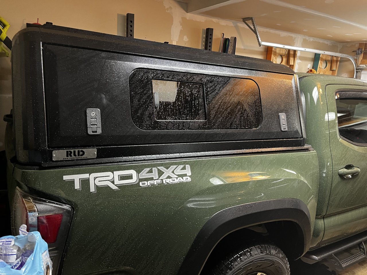

    Hey Everyone!
    I was able to find, purchase, and have my RLD Canopy shipped within about a week and a half… NO LIE! I couldn’t find any around me in Ohio so I started looking at dealers from other states on RLDdesignsusa.com… I stumbled on Altitude Industries out of Colorado. He only had a couple left but said they had a shipment on the way.
    Anyways, they were a SUPER informative, small run business and he shipped it to me in the crate, I picked it up from my local freight company (or you can have it shipped to your house for an extra fee). I installed it myself with just help from one buddy to lift it on the bed.
    I highly recommend these guys. Lee, one of the owners, answered questions I didn’t even know I had, lol.
    Go check them out!
    https://www.altitude-industries.com/
    Storms hitting good today.. the cap does leak more than I was hoping.. gotta figure out if I didn’t tighten down enough to press the seal down more or what the case may be.. I know it’s not gonna be 100% water tight.
    I’m trying to figure out how to wire up this dang 3rd break light though..

    Keep us updated. This is the Information we can't find. Other than bed leaking didn't know of water problems on rld canopy

    Looks great!
    I wire tapped into the 3rd brake light on the left side using a quick wire splice set from Harbor Freight ( ). You can get them from AutoZone or any auto shop as well. Been taking the truck off road, no issues from vibrations, etc.
    After having the canopy & traveling in the truck full time I've experienced leaks from the stock top bolt hole covers.

    I've had my RLD for a while now and the only leak I had was from the rivets on the pressure vent. A quick once over with silicone fixed the problem and been leak free ever since. Also sealed the two front corners where the canopy meets the bed when I did the install with RVT
