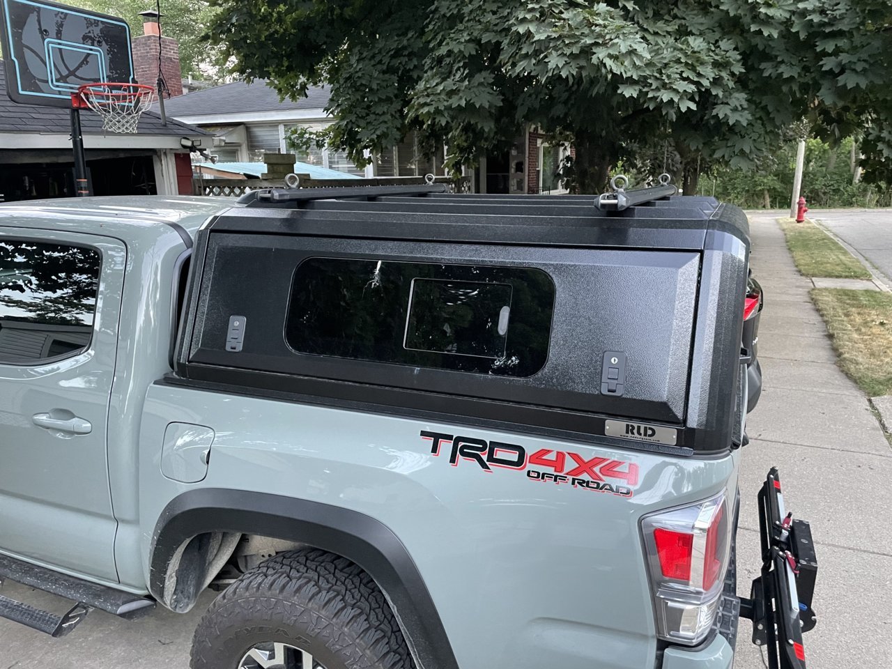

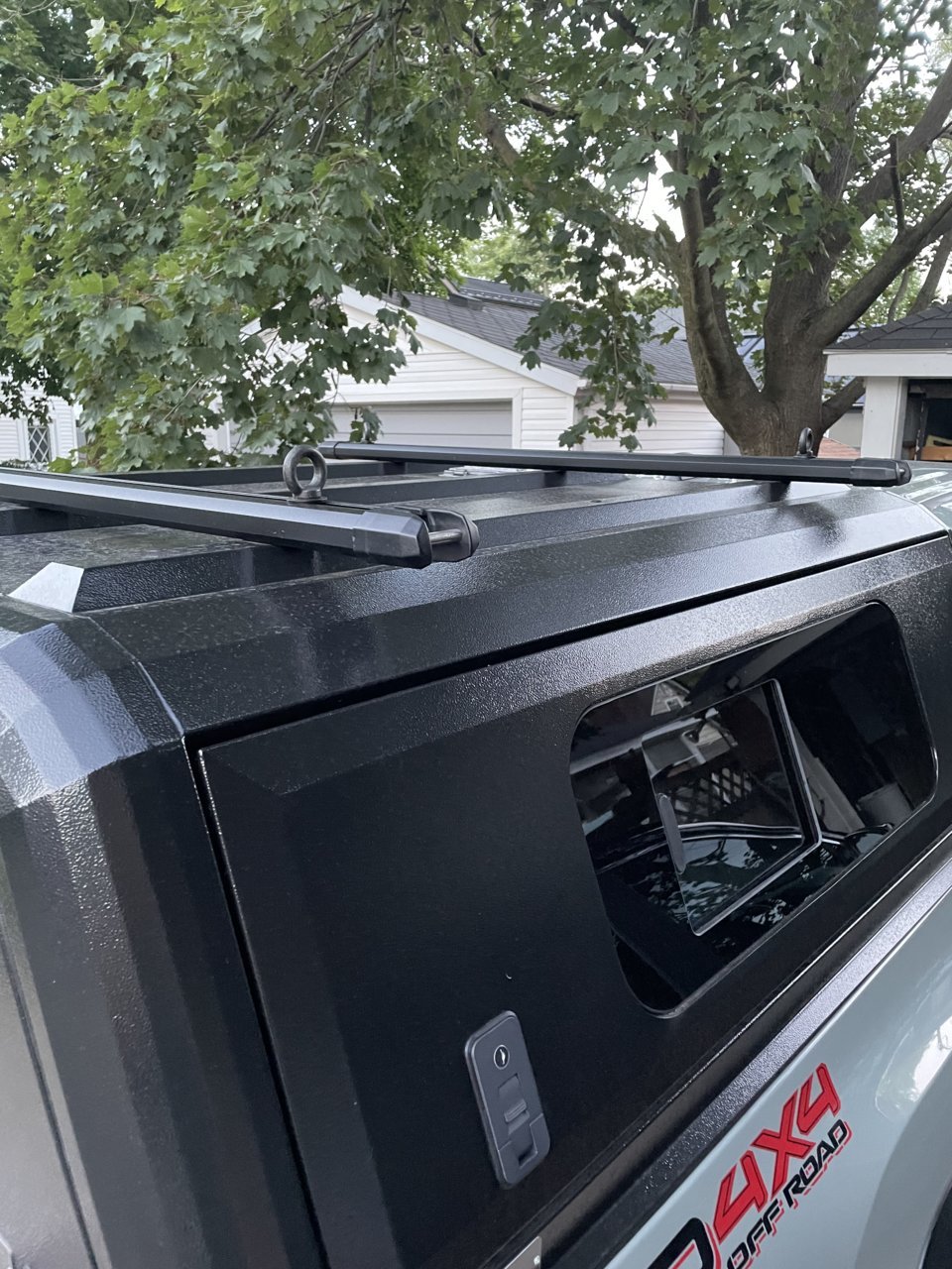

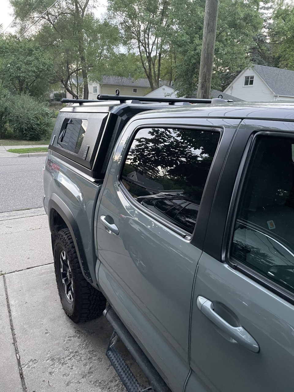

    Here are a few pictures of the Yakima HD bars mounted.

    @Maven was any modifications to the rld canopy necessary for the yakima bars? Sounds like it bolted right in from what you wrote.

    No mods I used 4 of the holes in the roof to mount it. The HD bars have tracks on the top and bottom so I just used T-bolt's through the shell holes and bolted them down with some sealant.
