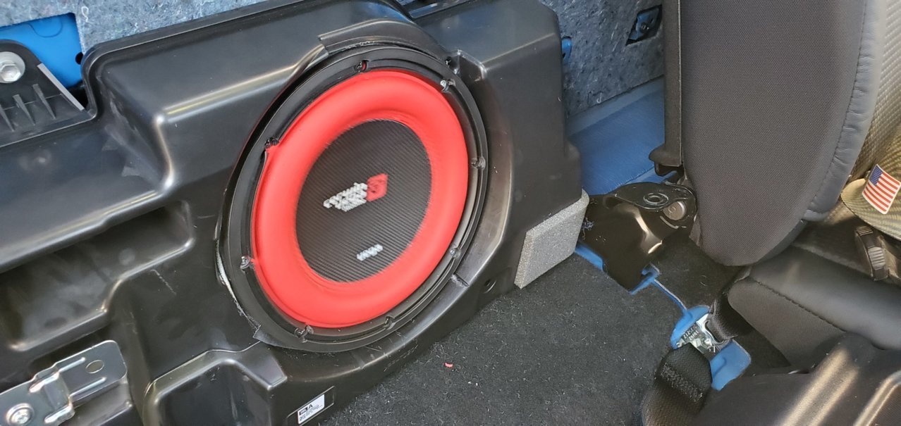

    I bought a new sub. A cerwin vega it is switchable 8ohm to 2ohm I have it set on 2 ohm. The sub is dual voice coil but cerwin vega pre wired it so it only has one set of terminals for the input to the sub. I wired it first with just + and - from 1 of the 2 sets of wires coming from the amp and it sounded good but not great. It sounded the same as the stock sub. Then I tried just the + from one set of wires from the amp and just - from the other wire like I was bridging the amp and same result. Sounded same as stock. So I thought it was weird that when I bridged or thought I bridged the stock amp and when I only used 1 wire it sounded the exact same. So I tried multiple combinations and I'll have to double check after work but I just started randomly trying different wires out of the 4 wires and 1 combination it started working ! It sounded so good. It was like it woke up. And everything started working. Crossfader. Tweeters. Volume, everything! So I dont know if someone at toyota or jbl or even I messed something up but it is really weird how the amp turns itself down after a period of time using it like it's working too hard and is trying to protect itself. Maybe it is wired wrong from the factory. I cant see why jbl would want their name on that horrible sound system but now. It is soooooo good! Its unbelieveable

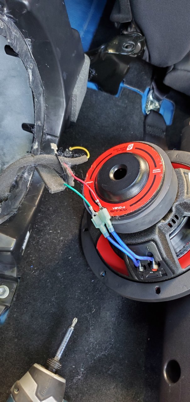

    I dont want to guess witch wires I hooked up and tell you the wrong answer. I will take pictures and post exactly how it is set up working in a couple hours.

    From amp red to positive and green to negative

    Installed

    My man, you are going to fry either that subwoofers voice coil or the JBL amplifier itself. That amp is designed to see and handle an 8 ohm load and you are running 2 ohms on it. It might sound good right now but you are on a beating time bomb (literally) if you continue running it that way. The OE amplifier is not a Monoblock which can run variable ohm load configurations on it like aftermarket Class D Monoblocks can.
    If you blow that amp, you are going to blow your ability to control volume control of the headunit both at the steering wheel and the headunit. You will be stuck with one volume if it doesn't kill the amp entirely and then you are going to be stuck in a situation where you have to replace the headunit, the amp, and all of your door speakers to aftermarket stuff as well as add in steering wheel control and JBL wiring turn on modules to power up your headunit and regain control of your steering wheel controls.
    It's gonna get ugly, that much I promise you. The OE JBL sound system sucks entirely, so my advice if you want to run a more powerful subwoofer and want better sound is to gut it all, but in the meantime while you save up (if you need to) to make the swap, my advice is either run stock stuff or run 8 ohm speakers and subs.
