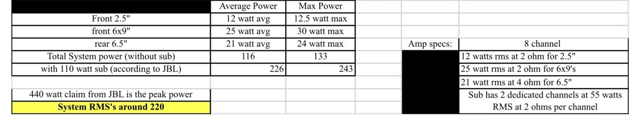

    Here's what the factory amp with jbl specs.

    Nice work trdtacoma and riotfunk! I was planning on fully changing everything but haven't decided what type of music I was aiming at yet. My last car had 2 rockfordfosgate p3s loaded in their enclosure. And last weekend I almost had enough with all these subs availability locally i almost put 2 12 w3s in. Head unit was gonna be halo9 but I guess pioneer is coming out with a 9 in display to give the halo some competition. As for speakers stick with some 2 ohm jbl gto's or some 4 ohm crap I dont know. What speakers do u like? I didnt want to let this thread down on sub selection for those who wanted to stay stock so I'm just sound deadening for now waiting for 2 more subs to show up in the mail tuesday

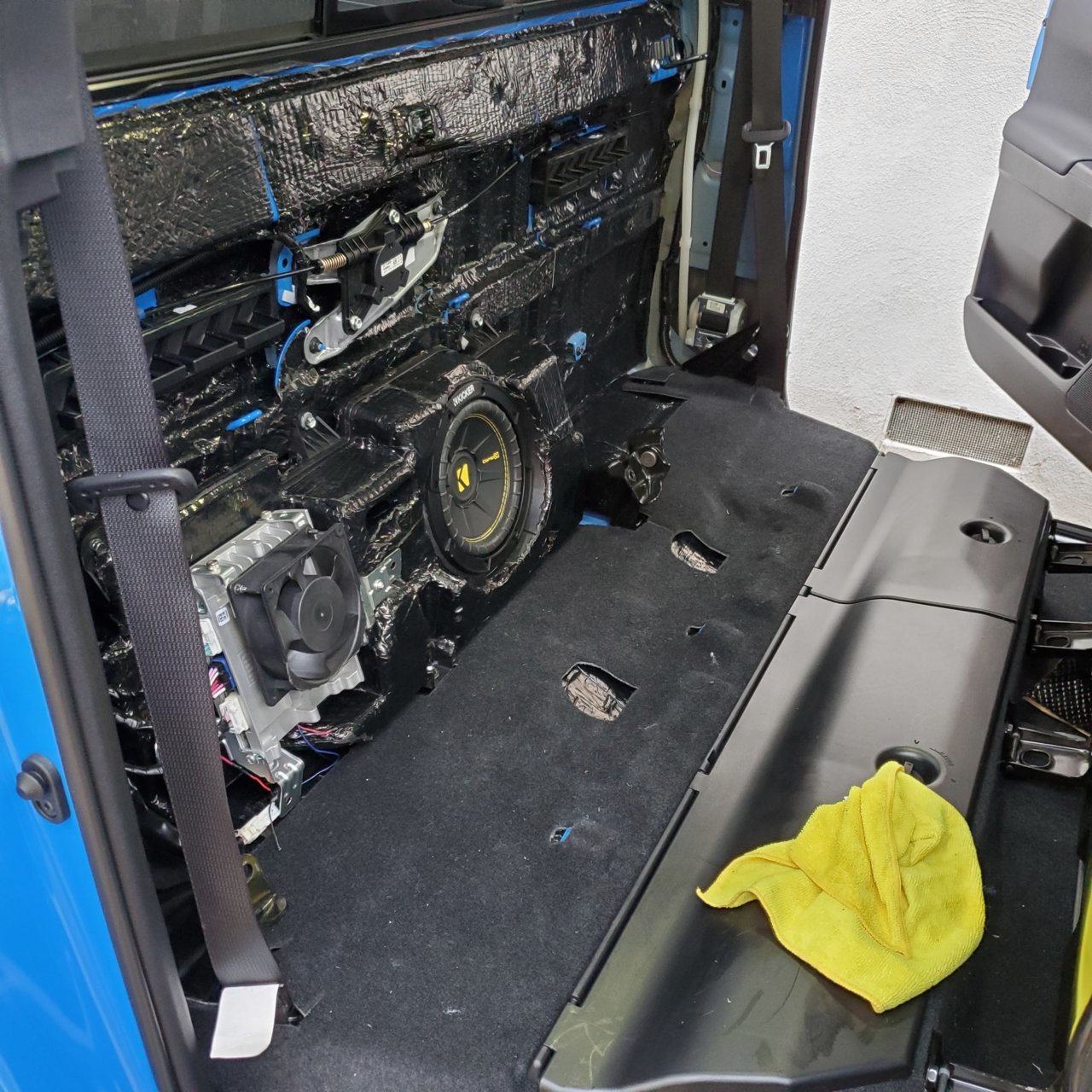

    I sound deadened the whole back of the truck and the exterior of the sub box. Put the cerwin Vega back in because the frequency is 34hz instead of the kicker at 40hz. The cerwin vega definitely hit lower. And finally put all the plastics back in and it sounds amazing. Left the fan on the amp still tucked behind the back plastic. So well see how it does. But it sounds really good with the sound deadening. Definite improvment
