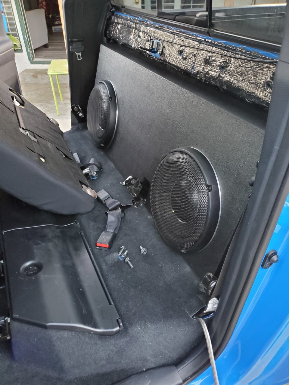

    So after reading that link I just posted. If the tweeters in the dash are wired are wired in parallel do the door speakers and all 4 speakers are indeed 2 ohm that would be a total of 8 ohm. So lowering the sub to 2 ohm instead of 4 ohm decreases the overall speaker load by 2 ohms would increase the volume like I initially noted when I did my subwoofer swap.and since the front door speakers are wired directly with the subwoofer that I verified when I tried to go to 1 ohm just to check if it was possible. This explains how i got more volume. Not double volume but there was a noticable increase in volume.

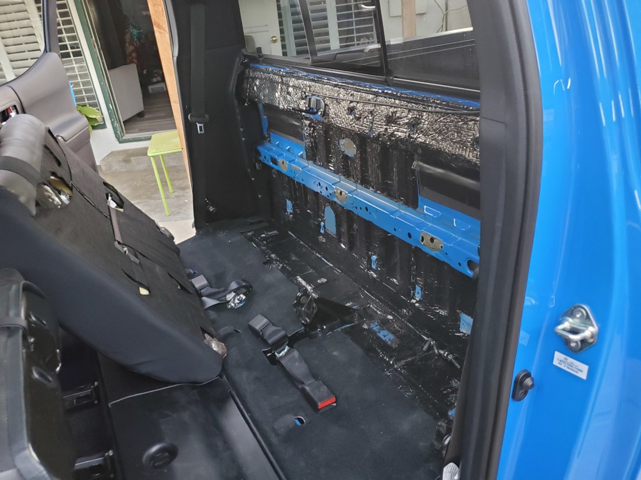

    I've been trying to find something on this for a while now and I hope I didnt just over look the answer somewhere else. I just put some subs behind my rear seats and I notice the vents on the rear wall behind the seats are making a lot of noise. From the outside it sounds terrible. The little rubber flaps are slapping against the vent itself making a ton of noise. Anyone have any solutions for this?
  5. Oct 22, 2019 at 3:30 PM
    #205
    Ysrracer151
    Ysrracer151 [OP] Okopipi
    Aug 2, 2019
    #300995
    195
    Nate
    Huntington beach
    Voodoo tacoma pro
    No easy option, those vents are necessary. And very sensitive to air pressure inside cab. I've seen people take the bed off to put stuff to block the sound and if you mess with the vents mlt opening your going to not like the results in the cab.I made my own
