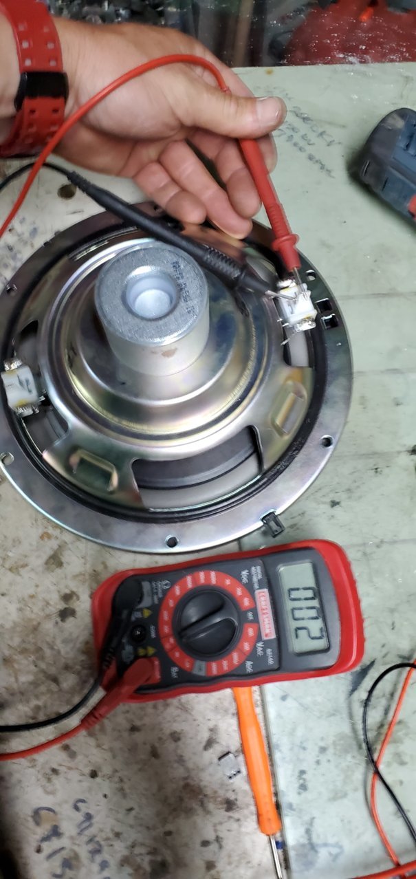

    I measured mine and I'll post a pic for u too its 2 ohm and .... it's not like it worked before right when I bought it. It's broken brand new so if it breaks then did I really break it? Cuz I was about to drop 2 grand for the alpine halo but this just changed my mind.

    2 ohm

    Pretty sure that impedance is a dynamic value...not ohms across a coil.

    Meters read DC resistance. Speakers are spec'ed in AC impedence. They're not interchangeable and any correlation is coincidental.
    Impedance, like resistance, is additive serially ie, two 4-ohm speakers wired in series looks like an 8-ohm load to the amp. Mostly. It's a bit complicated, because series-wiring a speaker will act as a low-pass filter to both speakers. Parallel speaker impedance, like resistance, is found w/ the formula:
    1/Rt = 1/R1 + 1/R2 ...
    It will be less than the lowest impedance device, guaranteed.
    Mismatched impedance results in non-optimal power transfer from the amplifier to the speaker, and can damage the output transistors of the amplifier if the amplifier is being driven beyond its power dissipation limits, which is tied to its load impedance. The transistors heat up during normal operation. If they heat up beyond their heatsinks' ability to dissipate that heat, the transistors exceed their max operating temperature and smoke will ensue.
    Mismatched impedance is not a problem at mid volume. Big problem at "11". Watch for magic smoke, keep an electric-rated fire extinguisher handy, and order 4 replacement output transistors from Mouser as spares.
    Or, get an amplifier rated for 3X the power your speakers require to produce your idea of Too Loud and enjoy that trash you're listening to. ;)
