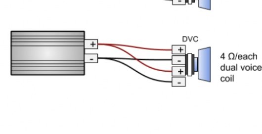

    OPs

    By the diagrams you posted the OEM setup would be a left right @ 4ohm or 1 channel parallel for a final resistance of 2ohm? The Spec for the OEM speaker and amp says it's a 2ohm system. What would be the difference between the two different installs if the OEM diagram was in parallel at 2ohm vs the OPs? Sorry, just trying to learn something on your dime. I'm also very interested in trying the OPs setup but dont want to waste money. * plus the CV is a dual voice coil at 4ohm wired parallel for 2 ohm internal. The OP might be at 1ohm no or just the same at 2ohm?

    If he was using a 2ohm sub than yeah would be a 1 ohm load that way bridged. I'd figure the oem amp would just thermal and shutdown at 1ohm due to heat and current draw. The factory looks like they're bridging it to run 4 ohm on the factory sub. It's a dual 2ohm voice coil wired to run at 4ohm. Which is fine on amp that's 2 as long as it's wired right. Less heat and draw this way from factory, probs why they do it. And won't murder the paper cone. It's a 2ohm amp so in theory should push his sub just fine. Haven't pulled mine out yet, but seems that's how they have it from the pics I've seen
