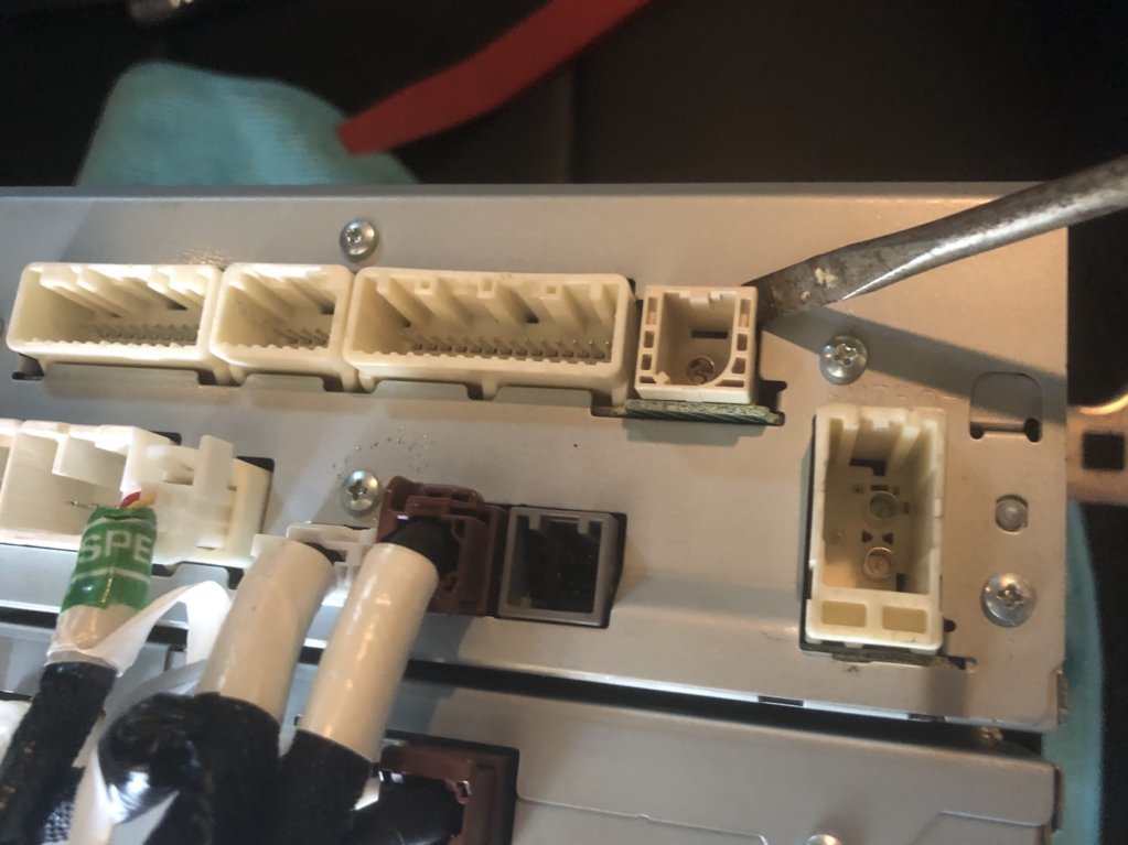

    Do you happen to know if this single port (top right from rear that I'm point at with a screwdriver) is the FM antenna, or if the dual port to its lower right is?

    The one to the right is the FM antenna.
    The one you are pointing at if I remember correctly is the XM antenna. I would need to see a picture of the plug but I'm pretty sure that is XM.
    When it was all said and done I just spliced in a standard XM plug into my aftermarket headunit to retain my OE sharkfin intact. Works like a charm.
    EDIT: Actually, that gray plug insert the XM. If the connector that mates up to it is blue, it is for the XM.

    I did the old try it and guess.
    My XM antenna is black and on the XM radio.
    My FM antenna is the lower jack in the double plug far right.
    The other 5ohm single connector (white) I can’t figure out yet, maybe the GPS antenna or perhaps the grey one is the GPS.
    My goal is to bypass the shark fin for FM. My assumption for my poor reception is FM is a vertically polarized transmission but the shark fins has to be a loaded coil so that presumes omnidirectional. While that does occur under many weather or environmental conditions, it is not reliable so the HD fades in/out as I drive.
    I now have to find a source for the proprietary connector so I can experiment with different aftermarket 1/4 wave vertical antennas like every car in the past 50 years had before the marketing people thought they didn’t look cool.

    Where does your blue plug, plug in at? That is where your XM antenna is.
    Let me know what you find because I'd like to get some sort of something better or be able to better supplement the FM antenna.

    My blue looks like one of the power plugs. I will figure this out and post it up. At current I’ve disconnected the XM connectors so the icon disappears since XM sucks even if it worked due to over compression.
