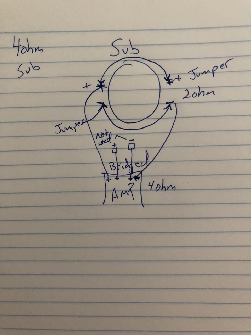

    Wiring like above will give an 8ohm load. Think higher ohm more resistance and less sound. 8 ohm is like a hallway and 2 ohm like a highway. More current(traffic) can go through. Here's my crude drawing for a 4ohm dvc sub wired to run at 2ohm6B1DAEBB-1F4C-47C5-B018-905C4FC76525.jpg

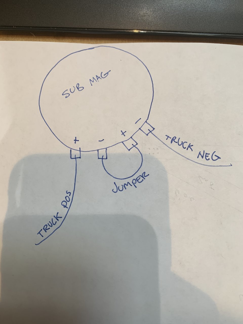

    :facepalm: I was in series rather than parallel.

    They oem sub seems to be running at 4ohm stereo, -/+ of one amp channel to left and the other -/+ amp channel to the right. Bridging creates a 2ohm mono channel. Amp pushes more power single channel. As to why the system itself is louder, maybe it doesn't have as aggressive dsp when it sees a different load applied. Just guessing on that part. Will pull it out tomorrow and play around.

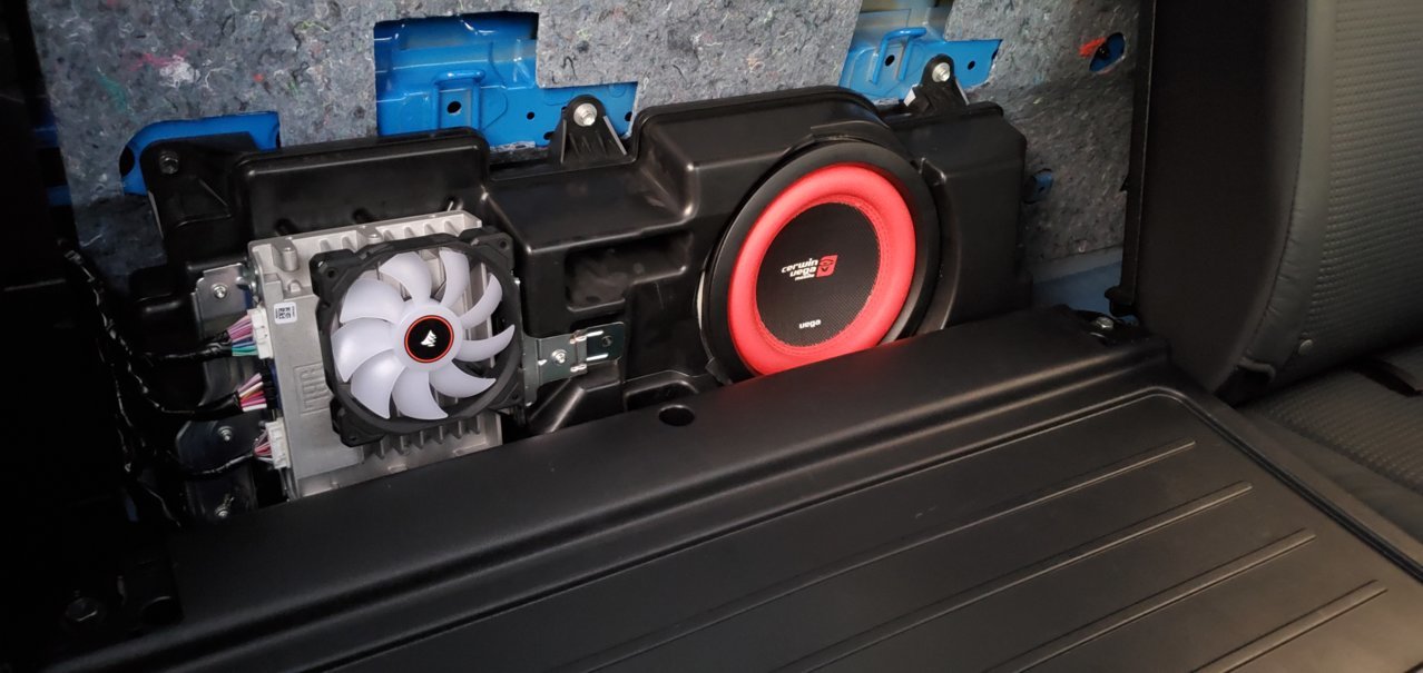

    Fan like this?

    Dont be confused. All of my testing was done without* a fan but added a fan and left it unhooked to see if it was nessessary

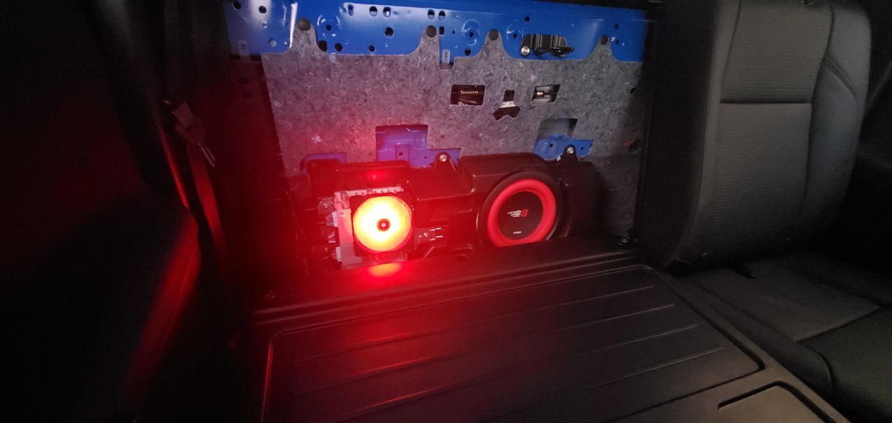

    I saw the red and was like holy fuck that's running hot. Fireball coming out the back

    What are you using the fan for?

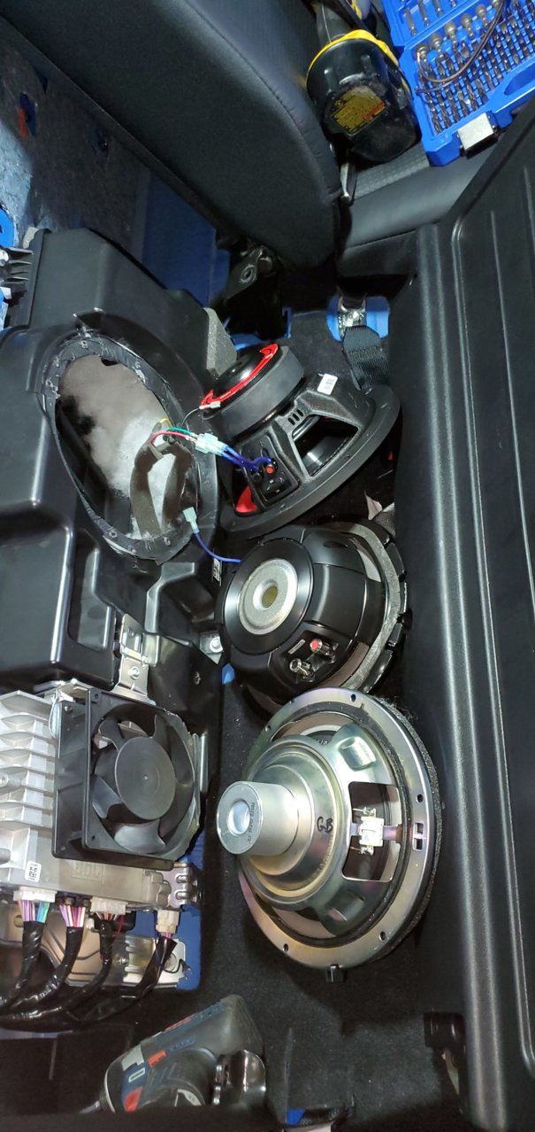

    Fan was first installed as a thought that the amp being buried behind the plastic was the culprit for the auto volume decrease. Since I had the back plastic off I tinkered with the sub and just ordered the pioneer shallow dual 2 ohm sub. Stock sub hit harder at low volume. Pioneer hit cleaner at high volume. But that didnt help by turning the volume up to hear the new sub the car turned town the volume rendering the new sub useless. The cerwin vega was alot more sensitive to the minimal output of the factory amp. And the wiring seemed to help channeling the power somehow* into the sub witch produced alot more output. Including the minimal polyfill. From what I learned today. That amp NEEDS a exterior form of ventilation or cooling. It is not a question. I got temps about 130 ° today and it started turning down. Hooking the fan up the amp was down to 98° in a couple minutes and full volume restored. I haven't had time to mess with the wiring too much yet. But I drove home from work and wanted to keep pushing the amp for testing purposes and simply had to turn it down. It was just too loud. So inferior sub and overheating amp. Door speakers and tweeters seem pretty legit and holding up well listening to edm and electro bass tracks honestly abusing them as hard as I can with the thought if they break they were already destined for the garbage can anyway.
