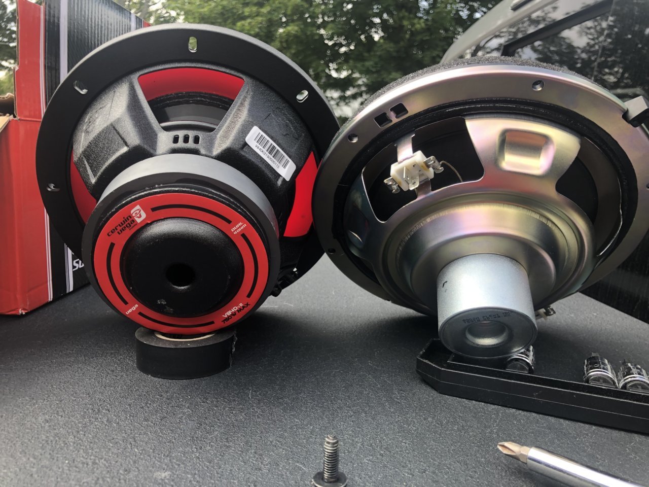

    I haven't found the stock sub box size anywhere so I had to measure for myself

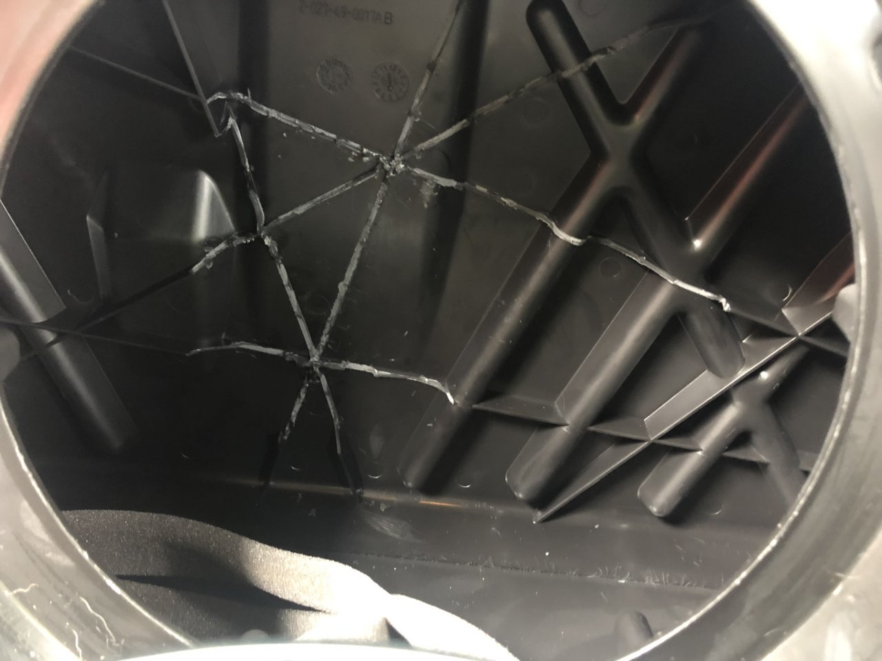

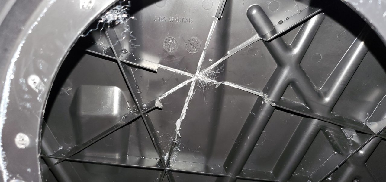

    Removed some of the ribs to fit the magnet and maximum 4.4 mounting depth

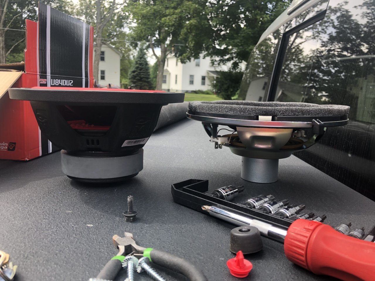

    No idea how you got the CV sub to fit. Still bottoms out on the back. Just too deep to fit in my truck. 1/4 "gap. I'd need to make a mounting ring for a spacer. Because the front is sloped on the box. Oh well

    @Riotfunk You removed the ribs in the back of the box like the OP? Very interested to see what your findings are with this one. Looking at the OPs pic I that shows screw holes, if the gap is 1/4" or less I wonder if he just pulled the front of the box out with screws and his magnet is bottomed out? That or his magnet looks different then the ones I see online. Is there a cover that you can remove?

    Yeah. There's the big molding ribs to the side that can't be removed without destroying the box. There is literally no way for this to fit. Magnet too deep and too wide, hits the back of the box and that big rib to the right

    I'm assuming OP just zipped it down with the screws. A shallower sub will fit, this CV will not

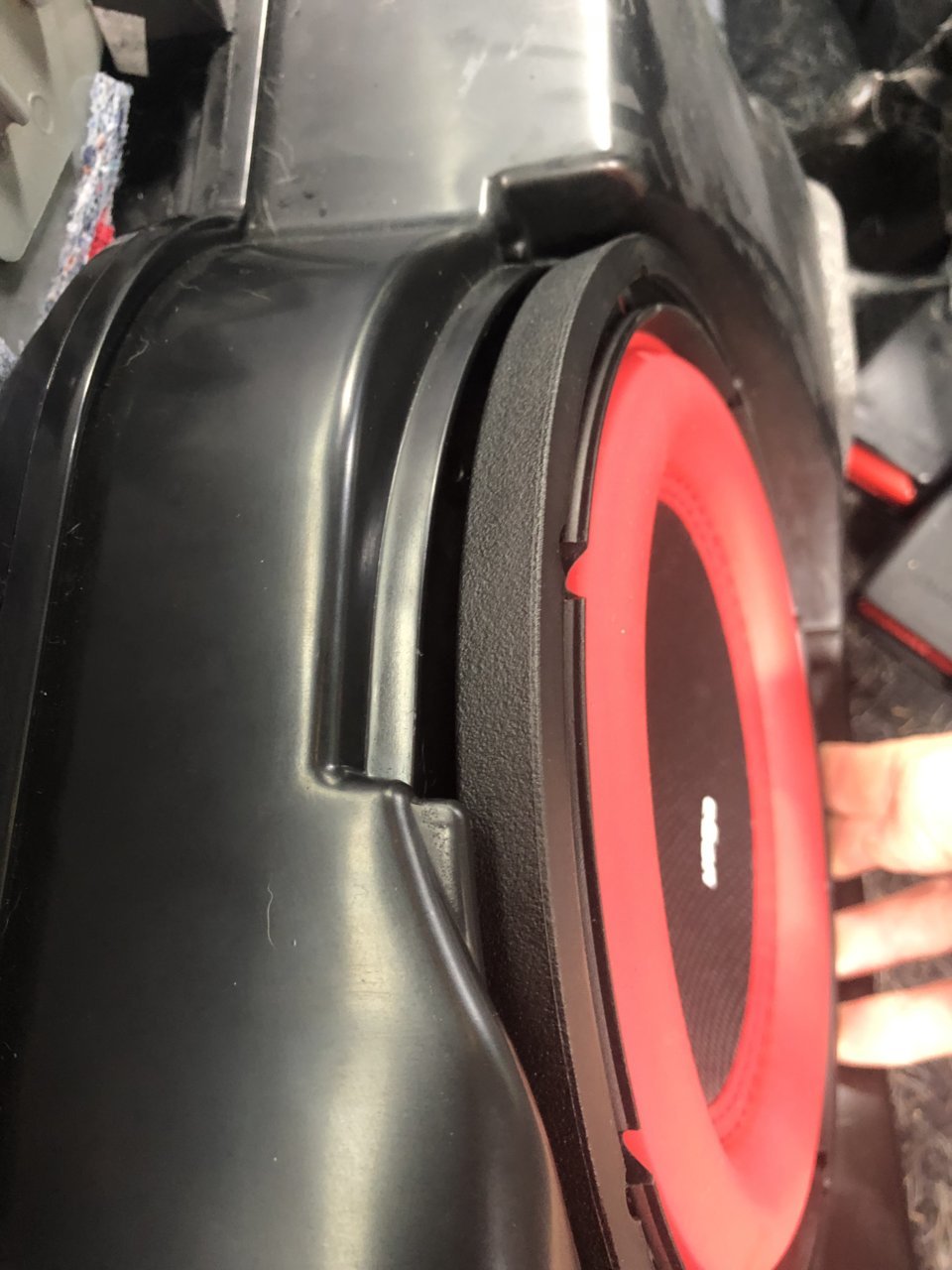

    what about a spacer for the sub to seal the enclosure?

    Only way to fit it. But then would hit surround on the oem speaker grill. 4" would be max sub depth I'd put in there

    U gotta use foam or rubber between the sub and the box that filled that gap per instructions? I used the thickest black rubber sealing tape I could find at home depot. The box is just plastic so it will give a little too. That was why I put max depth 4.4 cuz literally that's max. I wish you would of herd it. It's weird tho i talked to the cerwin vega mobile dude and he said sealed is best. But when i just put the top screw and the sub was not all the way flat like basically leaving room so in a sence its ported it resonated so much i was gonna see about either mounting it that way with a spacer or porting the box. I tried neither... i did find "the sub" direct replacment. Infinity flex 4d I was gonna buy one today. Maybe someone else has already tried it? It states it was designed exactly for oem fit applications.
