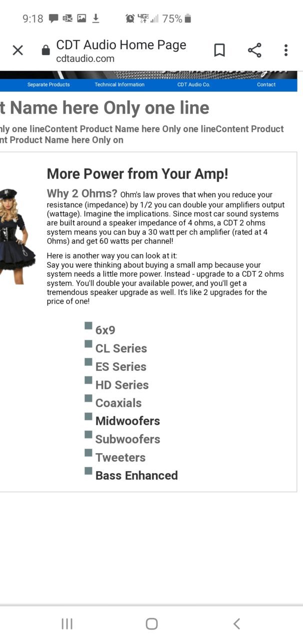

    Trying not to plagiarize but

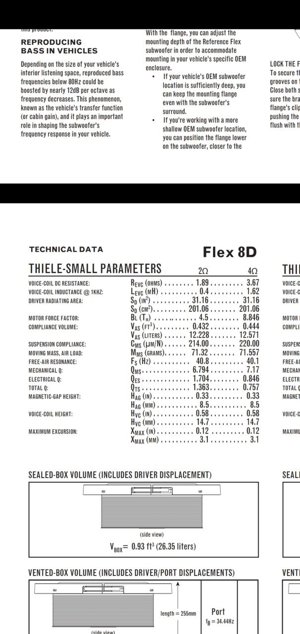

    Infinity flex 8d looks okay to with the freq at 40htz and sensitivity at 84db but the ohm looks the lowest I've seen yet. At 1.89 and 3.87 in the 4 ohm version that would be a better candidate wired down to 2 ohm. But freq. At 40 playes better rock music. Or highs. All of this homework is tiring.

    Cdt audio I have not tried yet but it's not rocket science.

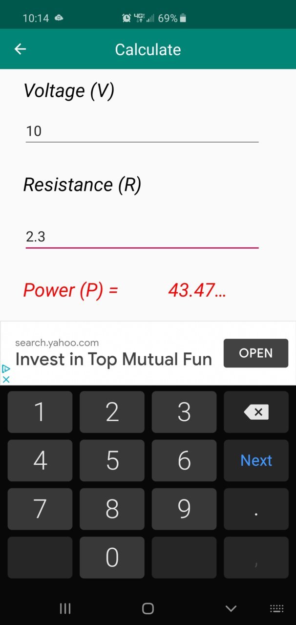

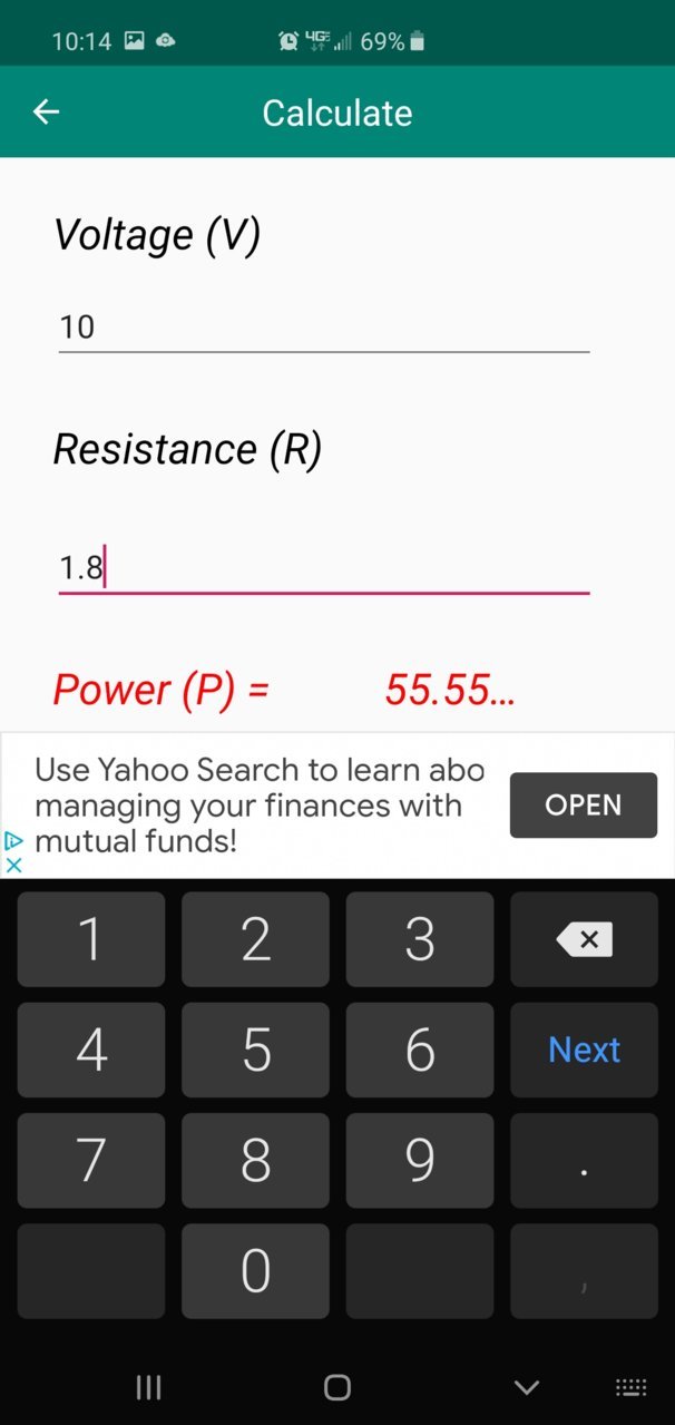

    Found a calculator in the app store to help people figure out how specific resistance translates to power. 43.4 to 55.5 is a dramatic increase in output!!!

    Your amp only provides so much power regardless of speaker ohms and can be damaged by going too low.

    Very true statement. But we are talking about the same 2 ohm speakers, just variables in quality control of the actual 2 ohm measurment.jbl stock is 2.3 and aftermarket is variable 1.8 to 2.3 depending on brand and speaker. This affects output. This is not a topic about wiring down to 1 ohm. Simple speaker decisions

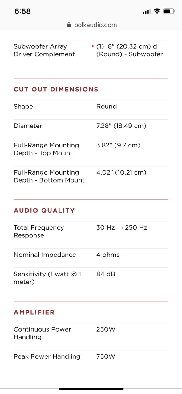

    Im gonna order a low pro polk sub. Try that next week or so. Post that up when it comes in and let you know.

    What is the Polk sub what are its specifications?

    Db842dvc
    Similar to the CV spec wise, but shallower mounting.

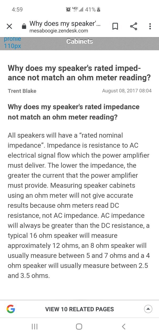

    I tried not to albert einstein with math basically making it easier for someone to understand for someone not familiar like myself with audio as most people. So albert einstein away and explain the difference in speaker resistance. And why 2 of the same vehicles coming out of the same plant have vastly different sound output

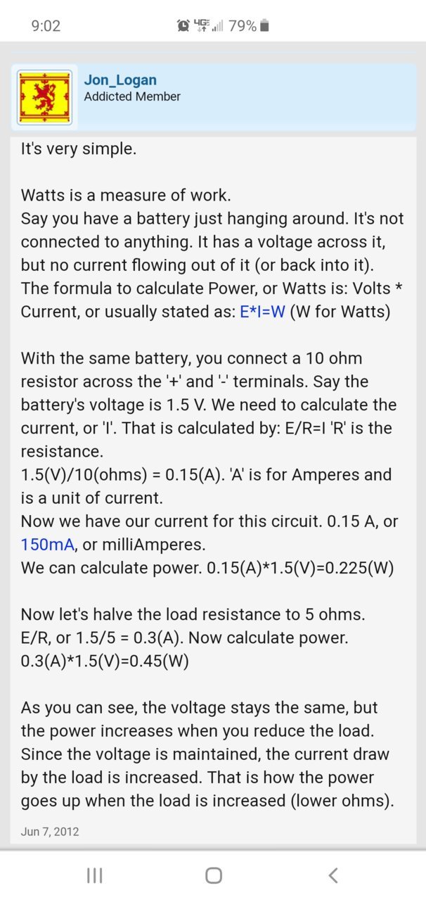

    Pretty sure this whole part was about sensitivity
