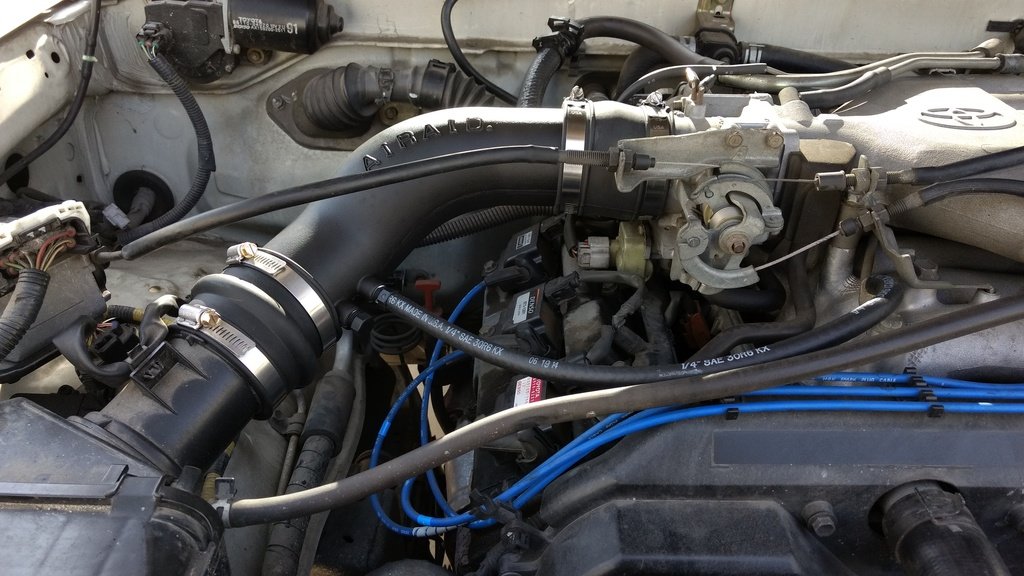

    My oem intake tube developed a growing split near the throttle body, so I replaced it with the AirRaid intake:
    Much less than a factory replacement, but still a pain in the ass to put on! Nice to get rid of the box that blocked the coil and first injector though. Comes with a CARB sticker for us CA people.

  2. Mar 21, 2017 at 3:48 PM
    rskoncepts
    rskoncepts Member
    Feb 8, 2017
    #209990
    10
    2004 Tacoma Prerunner 2wd
    Agree that looks a lot nicer. May I ask what made it difficult to install? This is something I may want to also do.

    Like the oem unit, when this is assembled it's longer than the distance between the throttle body and the MAF housing; this requires some patient pushing and pulling on the flexible end couplings. If you are patient, it won't be as much of a pain!

    What did that metal box on the intake do anyway? I removed it completely when I put in my K&N CAI.

    The box is a resonator to address noise from valve or intake pulses.

    As phoenix ray says, it acts as a resonator to the air flow, and catches stuff from the PCV valve. I have not noticed any extra noise though.
