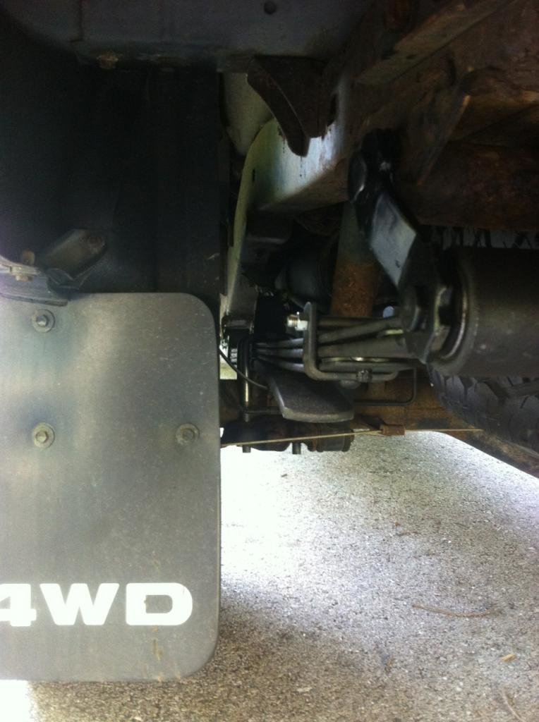

    your shackle angle looks way off then what i would think it would be with those springs. they look well beyond 45deg. do you have a side shot of those shackles?

    They do look back a little bit...but if they are bolted into the front, maybe that is just how it lives? :notsure:

    That's what I was thinking. If he said it's good though, then keep rocking it. I'd probably be looking at throwing some paint on there at least.

    The rust on the rear of the frame is just surface, trust me when I went under there I freaked a little bit too! But I took a hammer to it and also last year the bed was off at a Toyota dealer to have the spare tire winch replaced, and it looked solid and the Toyota guys said it looked good. I have contacted Toyota in regard to getting it inspected, and making sure I am eligible for frame replacement in the next four years if need be.
    I will look at the shackles after work today, however yesterday they were at 45 degrees. But they do look 45 degrees in the pic to me, the pictures aren't very good because I took them right behind to the shackles lol. I will look at it today and post some pics!
    After driving through Baltimore for the first time, and the first longer distance trip I have gone on since putting them on, they ride well and a huge improvement over my previous springs.

    Hey guys, so after a few more days of driving on it I have found that the springs work well. The shackles are at 45 degrees, and the leafs look the same as the previous pictures, the truck sits alot higher than it did before, a little bit of rake going on. The truck is exactly where I want it to be ride height wise, and the taco lean I had going on before is gone. The only thing I have noticed is the truck shakes a little bit when going around 75mph. But I think its because the springs are literally brand new. Anyways thanks for the help everyone!

    Hey guys after two weeks of new springs, I have found that there is a vibration at 70mph +. I have also found that the drivers side overload spring is not in alignment with the rest of the leaf pack. It is rotated a couple degrees. How would I go about fixing it? Would I have to take the u bolts off and loosen the pin, get them back in alignment and then tighten them?

    As shown in this picture from earlier the overload is out alignment, I wish had caught this sooner.

    Tap it with your BFH if it bothers you that much

    The overload is a lot more shifted than that picture. I did try whacking it into place... Looks like I'll be taking it apart this weekend

    it will just misalign again after driving a while. The only way to keep it aligned is with some kind of spring clamp. It shouldn't misalign far enough to cause any problems or not work properly. The ubolts will keep it from moving too much. If it bugs you just hit it with a hammer from time to time to line it back up.
    Also, check the torque on your ubolts. It's common for them to need to be re-torqued after a week or so after being installed.
