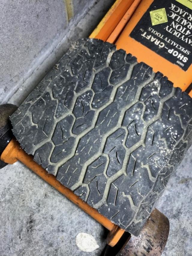

    However cutting an old tire makes a very good jack pad to reduce any potential damage or risk of slippage.

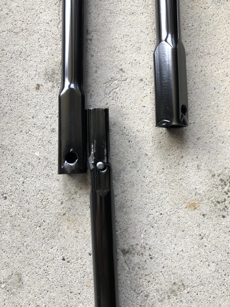

    I figure this is kind of related....anyone replace the oem jack handles that seem to get destroyed when you drop the spare?

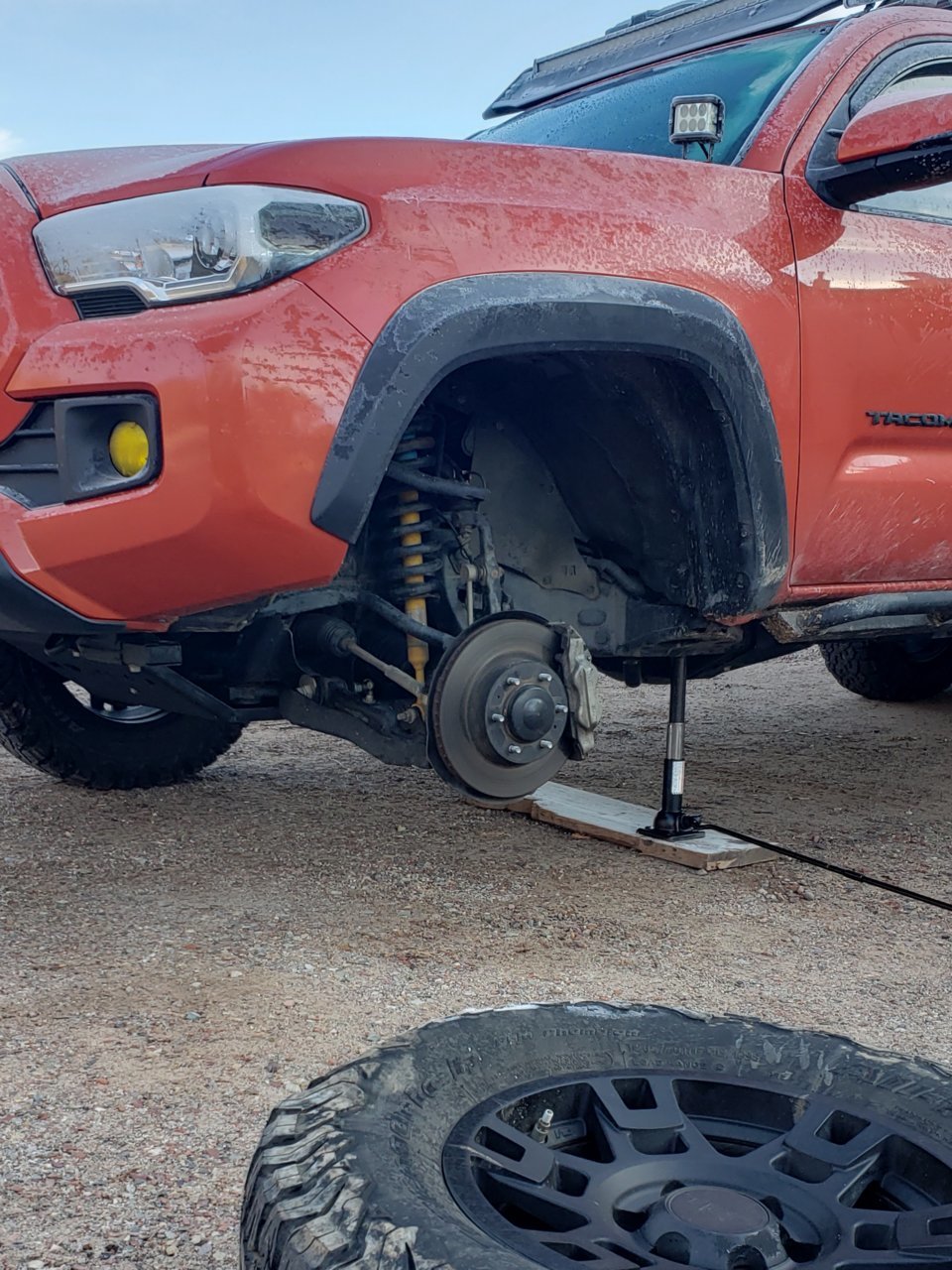

    The stock jack works perfectly fine for changing a tire. Getting an extra one would be nice though but it definitely doesn't need to be "changed" out. Pic is from last fall when we woke up in the morning to find it completely flat and off the bead from a 4x4 trail. Ended up being a razor blade.

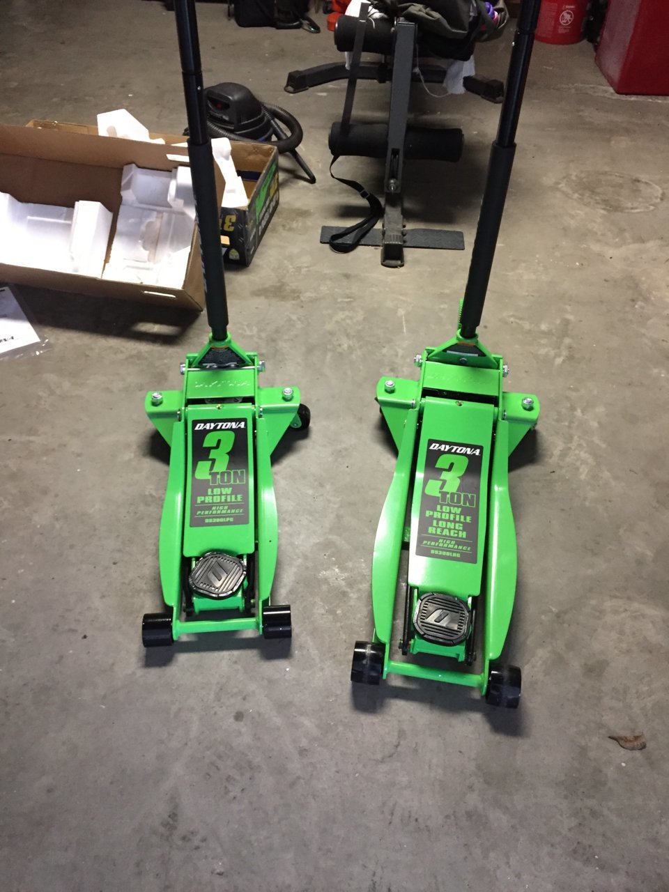

    I keep these in my shop but they could easily be used on the trails. They are heavy. The larger one is around 95 lbs and can lift around 24”. The smaller one is around 70 lbs and can like 21”. Both from Harbor Freight and both are quality jacks. I think they are knock off Snap-on jacks.

    apparently snap on did have a lawsuit against harbor freight for these jacks. my buddy told me, (toyota/lexus mechanic) who has the snapon one, paid like an arm and leg for it, said it was a clone. Having said that- i have this jack too, its nice haha.

    This is a great idea. Stealing it to make it my own.

    I was just looking at these today actually. The extra lift of the long reach seems cool, but 100 lbs might be a deal killer. (I dont have a garage yet, so Id have to lug it up from the basement every time I need it :rolleyes:)
