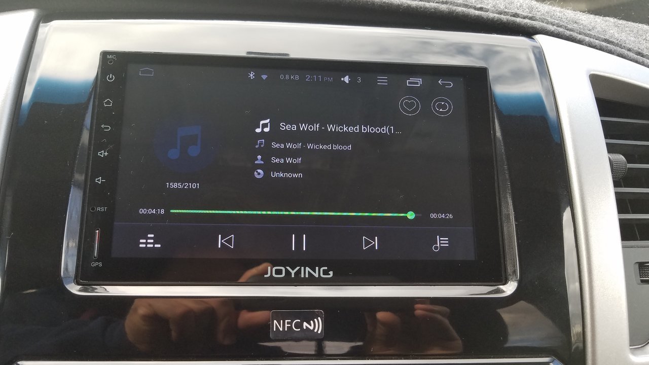

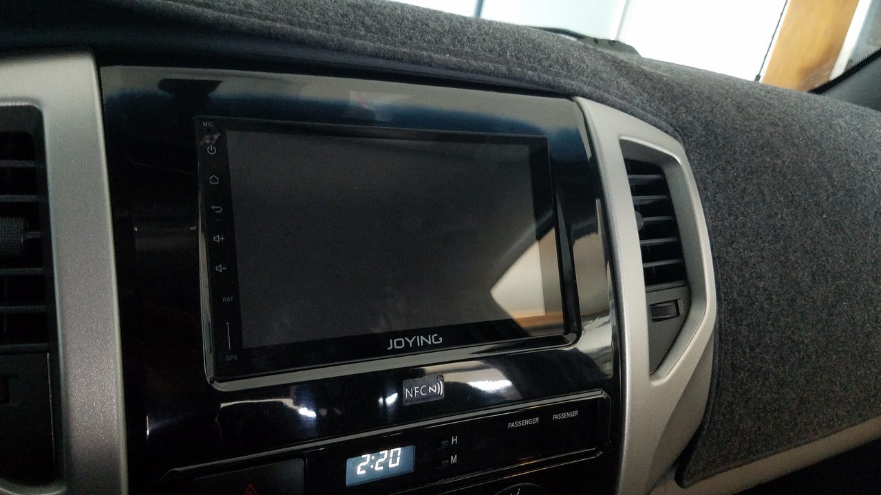

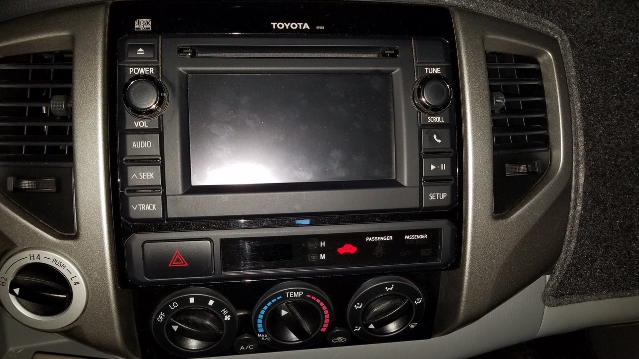

    Out with the old stocker (non-JBL, no-GPS):
    In with the new:
    Am I happy? :cheers:
    Total invested was under $400:
    Head unit Joying PX5 Octacore Processor, 7" Display, 2GB/32GB, JY-UM128P2: $276
    Scosche Dash Kit TA2111BPB: $47
    Toyota Hilux Harness: $17
    1st USB port AXXESS AX-TOYUSB adapter cable: $10
    2nd USB port: Xtenzi USB and 3.5mm A/V rectangle panel jack cable for Toyota: $20
    OBDII Scanner Bluetooth Tool w/ Torque Software: $20
    What I got:

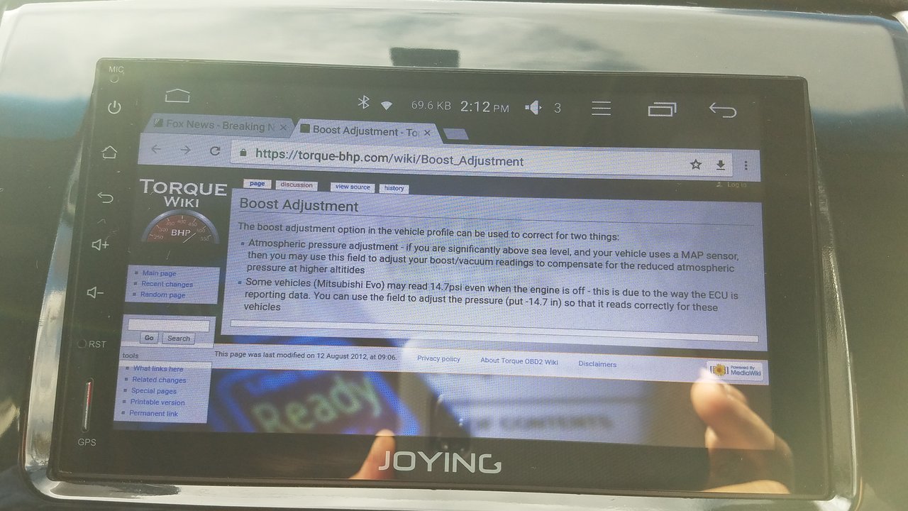

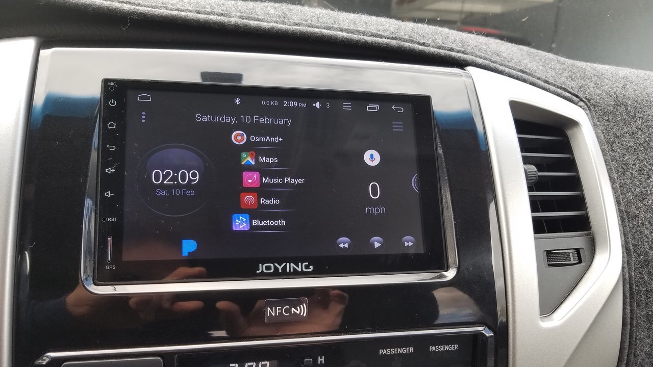

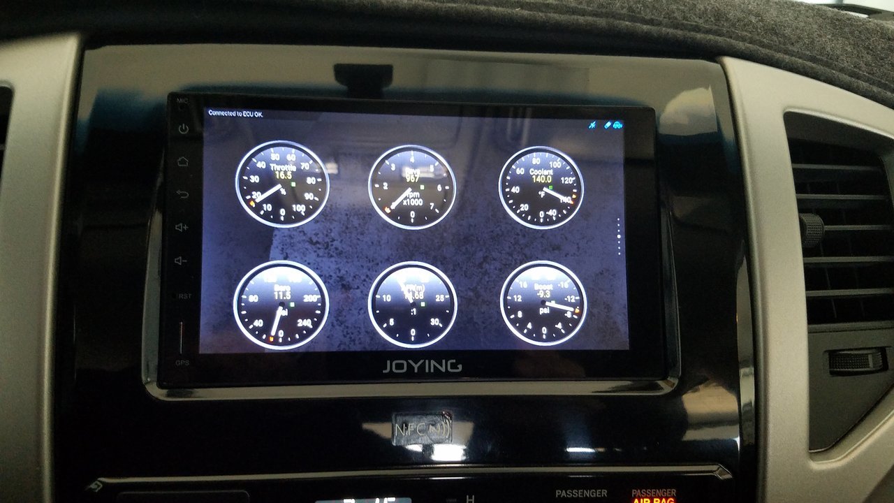

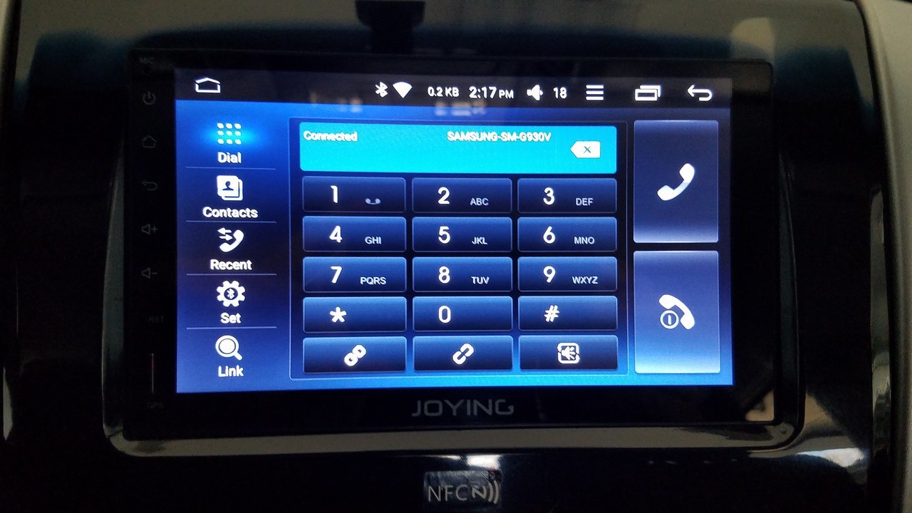

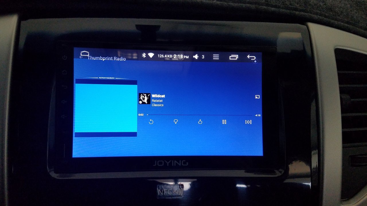

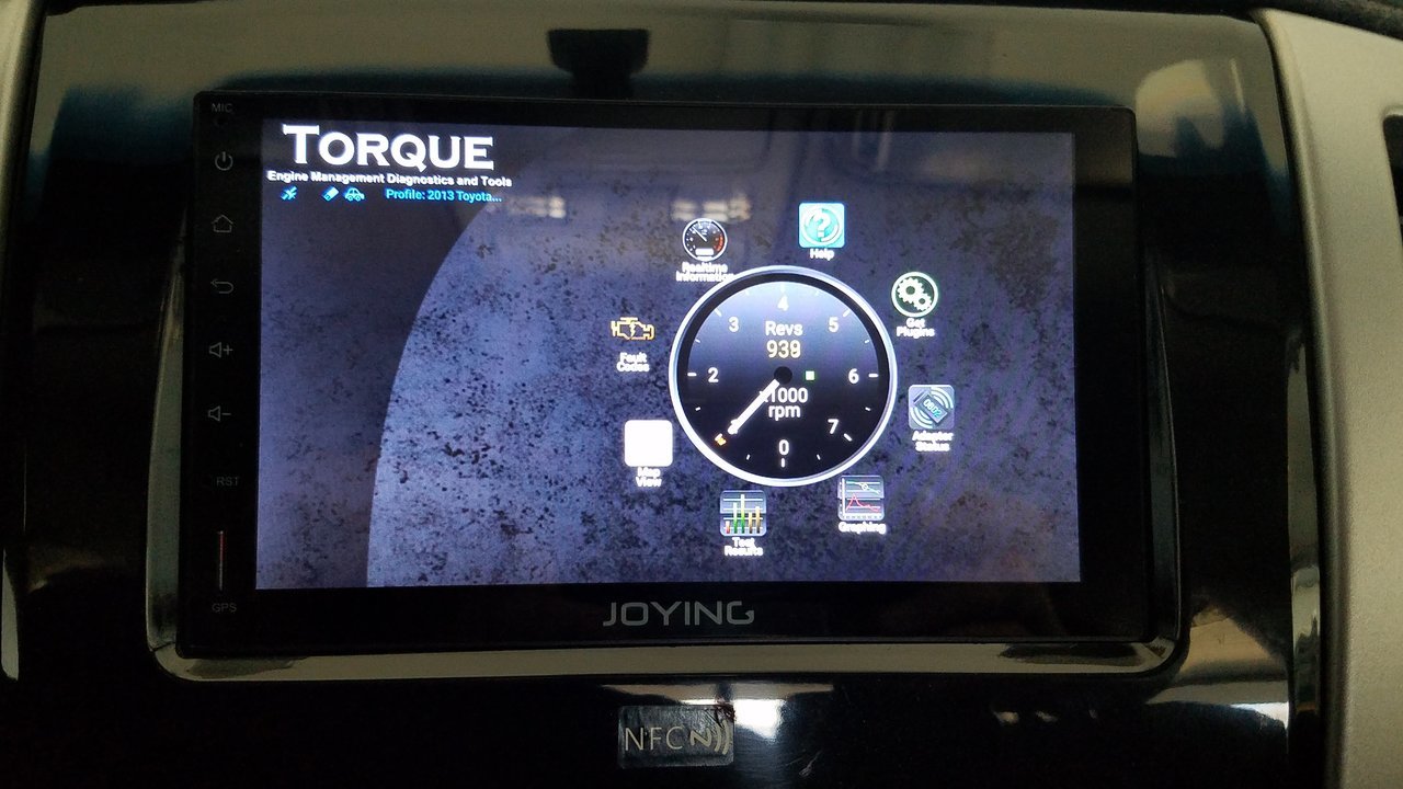

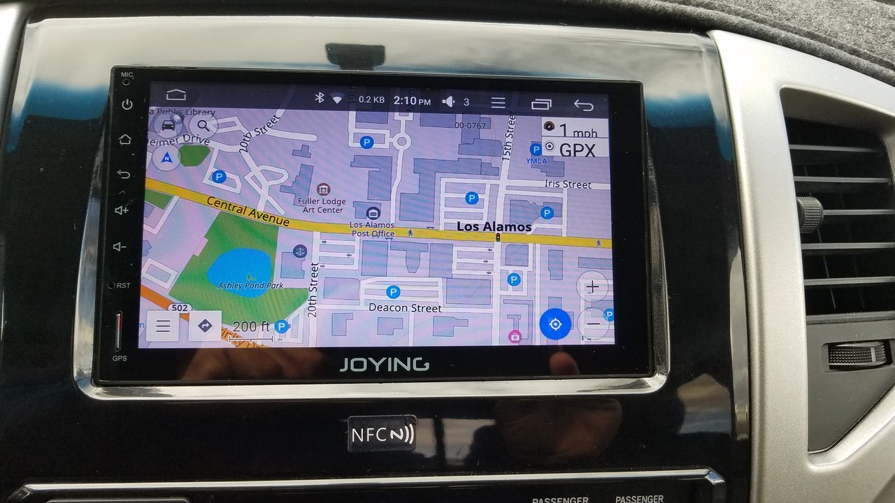

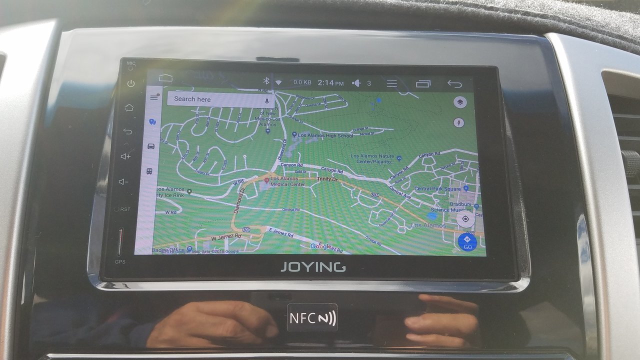

    All in all it does everything I want it to do. Parked in my garage, I use my home wifi. On the road, I use my phone as a mobile hot spot, and my unit for phone calls, music, gps navigation, I can watch movies, surf the web, diagnose codes with OBDI, ... All my steering wheel controls work as before since the unit automatically learns the buttons on the steering wheel.
    one more thing...I tapped into my backup reverse camera. That works too. It now displays on my head unit and the rearview mirror.
    Biggest headache was getting the unit to fit in the dash kit. The dash kit is too small by a couple of millimeters in width, and slightly too small in height by 0.5 mm. I actually had to have a good friend of mine mill it out to make it look clean.
    I am happy given the price point for a full Android unit.

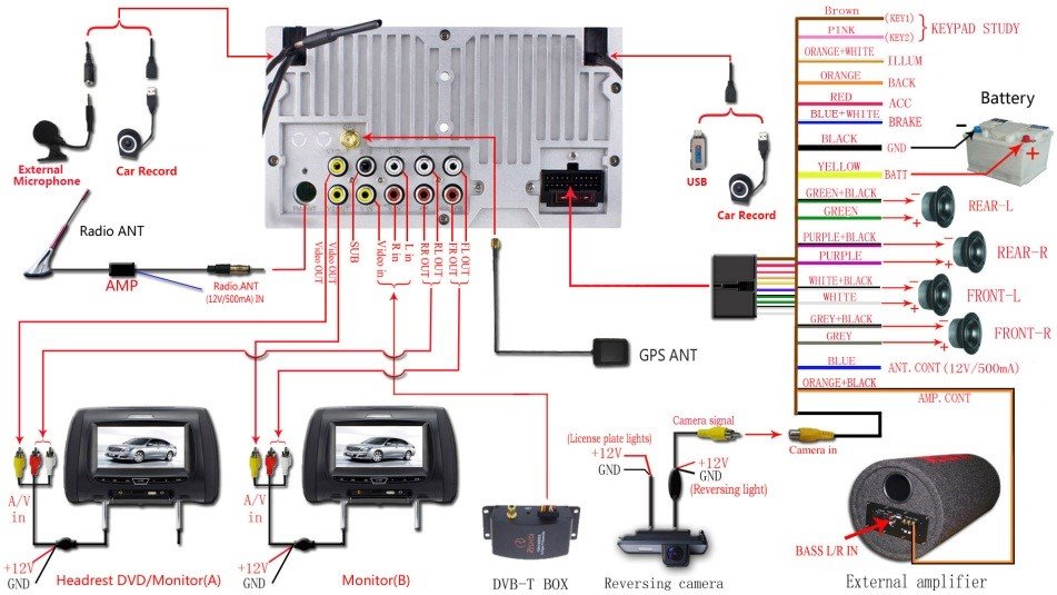

    Yes, it works with the steering wheel controls. The unit has a learning mode that is simple to program to the unit. So there was no other hardware to make it work. The Hilux harness is perfect and attaches to the existing connections in the truck. Yes, the wiring harness has all the steering wheel wires in it...it is called the "keypad study" in the last image I posted.

    The one I have has gorilla glass like touch screen; it would probably better if you get the 4GB version that just came out. As for as bluetooth music streaming from the phone, it has been reliable for me. I, however, have put most all my music on the SD card slot it came with. That has been rock solid.

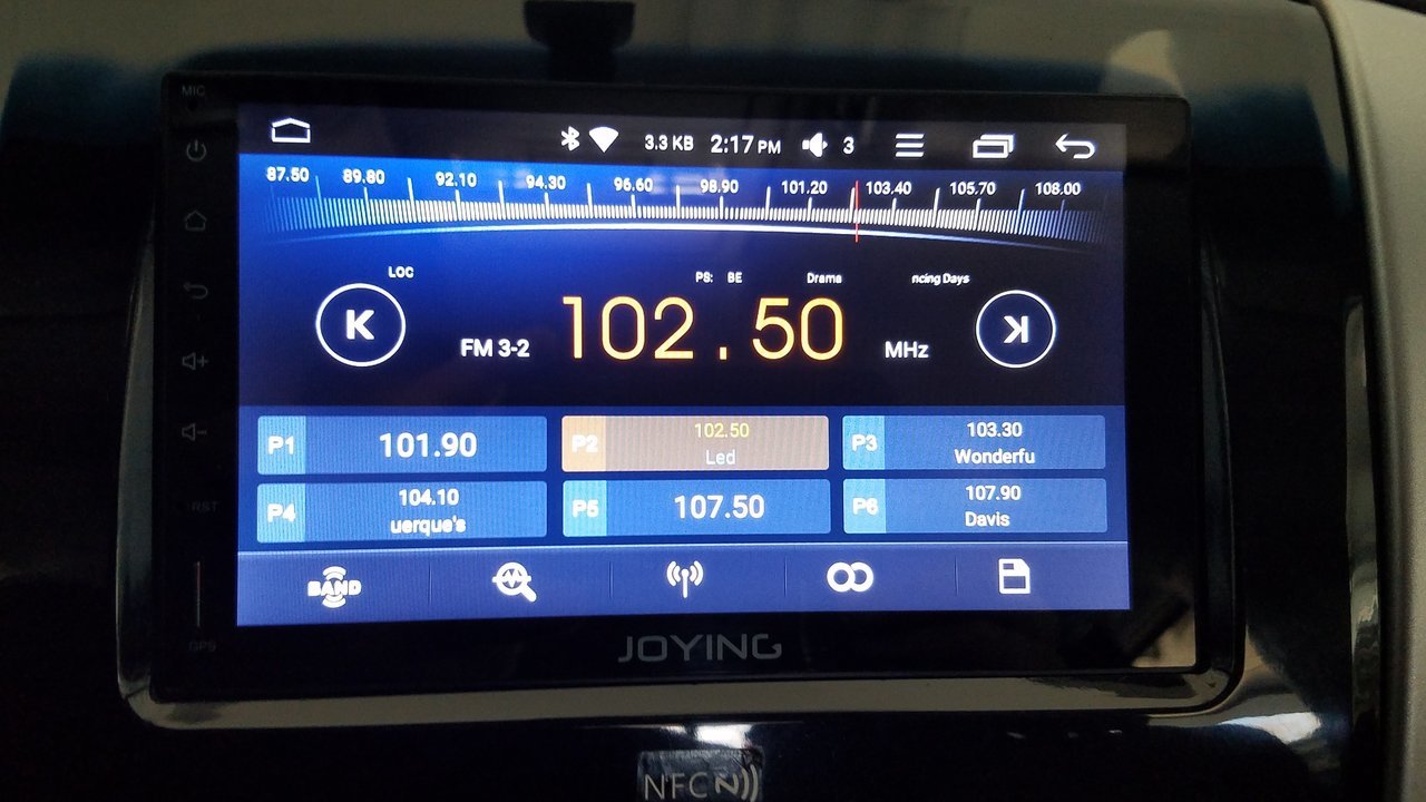

    I have an older Joying HU, my main problem is the crappy FM reception. How's the FM reception compared to the stock HU? Mine is so bad that I don't even listen to the radio anymore. Most other features seem good though.

    The FM reception on my Joying is on par or equal (not better) to the reception I had with my stock radio. I live in mountainous area with line of sight direction to most of the radio stations where I live come from Albuquerque which is 90 miles away.

    The Hilux wiring harness greatly simplifies the mating of the truck's connections (by using the existing connectors on the truck) to the head unit. Otherwise you will have to be making your own soldered quick-connect connections. IMO, buying the Hilux harness is worth the extra $17 to save the headache of making your own.
  19. Mar 21, 2018 at 8:46 AM
    #19
    Atomic
    Atomic [OP] Master Cylinder
    Dec 30, 2013
    #119478
    589
    New Mexico
    13 TRD Sport Double Cab Long Bed
    on the Hilux harness the steering wheel controls (two leads) are labeled Key1 and Key2. You also have to have a headunit that allows for the controls to be programmed on the unit. Pretty easy to program the head unit to learn the controls.
    https://www.joyingauto.com/joying-toyota-hilux-android-car-radio-cable.html
