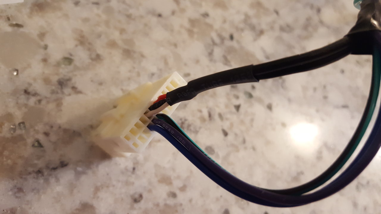

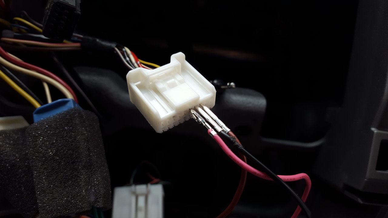

    I got it wired up today! So nice to have the controls back.
    I did have to change the large wide plug from the hilux harness to the other one that matched the truck harness i had previously. Not sure if this was due to my 2010 or what. 20180406_174944.jpg 20180406_173015.jpg
    Thanks again!
