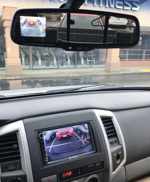

    Decided to tap into the backup camera today, I got impatient. It took 30 min, max. Works great. For reference, the joying harness says "BACK" for the reverse trigger. I used this thread for reference:
    https://www.tacomaworld.com/threads/oem-camera-connection-below-dash.30889/
    The backup camera now shows up on the mirror and headunit when in reverse. Joying gives the option for guide lines and also to mirror the image in case your image doesn't come up correctly. My photo below is before I turned off the lines and image mirror.

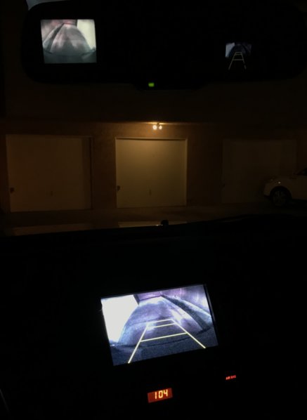

    One more for good measure
