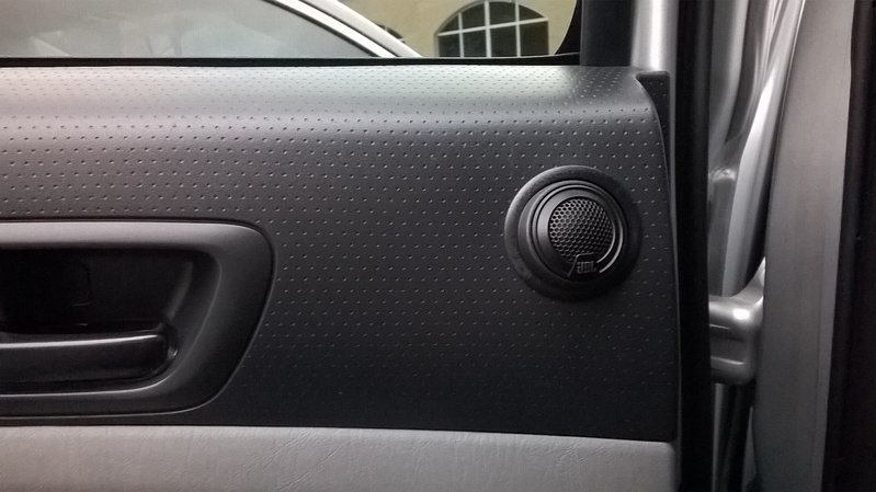

    OK here goes. 1st I didn't go for any fancy installation. Just simple, clean and hidden for the most part. Good quality equipment. And like I said I have not done any sound deadening yet. "No pic of the HU as you already have that" Also I didn't go after JBL speakers just because Toyota uses them it just worked out that way.
    (JBL emblems on door panels "bottom" Ebay or Amazon ??? Cant remember $8-$9 (I think)

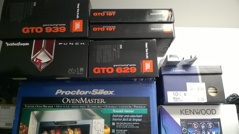

    Pic of the boxes everything came in.

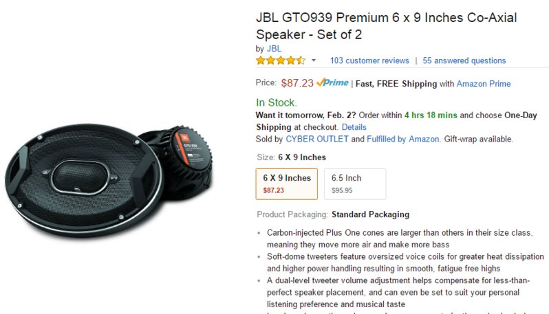

    Front door Speakers

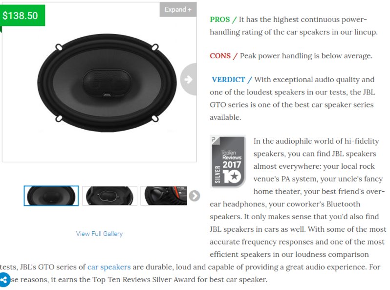

    JBL GTO 939 Premium's. I had Kenwood's and Pioneer's. Done the research and these popped up'ed almost everywhere as "Top Rated" These by far sound the best. Remove the factory speaker "paper" from the actual speaker housing and you can use it as a mounting bracket! And install in place of the factory 6X9. Worked on all 3 Brands.

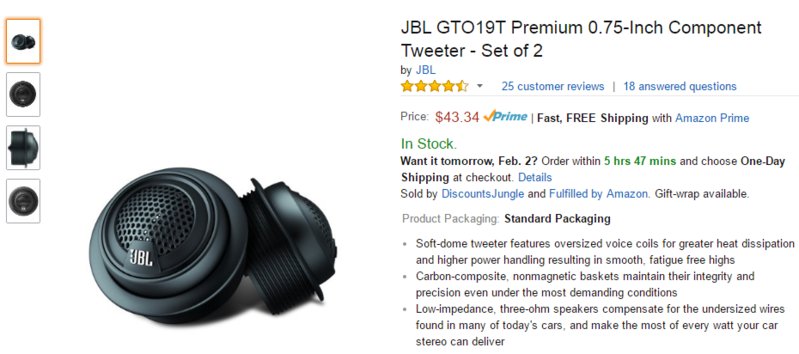

    Tweeters are a pair of JBL GTO 19T's. Just remove the factory Tweeter, use a hole saw (drill) to cut a hole in the factory tweeter grill and install with the supplied nut on the back. Super easy . These also swivel in any direction. Takes longer to get the door panel off than to do the installation.

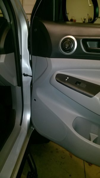

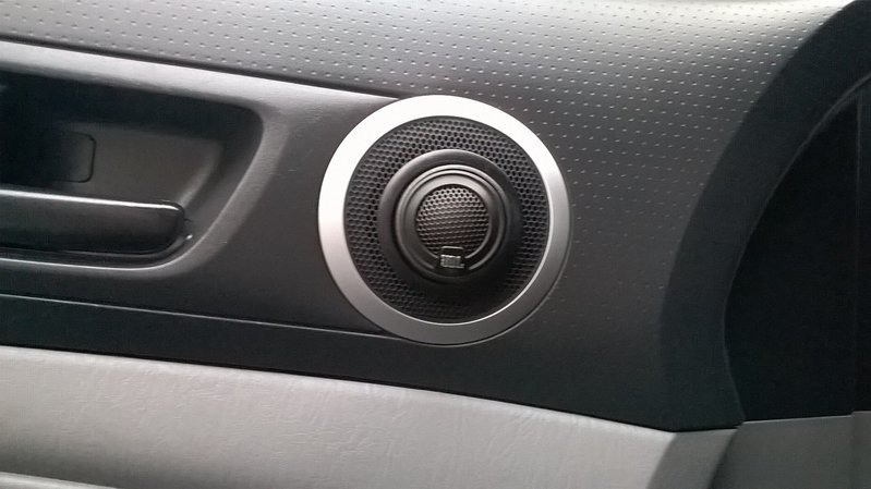

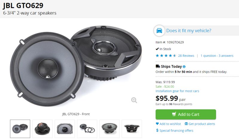

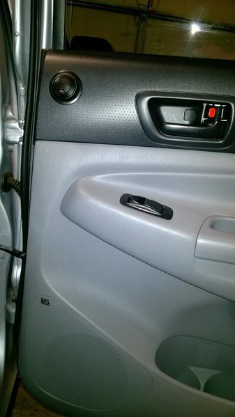

    Rear doors
    JBL GTO 629's Premiums. Simply bolts in place of stock speaker.
    Tweeter same as front door. Same installation but in the door panel itself.

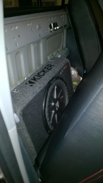

    is a Kicker Comp RT 12". Not my "Top Pick" but got a good deal and does sound descent and fits behind my back seat with only removing the plastic tray / Liner. I do plan on adding sound deadening / Insulation here.

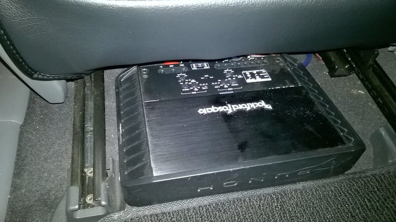

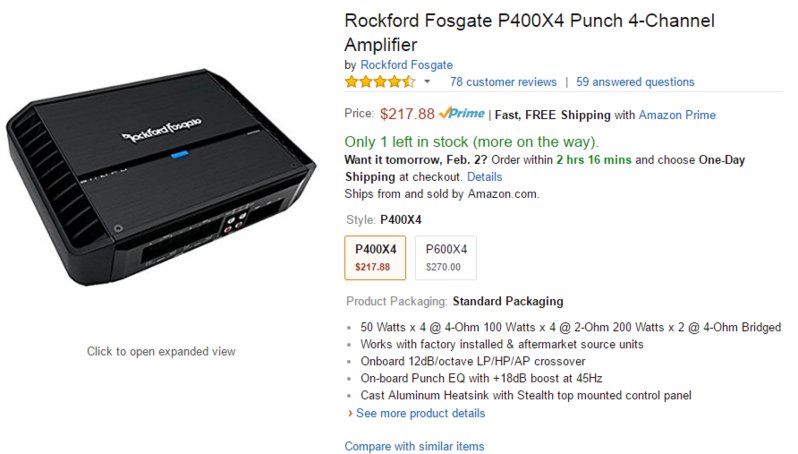

    Amps Rockford Fosgate Punch P400's (2) "one under each front seat" One is a P400/4 4-Channel driving the door speakers and the Tweeters. And one P400/1 Single Channel driving the Sub. Both are rated at 400 watt respectfully. But as Rockford never overrates there amps. They send a Birth Certificate "test sheet" with all new amps. Both tested at over 600 watts.

    Better pic of the Tweeters
