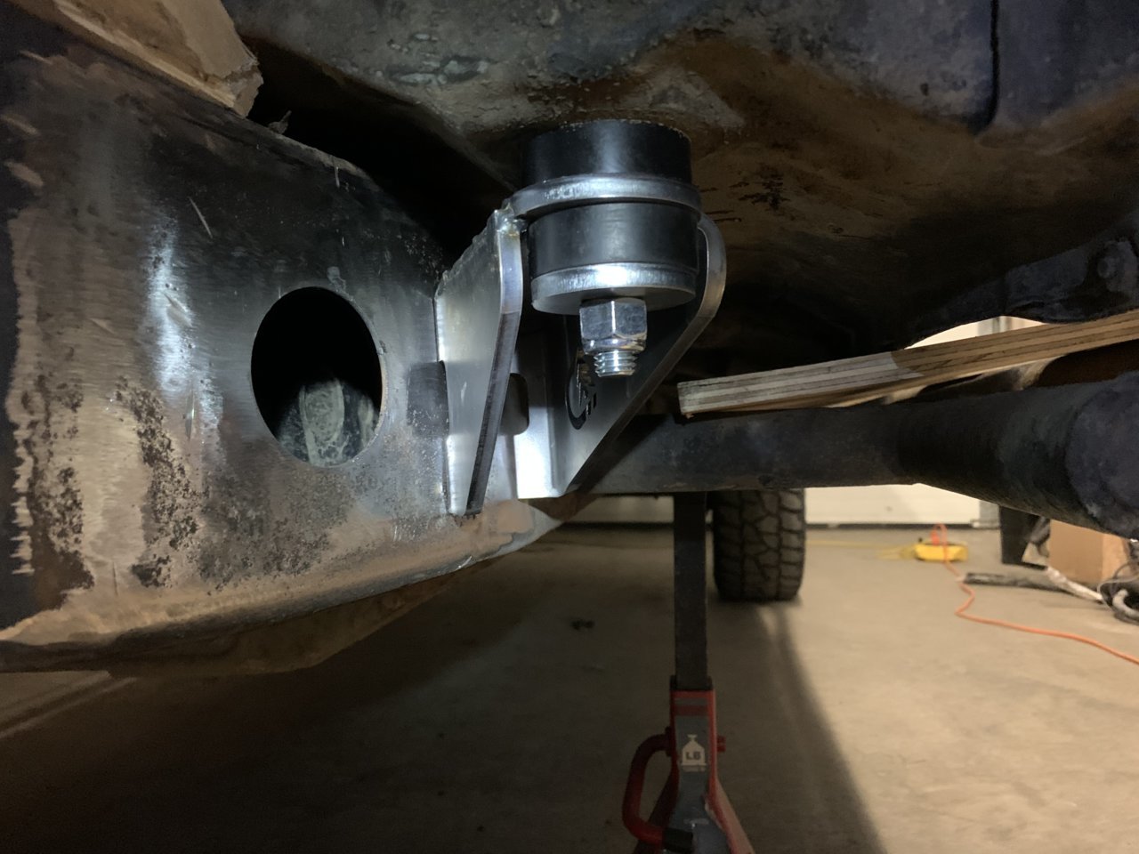

    Got one on last night. SUPER impressed with these! Beefy and makes for a much cleaner look vs to usual chop shop look.

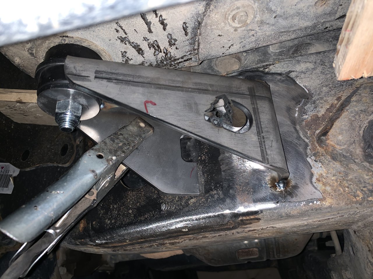

    Did you self install?
    since these are custom fab I doubt any shop would know how to help install?
  19. May 17, 2020 at 6:24 AM
    #219
    literallynothing
    literallynothing I tow my new truck around with my old truck
    Aug 27, 2017
    #228243
    2,156
    Noah
    2017 DCSB
    Steel and 37s
    Literally just cut the old mount off and use the bolt to locate where the new one gets welded on. Any shop could do that
