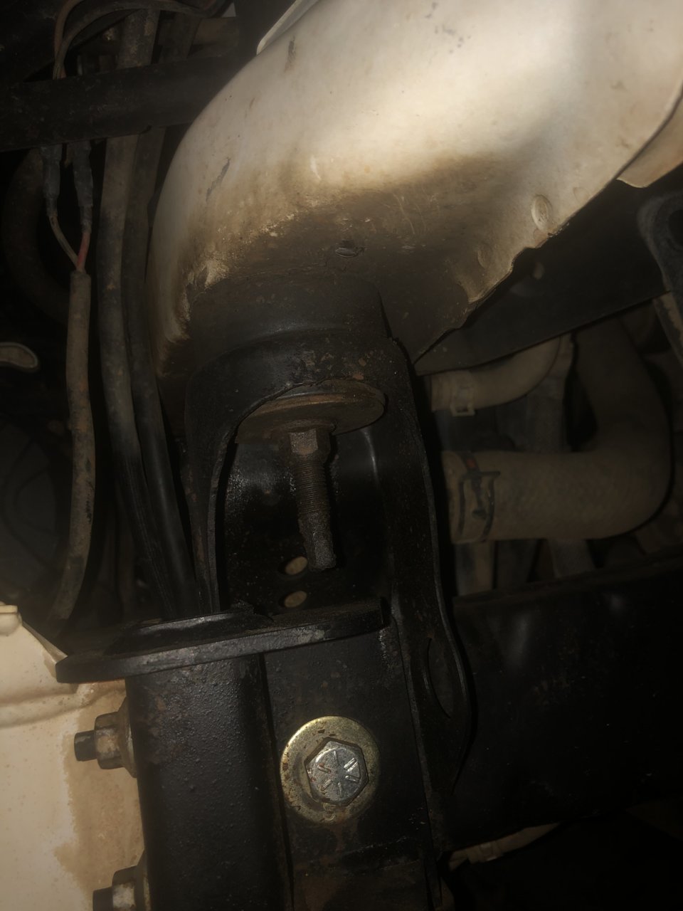

    I have this too. I started investigating and the bushings are the wrong durometer I think. Also, not sure if they compressed or what but the cab is now touching the frame... which I think is contributing to my squeak noise at low speeds. I tried to get some pics
    My local shop has already had to redo a few of these. They use energy suspension bushings and highly suggest them. So I am going to try swapping mine out. Does anyone have the diameter/height of the alpine bushings in the kit?? Thanks!

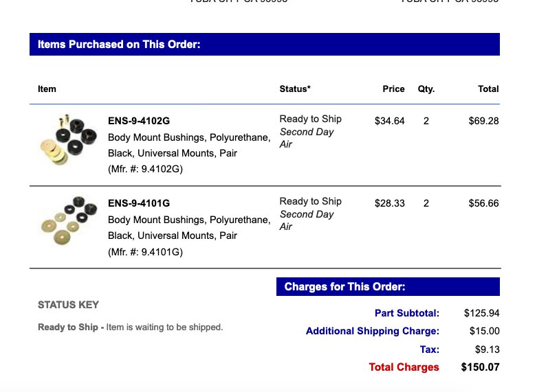

    I am not 100% sure these will work, so I purchased 2 different sizes. I will update once they get here. But these are the 2 kits I got:

    Just an update, swapped out the body mount bushings. Wow what a difference. Truck doesn't squeak, rattle, or clunk like it did before. I ended up using the smaller Energy Bushing as it was almost a perfect fit. I had to drill the Alpine Body mount hole out a little larger for the new sleeve. The Energy Is 4MM taller which was just enough to get the cab high enough to not touch the frame. We will see how long it lasts. I feel more confident in this material(seems like a harder durometer) in addition to the metal sleeve that goes down the center.
