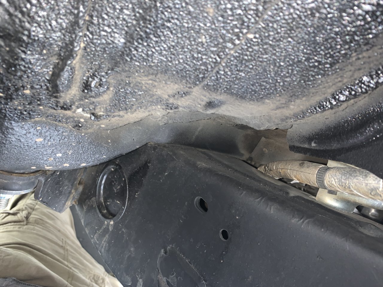

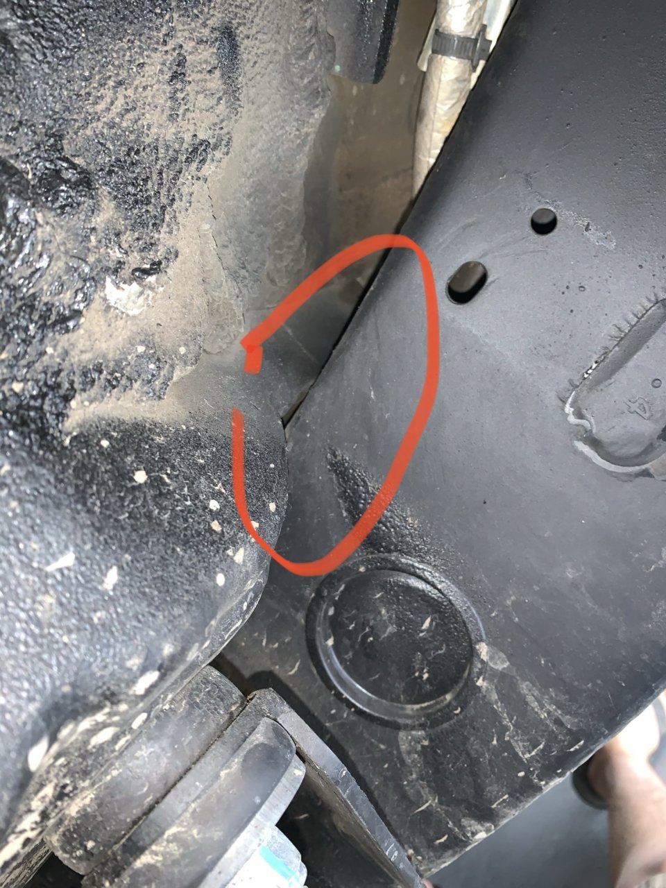

    No problem, just hope to save someone else the troubleshooting in case this happens to them. I guess you could weld the entire mount higher up to compensate, but I would still swap out the bushings 100%.

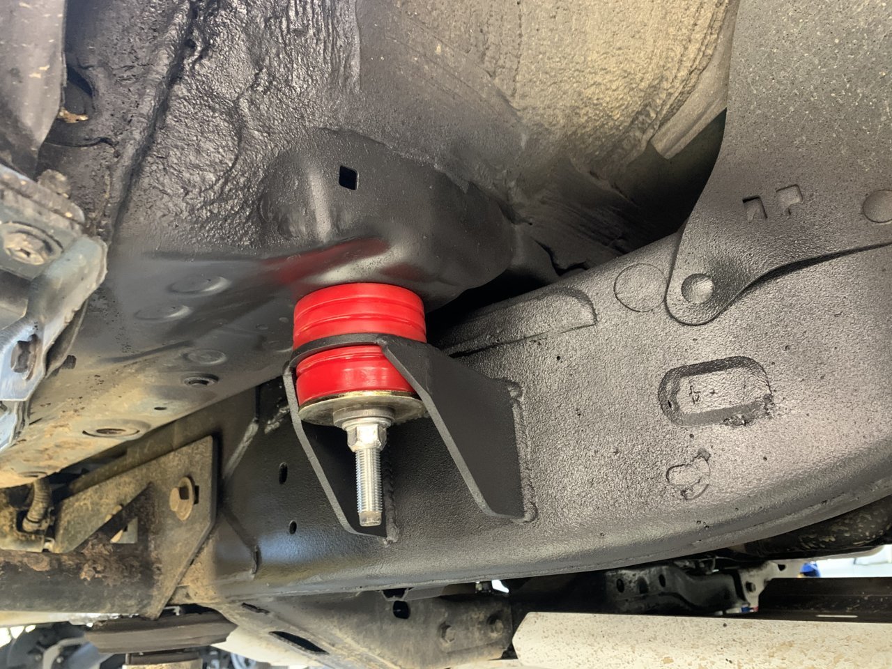

    9-4101
    Still running solid and no noise:)

    Not at all trying to question your install skills but how sure are you this wasn't due to improper installation? i.e. placing a jack on the body and making sure the body was the same distance from the frame as stock during installation? Did the clearance change over time or was it slightly smaller immediately after install?

    I have runnin4tacos version of this and have been battling the low speed creaks. They redid their kit with a nylon nut so he sent me new hardware with new bushings. I used some silicone grease on them this time. I don’t think my body is hitting the frame, but I know these bushings are 16mm thick like alpine. Don’t know the durometer though. Might be looking into these energy bushings.

    After the 9-4101 bushings, do you reuse the factory body bolt, or the new bolts provided??
    How much play is between the 9-4101 brass collar and the bolt?? Thanks in advance. Just asking before I throw this on.

    Can't go wrong. You now have the ultimate kit. The bushings fit like a glove, and shouldn't have any wobble. Now all I need is someone to weld it up. Been with this kit fir over a year now...
