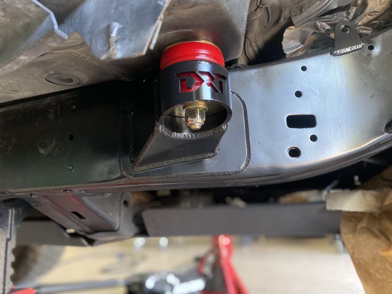

    Derik
    Our CMR kit utilizes a 3/16 frame overlay plate to disperse the load and prevent stress cracks unlike other kits on the market. The cab mount itself is built from laser cut 3/16 and 1/4 plate as well as a laser cut .188 DOM tube that encases supplied energy suspension cab mount bushings. Check us out on Instagram ! @drtfabrication
    The only fully boxed cab mount relocation kit available on the market also making it the strongest.

    My CMR kit is designed from an oem frame file to ensure a perfect fitment. Check out my IG for some more photos @drtfabrication . Feel free to send me a message if you have any questions

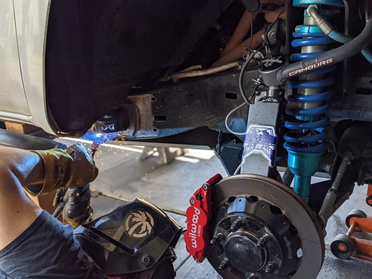

    When I went 35s, I decided to go with DRT because Beef and he's local. So far so good with some abuse already thrown at them. Cut 2.5" from fenders, relocated cab mount, lots of hammering, etc.
