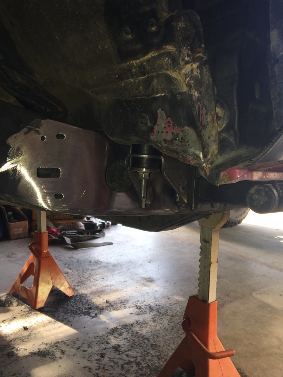

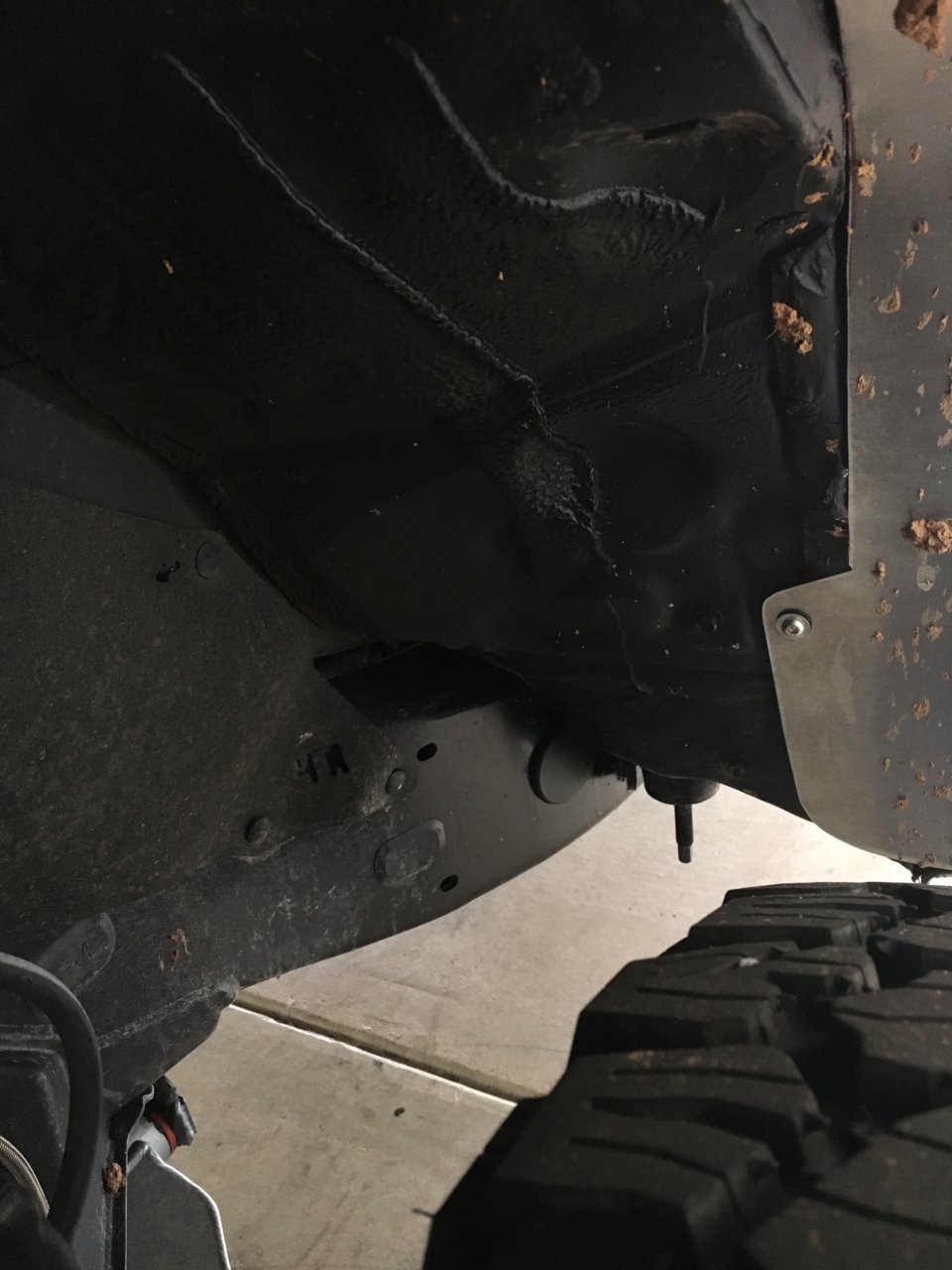

    Installed one of these kits this weekend and works great. I would highly recommend. 37's no longer hit the cab mount, just everything else.:D

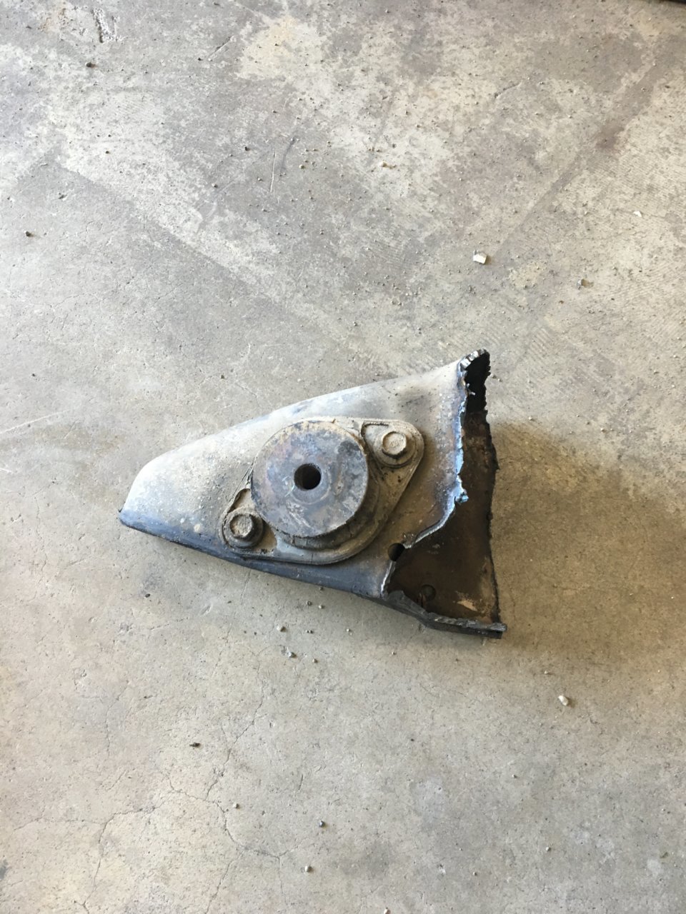

    Pic doesn’t really look any different than the OPs. Install was pretty straight forward. Definitely want to support the cab before cutting the old mount off. I drove some wooden wedges between the frame and the cab until the factory bushing became loose, then cut away.
