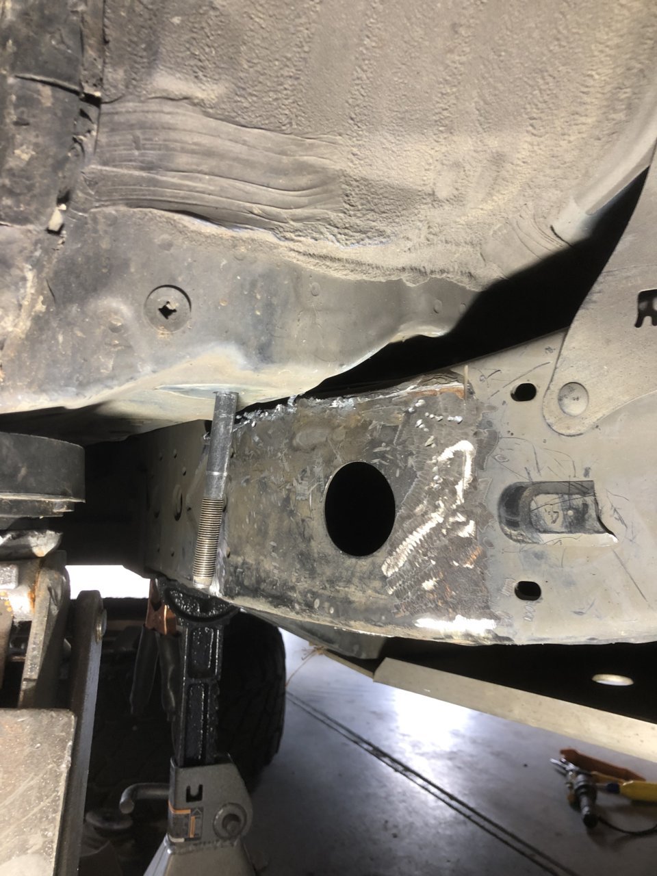

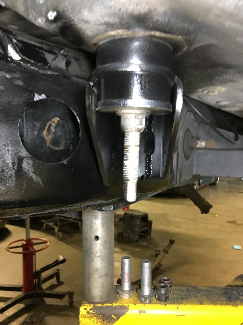

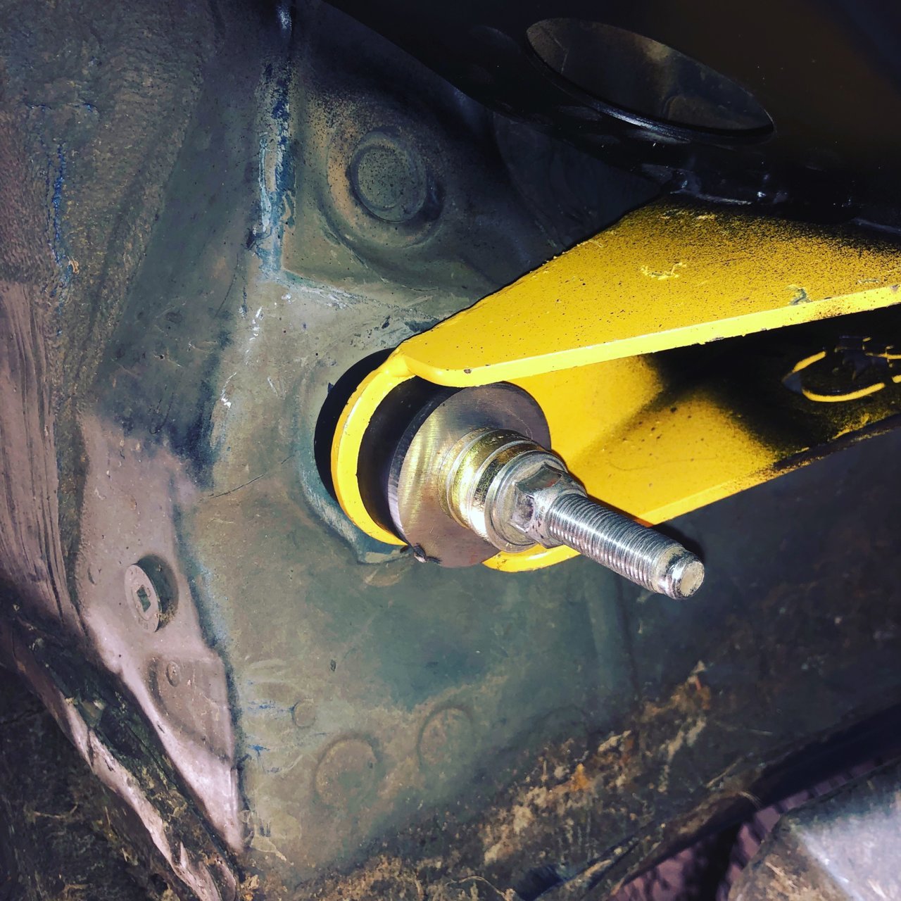

    For any 3rd gen guys interested in the kit: the bushings are not the right size for the stock bolt on our trucks. The bolt is not threaded enough to work with the bushings in this kit, so I had to add a bunch of washers that will be there until I get either metal spacers or another bushingE8B08521-D6BC-48CB-AE29-6EFDD89D7A3C.jpg

    201
    2016 Tacoma Blue
    I had to do the same thing. I just added another bushing so now I am down to 1 1/8 inch washer only and double stacked the bushing on the bottom. Worked great and I think I have less harshness now as well.

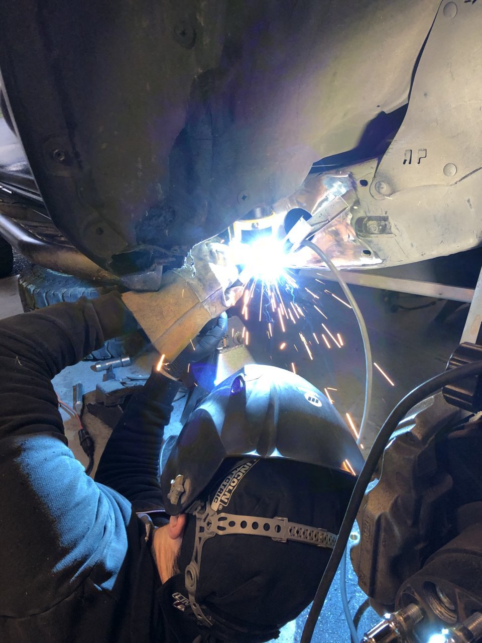

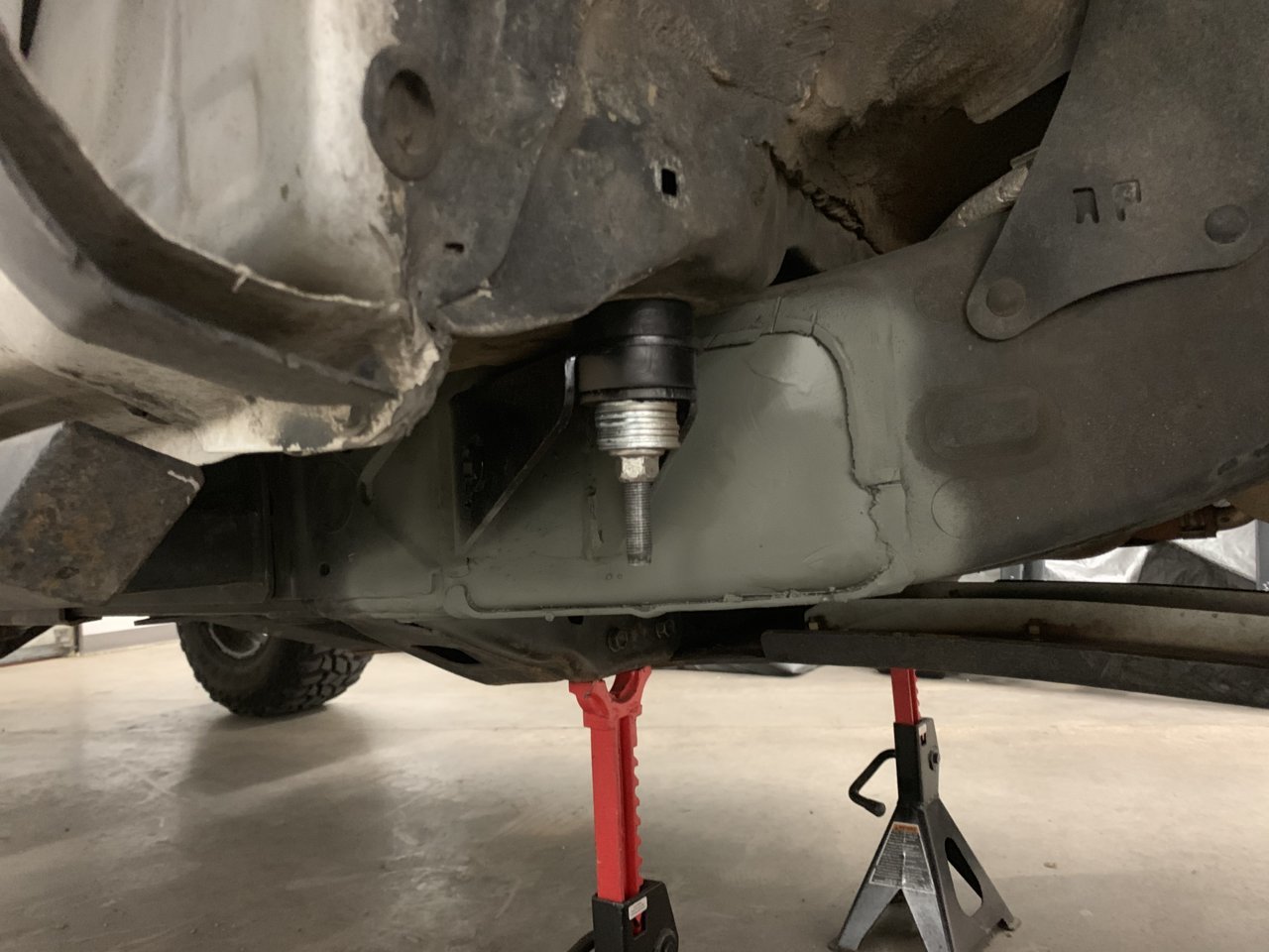

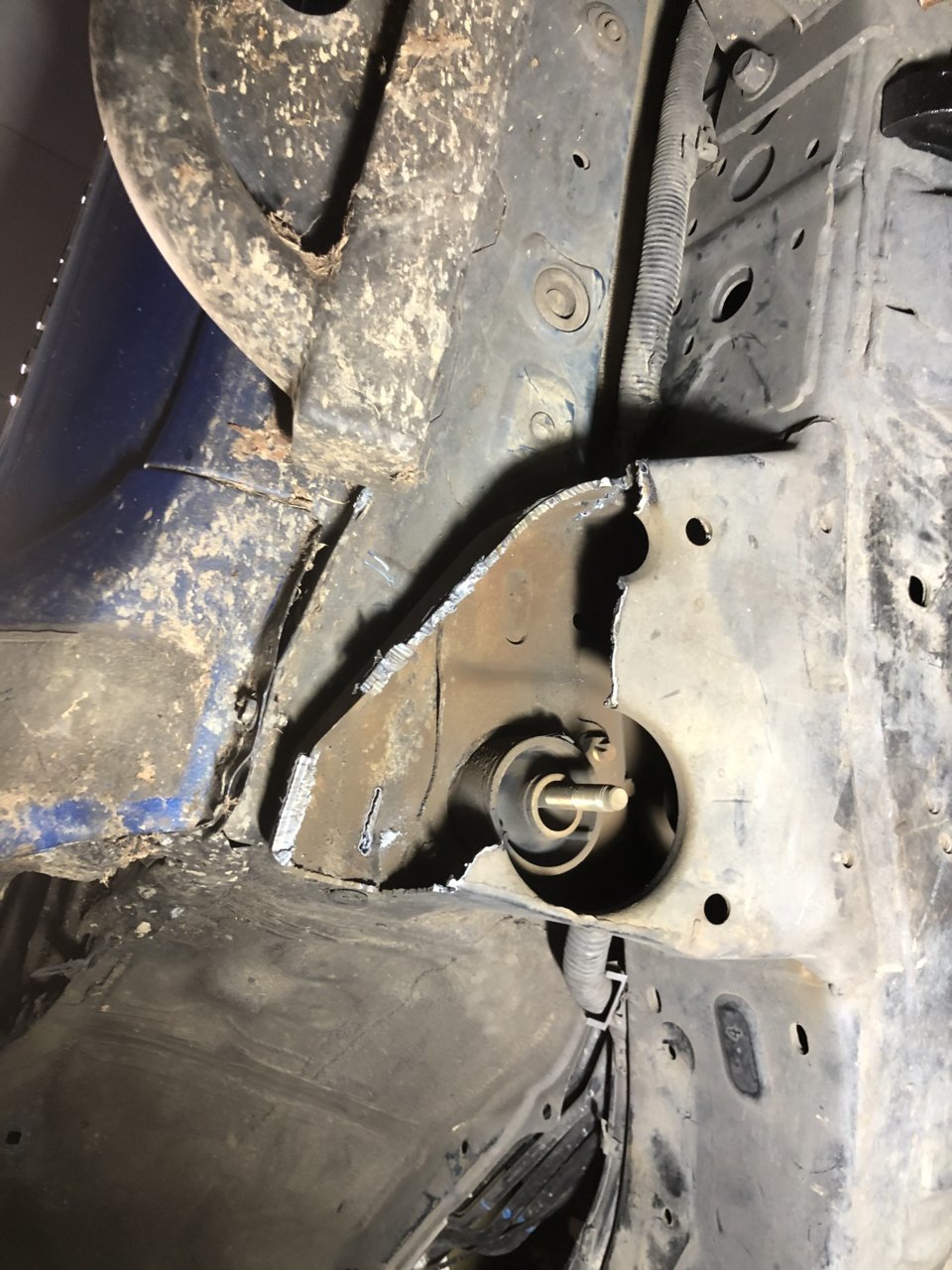

    I got this welded up this week. I gained a ton of clearance over what I had.
