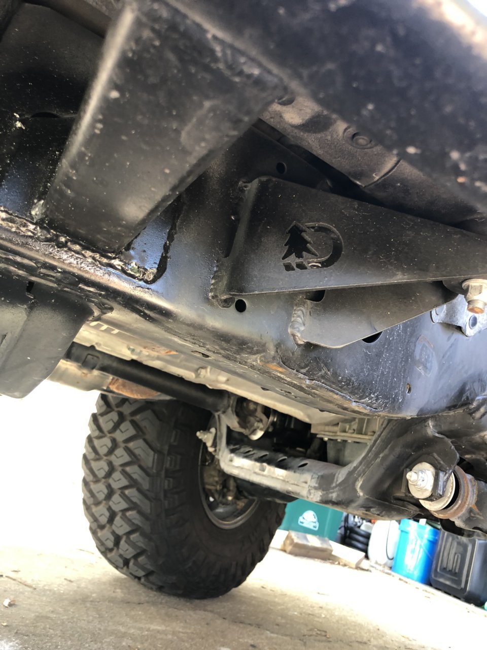

    Any pics installed @FlyinRyan893 - also kind of wondering if my BAMF bolt on sliders will be interfering any....

  15. May 20, 2019 at 2:31 PM

    Pretty straightforward install?

    Yea. Put a jack under the body to support it. Unbolt the cab from the mount. Cut and grind away the stock mount. Bolt up the new one. Weld. Paint. Took me probably 2 hours per side. Probably can be done quicker but I don’t work very fast.

    Did you leave the tires on and truck on the ground ?

    Noice, that's what I had planned. Looks good, thanks man

    I don’t remember for sure. I think I put the truck on jack stands and pulled the wheels to have easier access.

    Makes sense. I was just curious if you needed to have the truck at the exact normal ride height so that the body mounts didn't end up higher or lower than that stock positioning.
