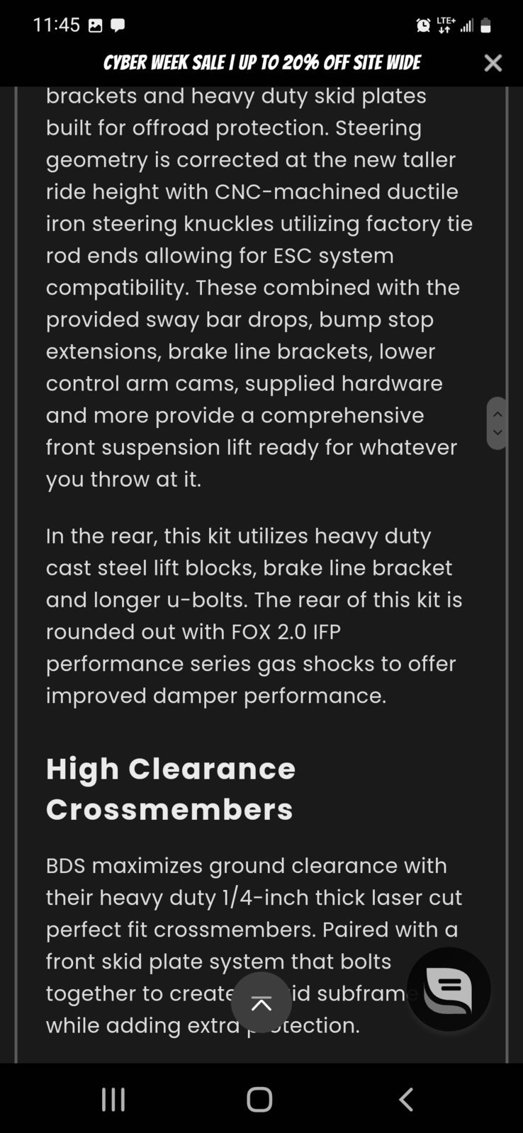

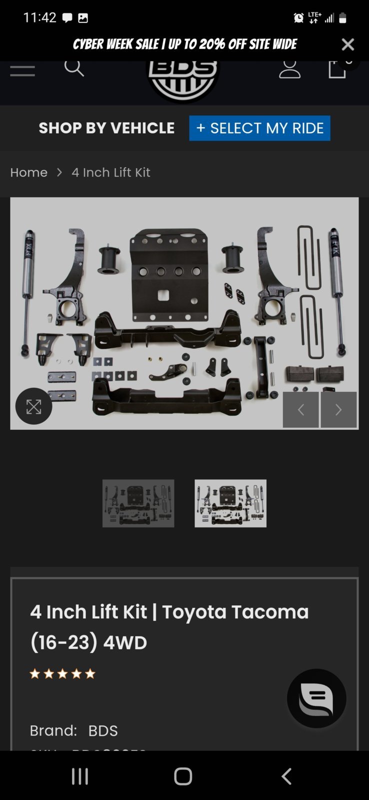

    Do show me where these front shocks are?
    No mention for specified front shock options I'm not trying to be a dick I'm just trying to make sure it's pointed out clearly so your not suprised
    Bishop84 likes this.

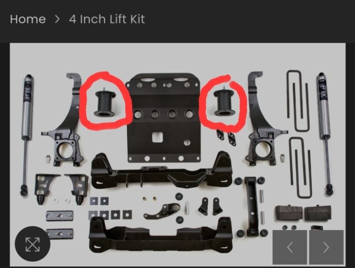

    FYI OP, @Veet-88 is correct in the fact that front coilovers are not included in this kit. Only rear shocks. The front will utilize spacers hence why I said down the road you can get full length coilovers. If you want to keep everything fox the part# is 883-02-048
    Circled in red is what is giving you lift up front
