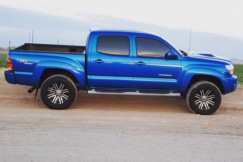

    Well, after lusting for a Tacoma for about 7 years-I just bought my first truck since graduating college, which is a blue 2008 Tacoma, 6 speed, 4x4...and I'm in love!
    I have a couple questions, since I bought it used-there's some things I would like an opinion on.
    I need a toolbox to store some things in-because I'm an Ag Teacher/FFA Advisor I have random stuff come up all the time with my kids and their animals, and I have a variety of things I need in my truck at all times. Plus, I'm a woman so I'm trying to keep all my things organized in it :)
    I would like a black, low profile toolbox without selling my soul to afford it. I need to throw things like the basics for the truck (extra oil, water, jack etc.) but then items like rubber hose to pump calf stomachs with, a change of boots and muck boots, ratchet straps, chain, some other misc tools... Anyone have suggestions?
    Also, I have a belt that is chirping (I'm assuming it's my serpentine belt?)-when it's idiling, when it's under about 2,000 RPMs and the windows are down you can really hear it -but stops when I have the clutch pressed in, either to the floor or just an inch or so. It didn't do it when I bought is a few weeks ago, so I'm wondering if they put dressing on it so it stopped temporarily. What's the best thing to do?
