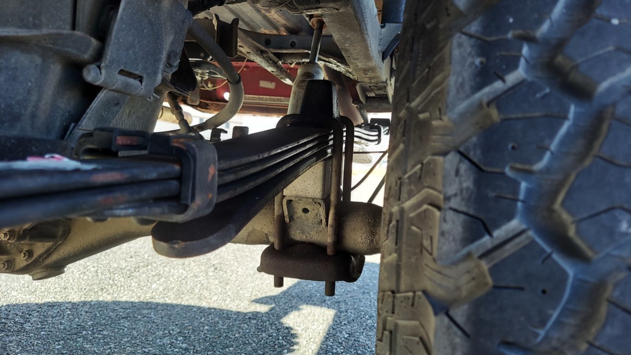

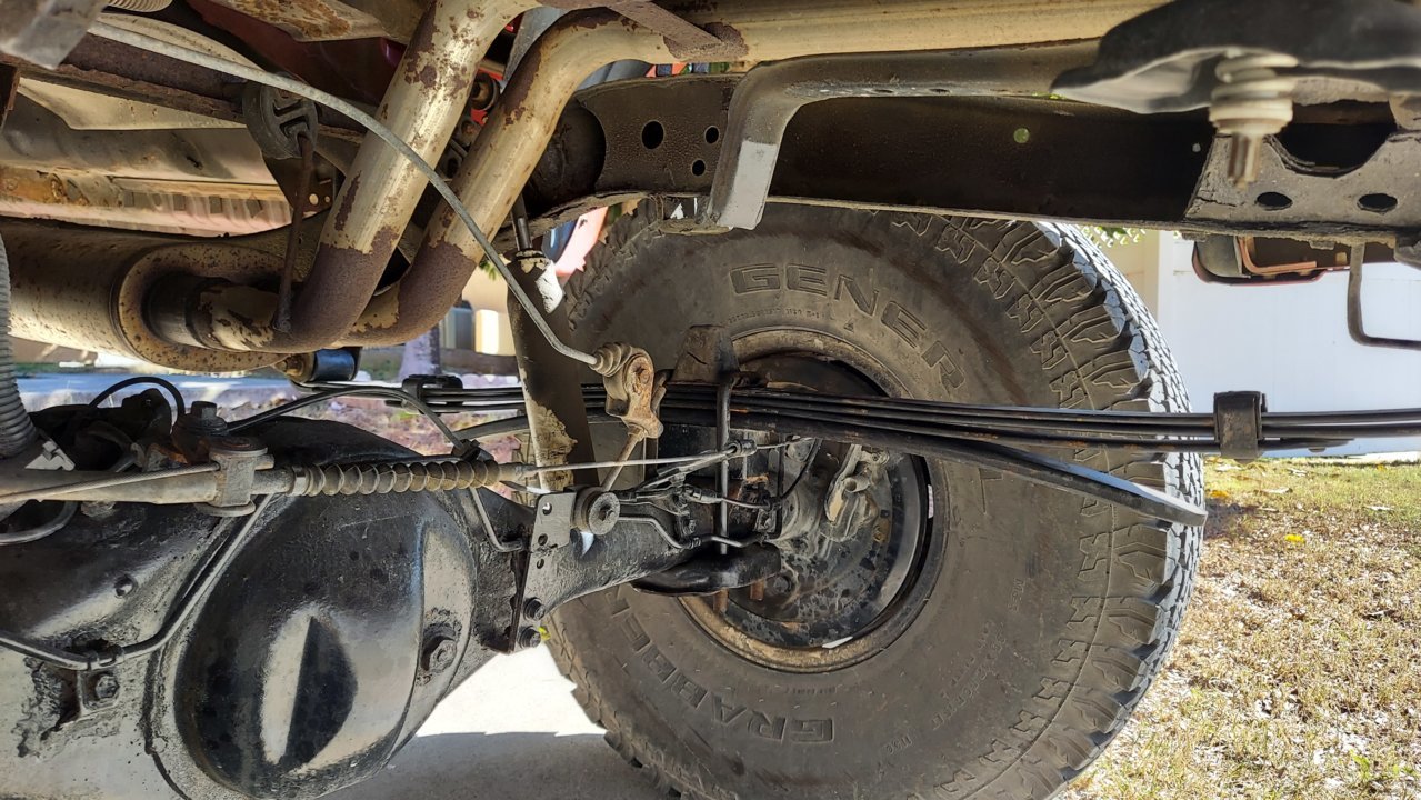

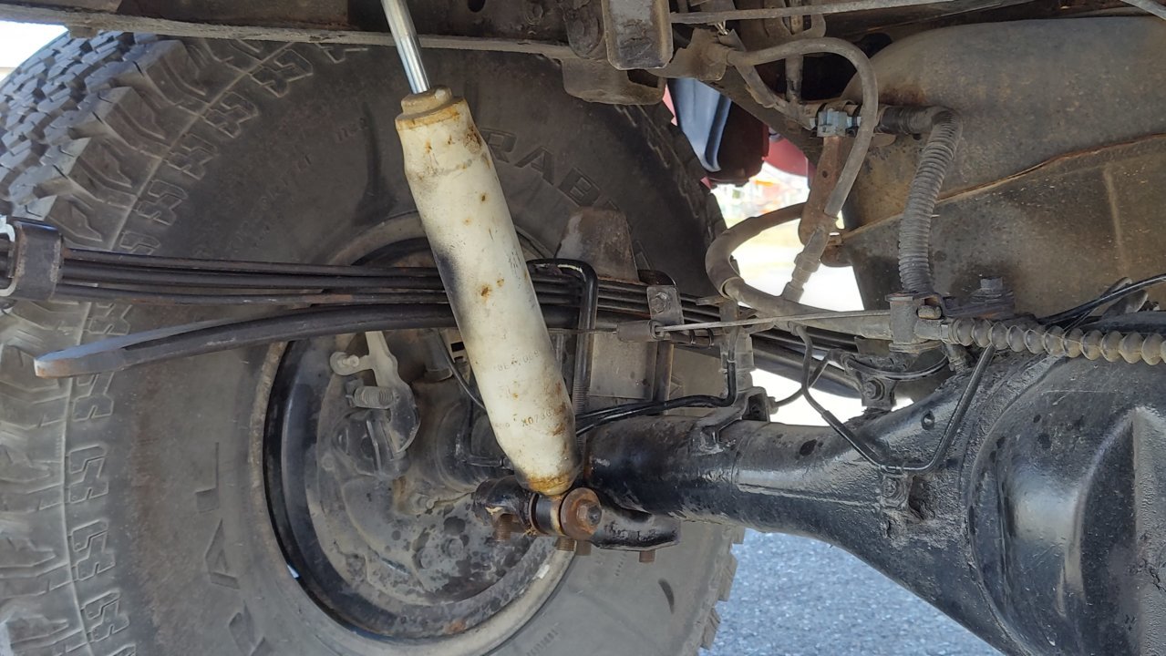

    Just had my rear leafs replaced and they are frowning. I am not referring to the overload leaf spring on the bottom of the leaf pack. The leaf springs above the bottom overload spring are bowed/arched. Please see pics below. Is this normal for new springs?

    Where did those springs come from? They shouldn't be bent backwards. They look used with fresh paint.

    Definitely not normal. New as in replaced within a few months or a year? Where did you source the spring?

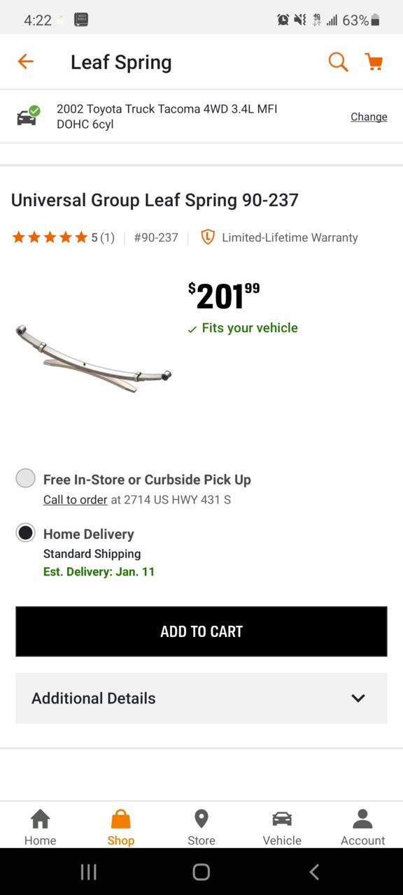

    I see you opted for the "Universal Group" leaf springs....I suspect those are utter shit. General Spring or OEM for factory replacement, otherwise, get lift springs.
    Mark77 likes this.

    You get what you pay for; those are cheap.
    Get rid of them.
    Also, your shocks are due for replacing.

    My brand new SDs looked like that. Idk how much arch is normal but it appears close to zero

    It sure looks like the springs bent right around those blocks !!
    The weight of the truck is pounding the springs on the block at every bounce .
    You might have the same issue no matter what springs you go to.
    Given enough times both springs will break.

    According to the OP, these pictures were taken the same day the springs were installed, so we are not observing any wear to speak of, unless the springs are used. It is true that blocks worsen axle wrap (blocks increase the torque or "leverage" that the axle can exert on the springs), but the laws of physics, as you have invoked, can NOT explain how blocks have inverted the spring arch when the truck is motionless, compared to the springs just sitting on the axle housing: lift blocks are unable to increase gravitational force. @Duckinatruck is correct on this count...think about it.

    The block supports the spring no differently than the axle housing. The axle housing would therefore "pound the springs" just as much as the blocks. Using the same springs, OP would have this issue with or without blocks. Let's also not forget that these were installed the same day the pictures were taken.

    If I were leaf springs, and had shocks from the 1930s to dampen me, I'd be frowning too.

    So lets imagine the three points of contact for these leaf springs: Point A is the static (front) hanger, Point B is the axle housing, and Point C is the shackle (rear) hanger. At rest points A and C are static and are meant to sit slightly above point B, giving the leafs a slightly curved arch. Now you go in and jack point B up by 4" with a block; points A and C have not moved but now point B is far higher relative to their position and the leafs are now inverted. Maybe more like geometry.
