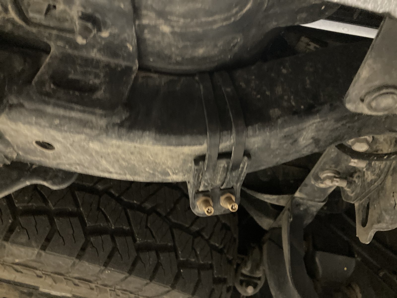

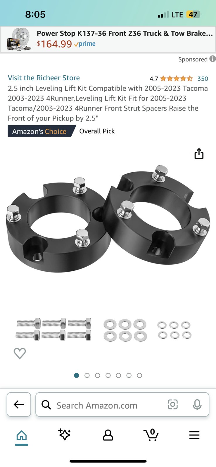

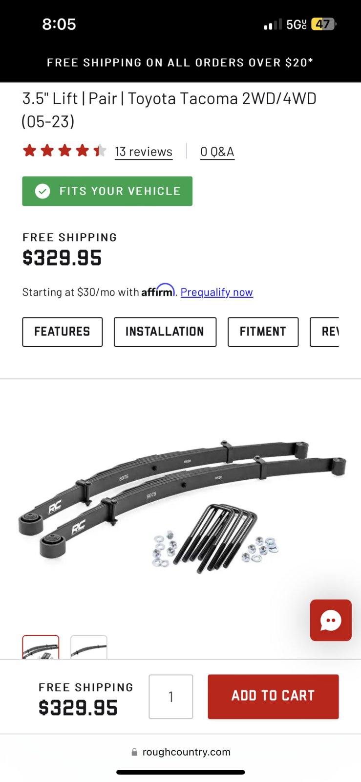

    Could I do it with these. The leaf springs and then the lift kit in the front. Or would that not work or would I need a smaller lift from the leaf springs?

    From what I'm gathering it sounds like you need higher capacity rather than a lift. I would avoid a front lift if possible if your aiming to do this in a budget friendly manner.
    Depending on how hard you are on your truck you can get away with front spacers but you do risk bending the shock leg as your new bottom out point becomes the shock not the bump stop.
    I would consider just running a leaf pack to start with. Look the direction of OME they promote a lower lift than the RC.

    Do yourself a favor and don't buy the cheapest stuff you can. Also don't use spacers for a 2.5" lift, that's a good way to bottom out your shocks when you git a bump.
    How much does the tent weigh? If you don't want to do the research yourself, you should call one of the shops / vendors on here and see what they recommend for your setup. My money is on a new leaf pack and new springs up front, with appropriate matching shocks as the best option. I have no experience with them, but OME is one example that offers a higher spring rate and lift for heavier loads.

    Spacers and blocks are the worst.

    It’d be helpful to know what your tent weighs. You certainly don’t need to install leaf springs that give you 3.5” of lift. And do not install 2.5” front spacers, you’re getting yourself into aftermarket UCA territory and, spacers are crap.
    Just call Wheeler’s if you’re not going to do all the upfront research you need to do, tell them what you have and what you’re trying to do, and let them guide you with some choices. After that you can come back and ask for some input.

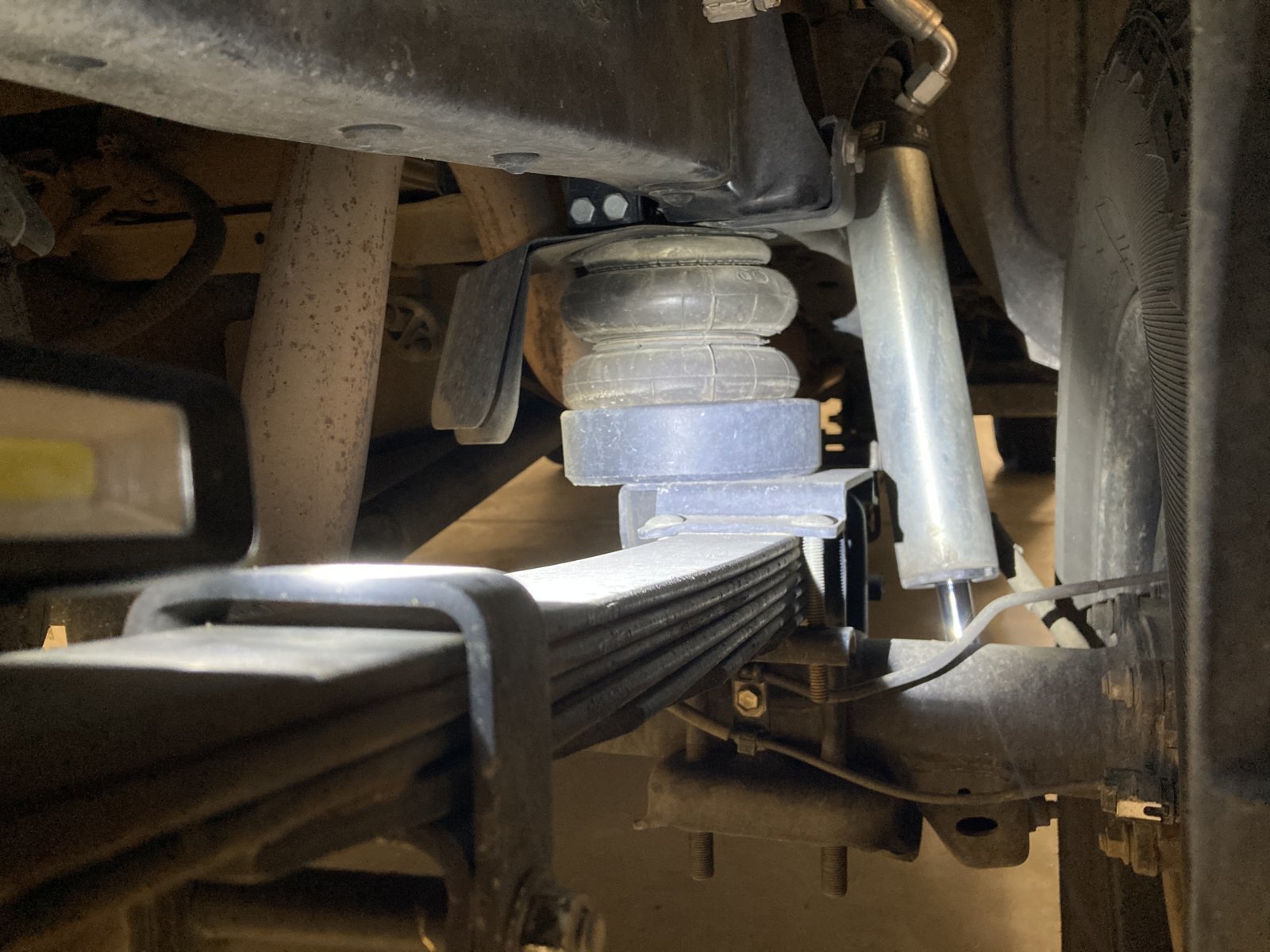

    Airbags? May save the lid of your leafs for what you need.
    Add the Daystar cradles and you are cherry for any use. You can even mount the air nips where you want and use a hand held bike pump. $400 I think is what I paid total
    you can always air down to 5 psi which is like 3-5 pumps with a hand pump. This allows max articulation

    Bags can work well as long as you don't plan on wheeling your truck much. Just like extended bumps they can reduce up travel limiting rear flex

    The internal bumps don’t prevent that much in my extended travel setup. When I run desert roads it can actually smooth out the ride, but my shock never compresses more than 1” from no rod showing. The cradles are a must for offroading…keeps articulation at speed. Rock crawling may be a different story…I don’t do much of that
