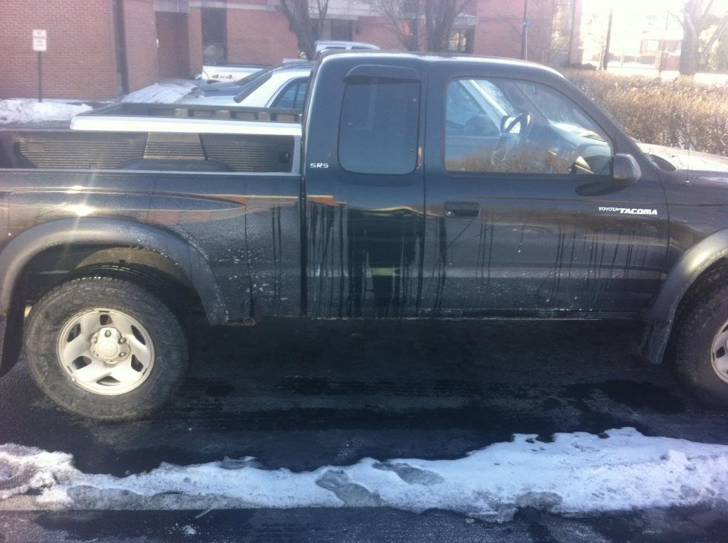

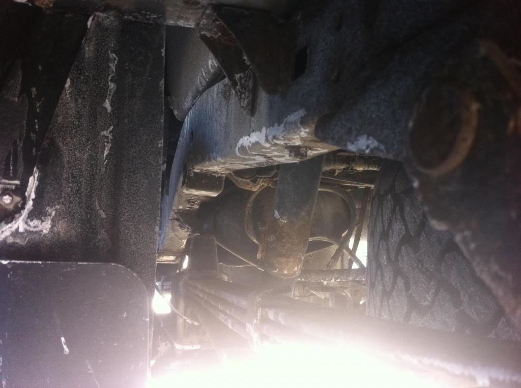

    Ok so this is what it looks like. It is bending where the leaf is attached the rear axle. I'm not an expert with this sort of thing, but I know that is not the way it should look. Sorry about the glare on the first picture I was in rush to snap a pic before I had class
    also the truck is level and no noticeable sagging in the back
