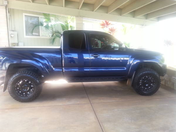

  11. May 30, 2014 at 9:00 AM
    zboy
    zboy Well-Known Member
    Jan 26, 2013
    #96197
    586
    Oahu808
    12 TRD OR
    Take a look front 2.50 Rear 1.50[​IMG]
